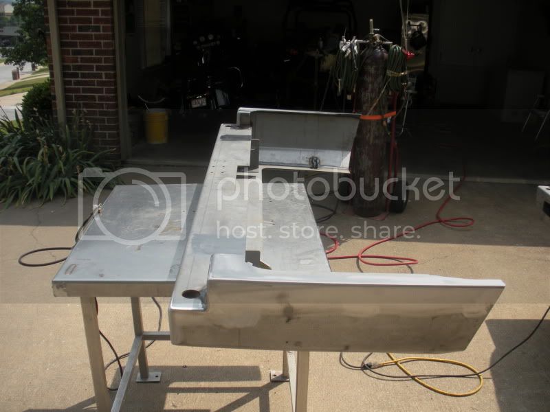

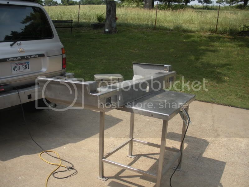

Rear bumper design/build
Awesome job! Is that stainless and are all bumpers going to be stainless?
The material is cold rolled steel. No stainless, BUT.... if someone wants (to pay for) a stainless version, we can make that happen. ;)
The hardware for the bumpers WILL be stainless.
Forthcoming.
Has a finished weight been calculated, sans swingouts?
Main bumper assembly weighs 160lbs.
Add the swing-outs (cooler rack, tire carrier..yada yada..) and you're looking at about 280lbs.
She's not a lightweight!

Someone turned the StainlessDoctor loose with a flap wheel!

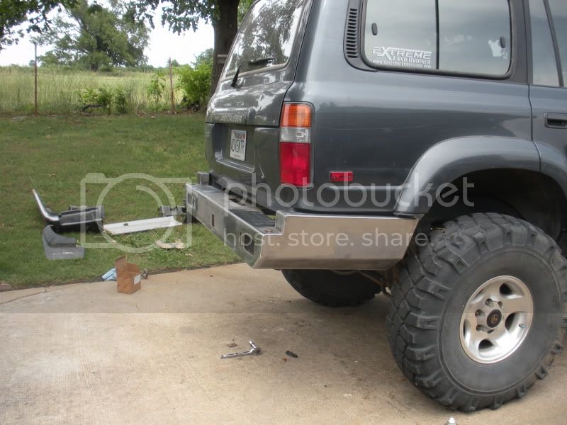

The bumper you see here is the one that will fit FLARELESS landcruisers only. I'll make someone a heck of a deal if they want it!
Look for fitment pics of both bumpers on my landcruiser, tomorrow.

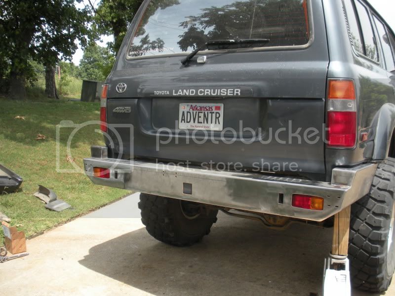

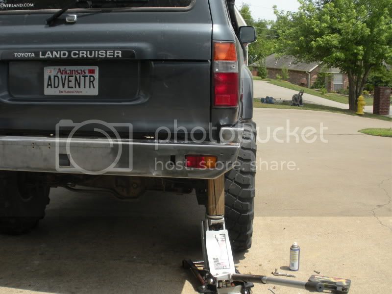

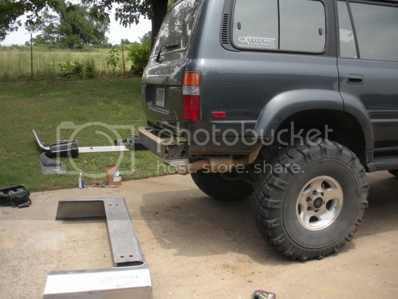

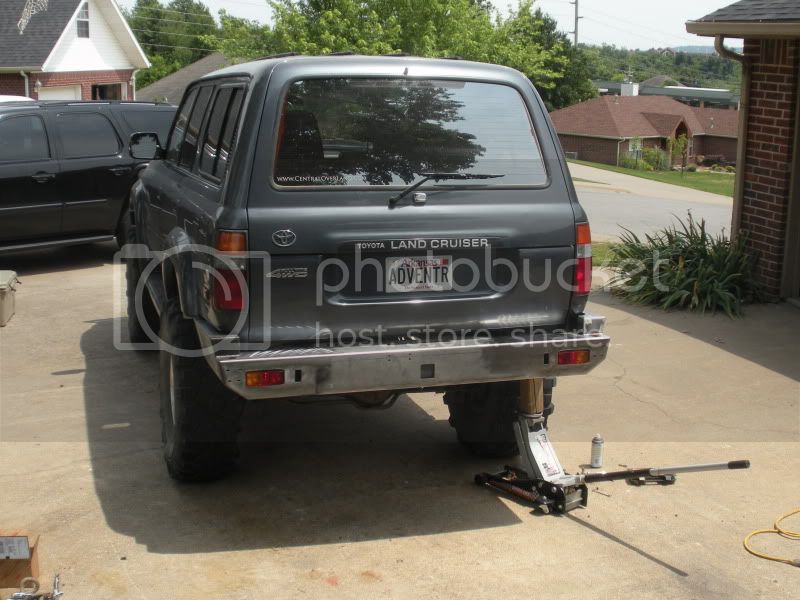

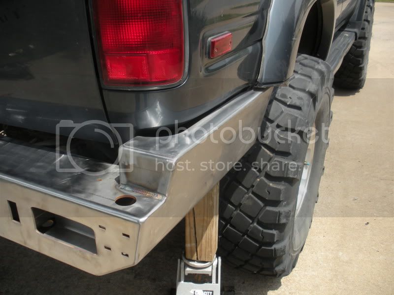

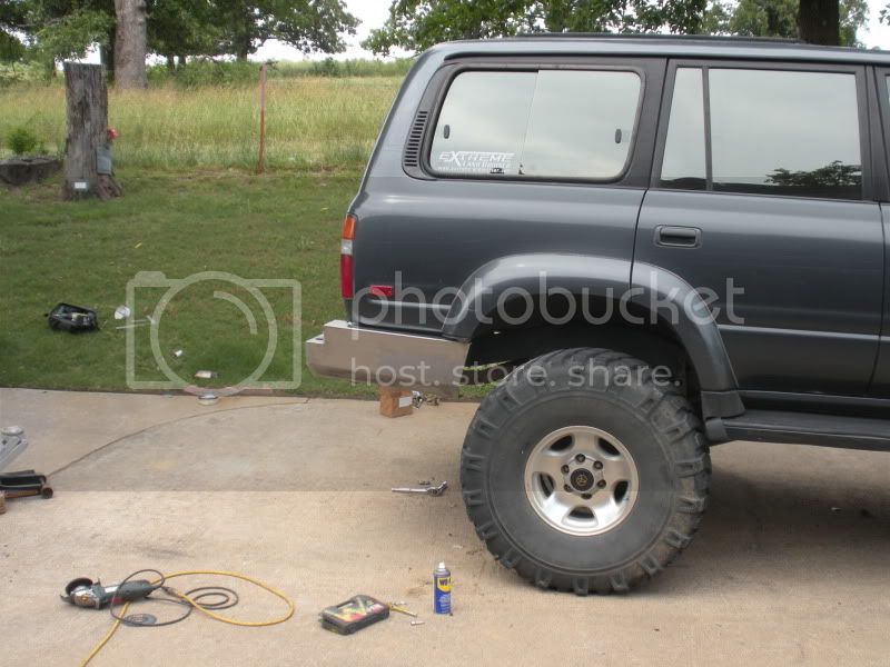

Here are some fitment pics of the FLARELESS bumper on my cruiser. Keep in mind, that on a rig with no fender flares, it will sit level. My flares were keeping the front end of it pointing down a few degrees.
I already have a couple people on the waiting list for this one, but I'll let it go as pictured for... SOLD.
This shows it with the tail lamps only sitting in place:

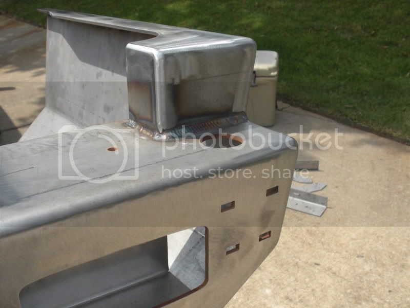

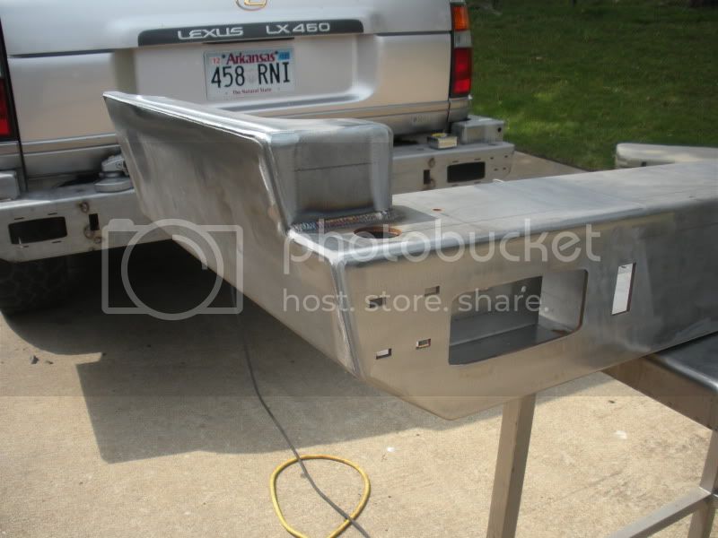

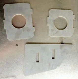

Looks like you've had a busy weekend! What the four notches outside the Hella lights for? I didn't see them used in your renderings.
Those are actually tab cutouts for the internal spindle gussets that get added when the spindle is welded in. The gussets will completely box in the area around the spindles, and will weld directly to the spindles as well. This will make the entire assembly extremely strong, and will eliminate and flex/fatigue in the spindle.
I like to tab everything so that it all fits together like a puzzle, and everything self-aligns.

Nice! Are you machining the spindles, bearings, etc. or using a pre-existing solution?
The spindle is a pre-existing solution. It wouldn't be worth my time to re-invent that wheel since there are already excellent options out there.
The chosen spindle set is machined from chromoly steel, and is complete with sealed bearings. It's stout, to say the least.

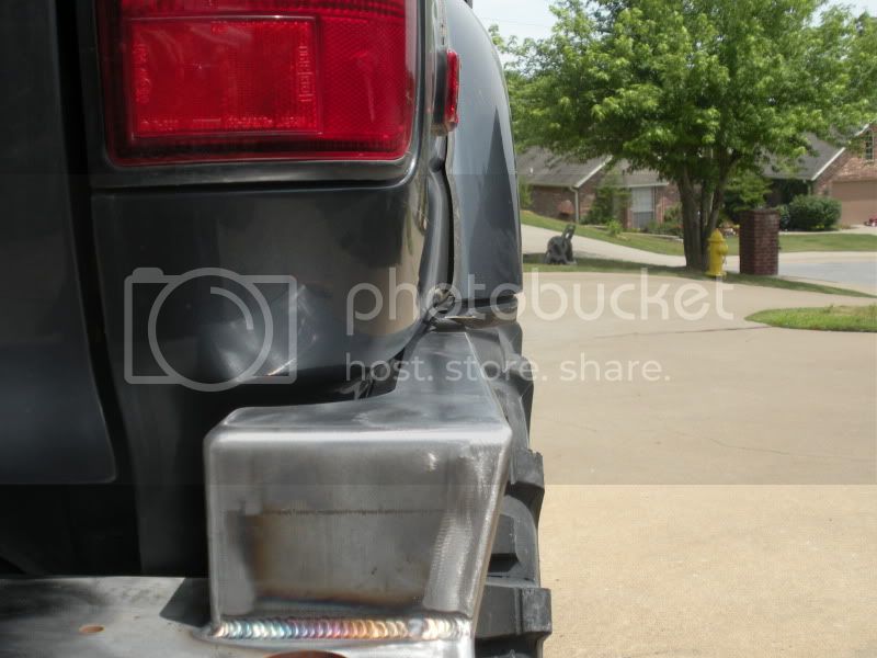

Over the past 20 years I have used many different products including this one, they do work fairly well to remove a fillet weld....BUT on this detail I decided to just Leave the fillet welds as its all TIG welded and smooth.
Let me guess- you make medical carts or food prep surfaces for a living? :D
Nice welds, leave 'em be!

I primarily work in the food, dairy and beverage industry and I'm a pipe welder/pipe fitter by trade But we do it ALL. Full fab shop, water jet, CNC press brake, CNC roll etc, etc.....I just build custom stuff on the side.
