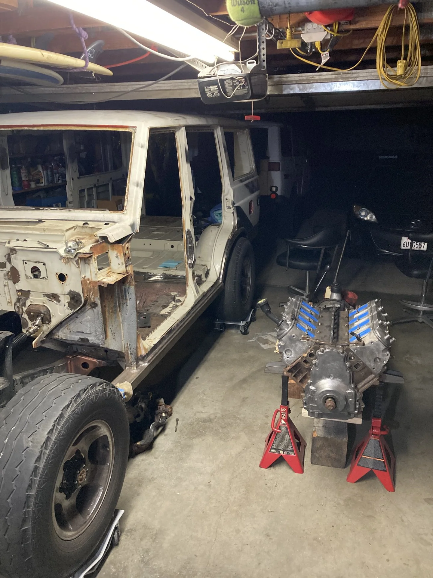

Man! I can’t believe I have an engine inthe garage!!
Yep, I have missed out on a few things over the years, so I do the same. I have a 38mm split-case that has been in the garage >10 years (even moved it once), just waiting for that H55F!...

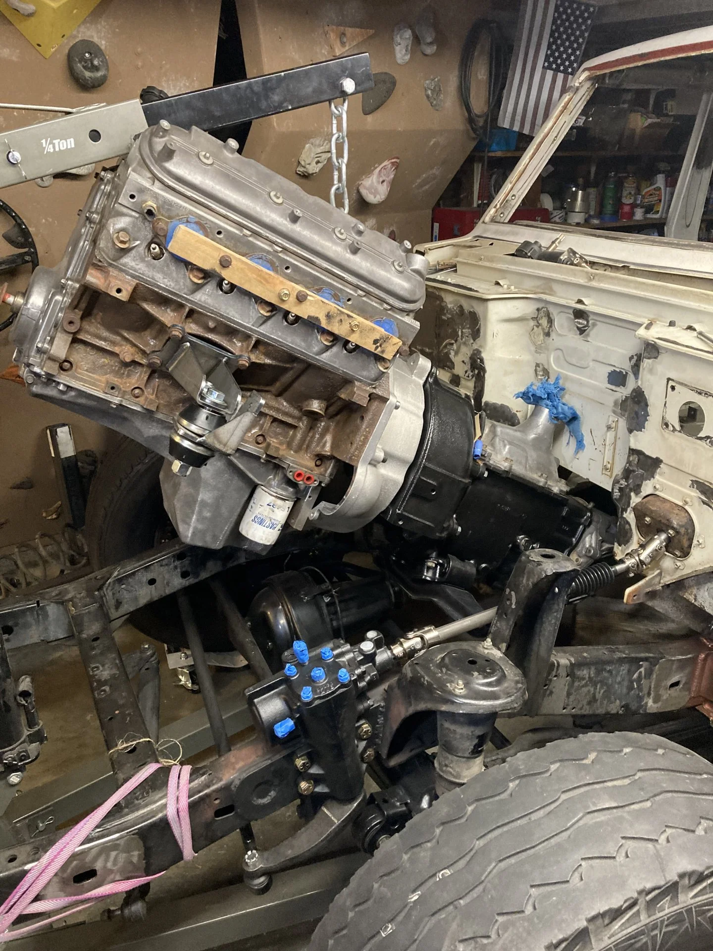

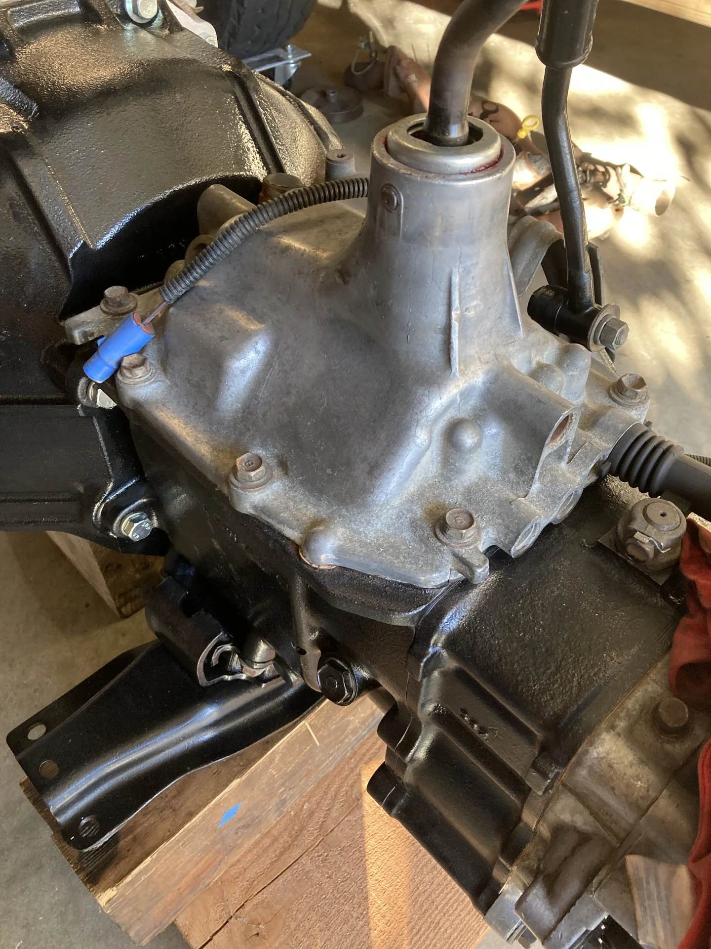

So this is on the bump stops. Do know I will be having a 2-3” lift.

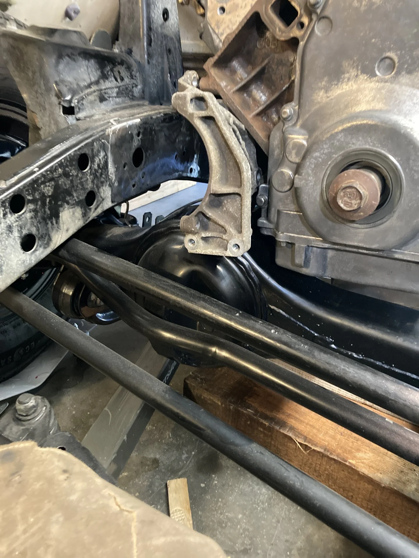

Still gotta move this thing around a bit. As it sits - AC compressor hits the pumpkin, oil pan doesn’t clear the tie rod, and seems to be hitting in the trans tunnel.
Way stoked to see it in this spot in my garage!!!
Others who have actually stuffed a V8 in will chime in, but I think you need to clear the suspension whole on the bump stops or your asking for trouble.
I do think there are a ton of different accessory mounts out there for LS which would move the AC outta the way?
Got some research to do!
If I had to do it over I would have cut the firewall and move the engine up two inches, wouldn't take much to make your life better and all that sheet metal is fast and easy to remake compared to moving suspension around not to mention a lower station wagon is better off road.
That was the direction I was thinking. Gonna do a little trimming on the firewall, cut and move the rear end of the trans tunnel aft, and see if I have learned anything with some metal fabbing! Goal is to make it look like I didn't do anything to the area, right?! I'm up for the challenge!
