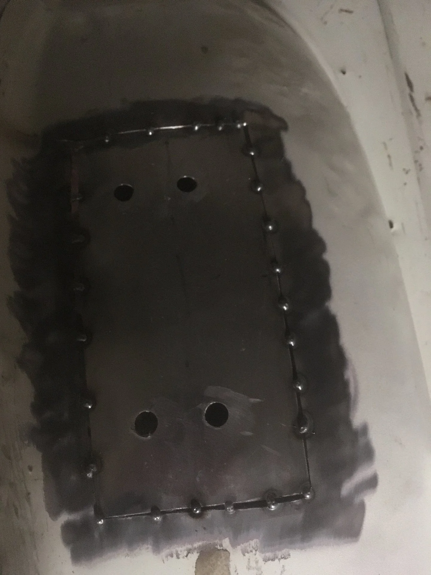

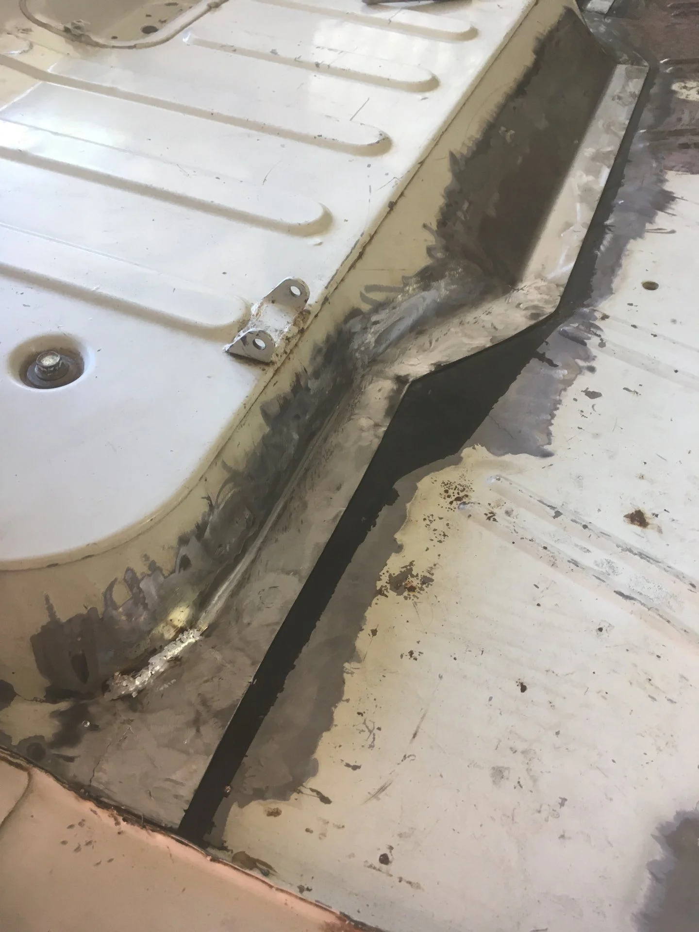

So this is goning to have dynamat and then Linex on top and all I can think about is going wheeling and all the spot, butt, and other welds poping and breaking! I hope not!!!
Doubt you’ll get extreme enough to worry about it. Welds are usually pretty strong, more often than not, it’s the metal beside a weld that will crack because of the heat. But if you’re doing it right, you’re not creating as much heat as you would if you were just laying beads. Should be fine.

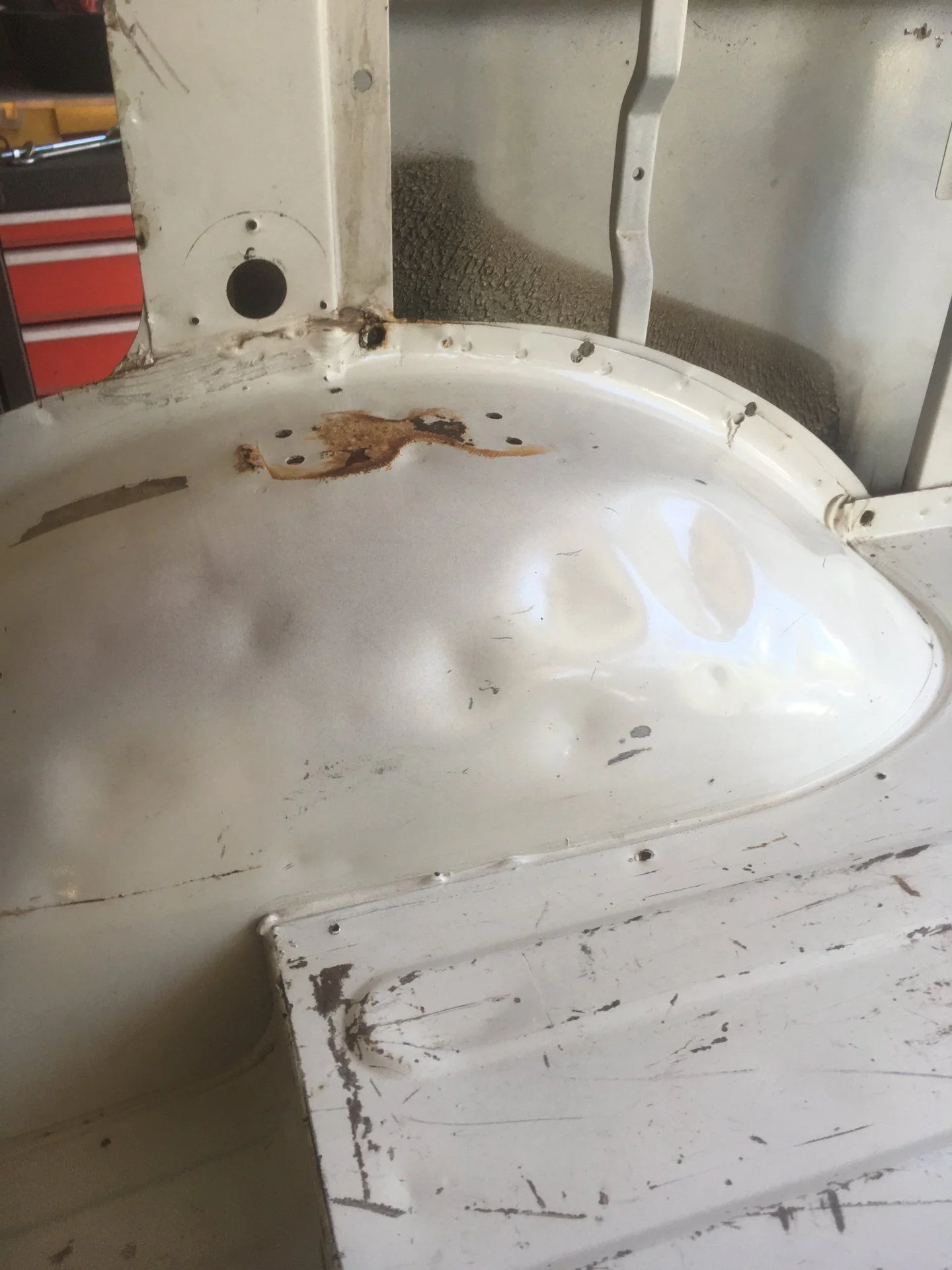

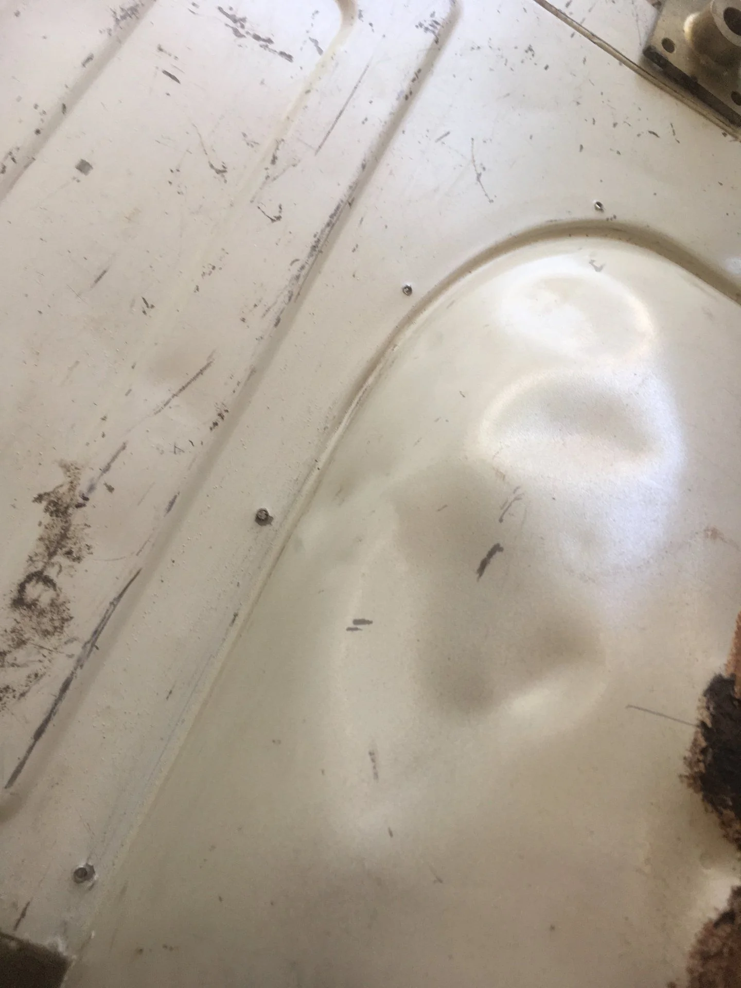

So I have a bunch of dents on the fender. I was thinking- get all the paint off and use my torch to heat up and then just tap out. Any downside to this?
I like to use a chunk of hardwood rounded over on one end and use it like a punch to beat out dents like that. Easy to work them out without creating a bunch of high spots.

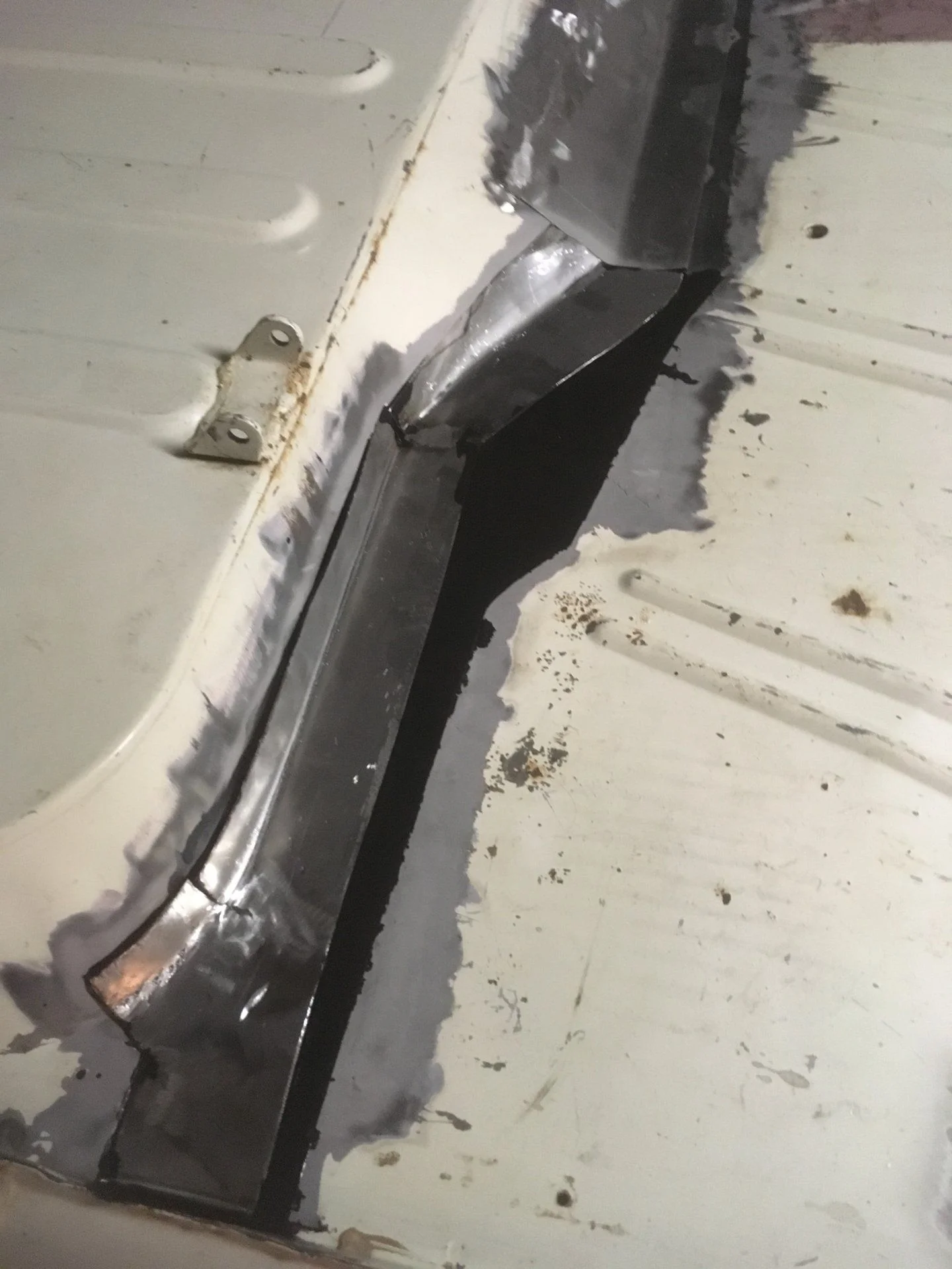

Boy! I am stoked on this silver line!

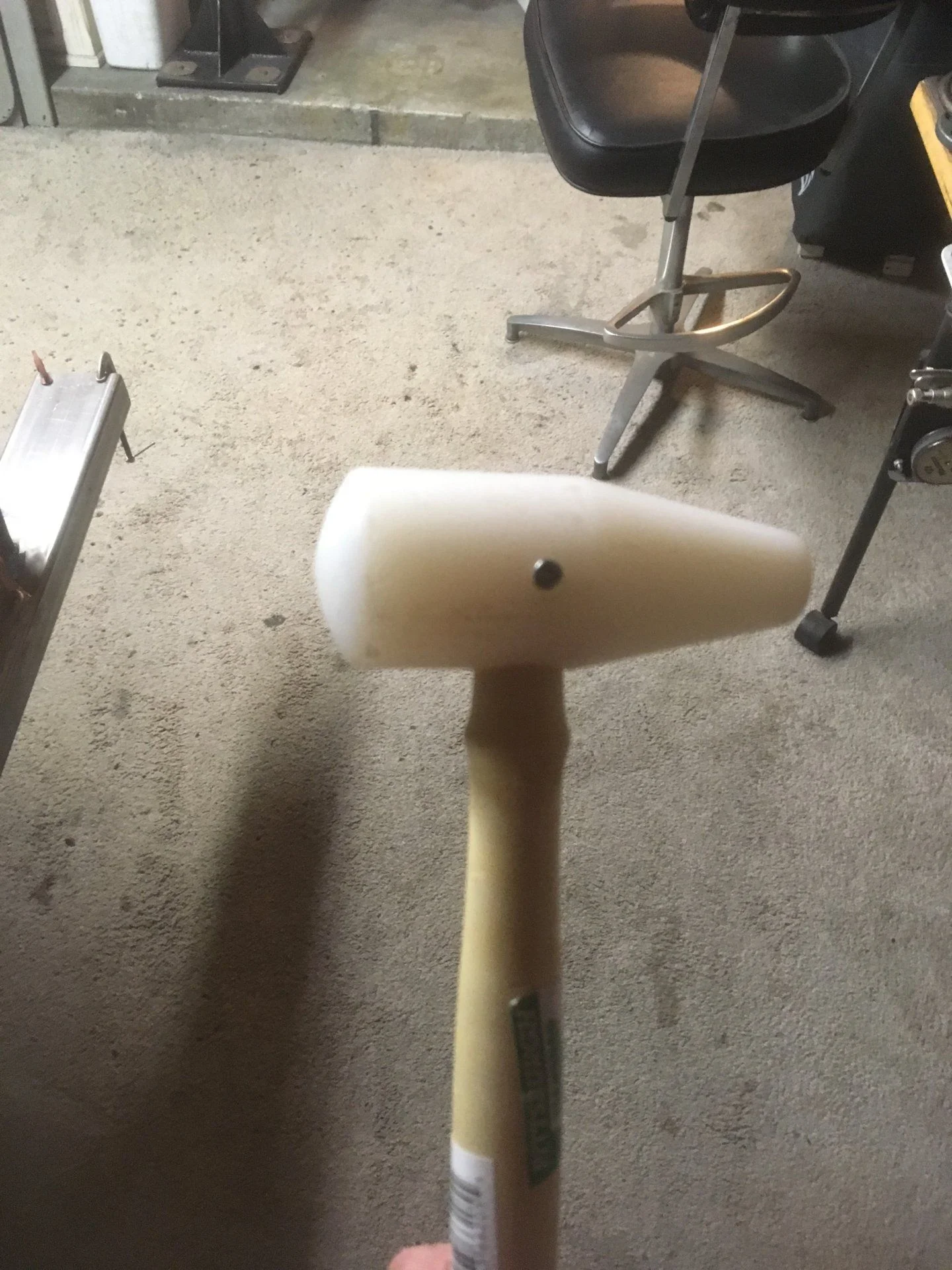

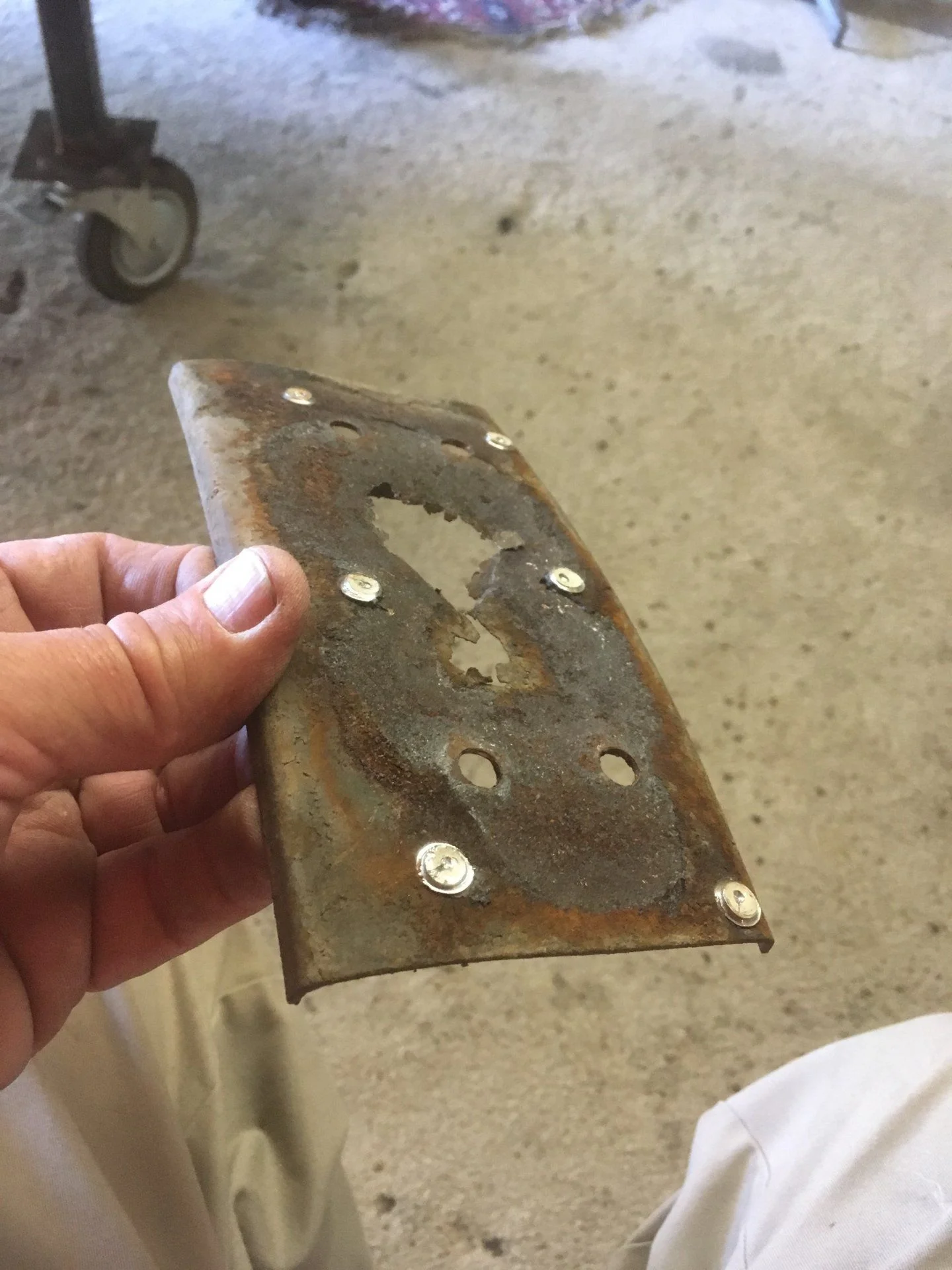

Stoked on this metal bending. All thanks to my new hamme!

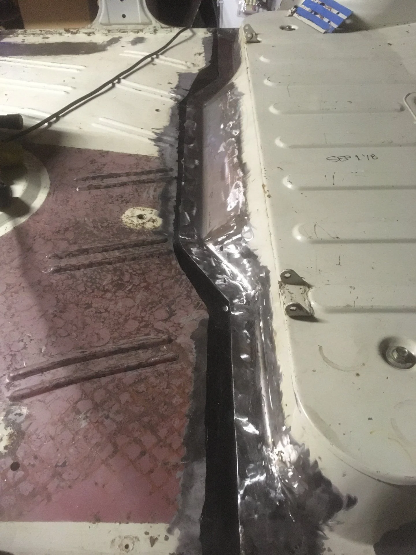

Could use some hints on how to reproduce this shape. It has a general bend that my new hammer can handle. How to create that 90 degree on the outside two edges...?

Boy! I am stoked on this silver line!View attachment 2034475View attachment 2034476
Stoked on this metal bending. All thanks to my new hamme!View attachment 2034478
