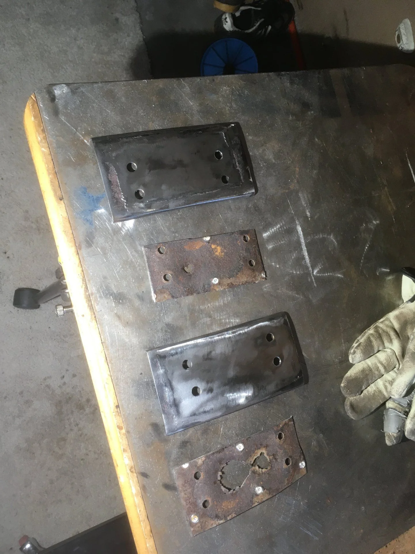

rear body mounts
I'm guessing the wheel well is rusted through by looking at that support piece. I'm with Guppie, just cut a nice piece of flat stock and put the arch in it, weld it up.
This should work
