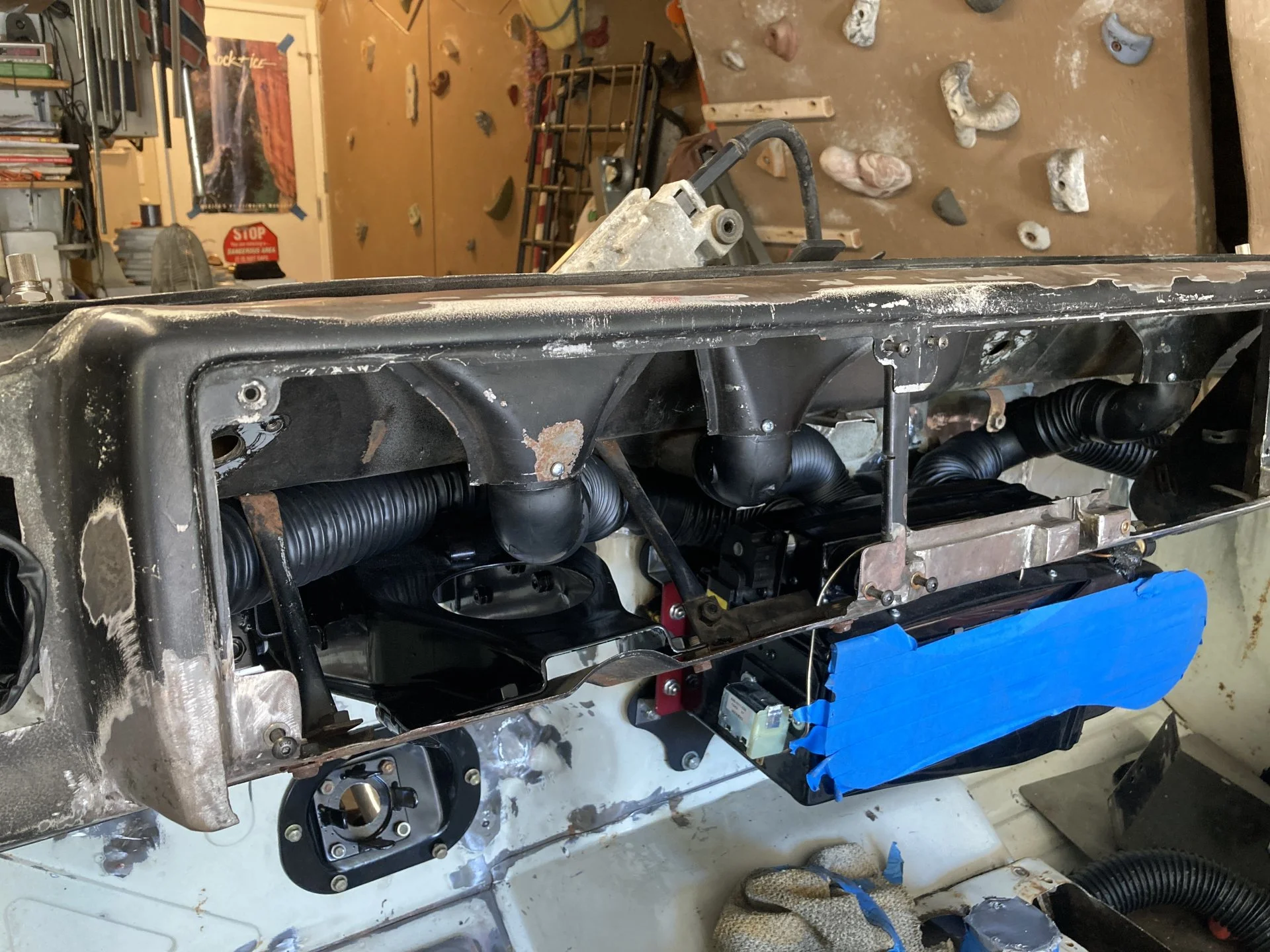

Top left shows the parts made from Home Depot 1.5” ABS fittings, I cut the bell and glued a 1/8” section back on the pipe to form a barb to prevent the flex line from slipping off.
Top right shows the 1” orifice I glued into the Y’s to restrict the flow going to the side window vents.
Middle picture shows the two Y’s or technically one Y and one T attached to the 90’s and how they orientate under the dash. Because of space constraints this combination of fittings may not be the best for proper air flow but they will fit and get air were I need it.
Bottom picture shows how the 90’s fit inside the hacked up factory defroster vents, I still need to dissemble everything to wrap the wiring harness and I will clean up the vents then. The 90’s will also get some self-tapping screws to secure them to the factory vents on final assembly.
Hell yeah!
All the way to the little barbs on the abs.
Now I just gotta figure out the fronts and this part will be off the list.

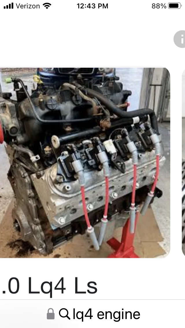

A question for you LS guys.
When I took these off I did not mark driver and passenger. :(
Is there a driver and passenger side?
I need to use these harnesses. I am pretty sure there is a front and back, yes? Just don’t know how to tell which side each came from.

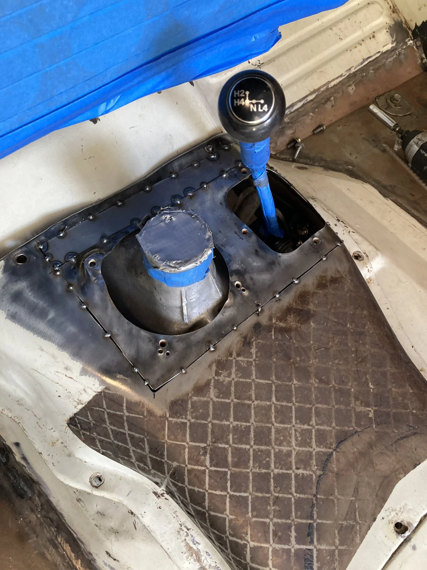

Little things getting done. Welding is cool!
A little bondo and call it good.
I wish I could perfectly blend, but what usually happens is that I blend tooooo much and burn a hole. So lite blending from now on.
I don’t want to think about how much times I spent on my trans hump. In the end it ended up with bed liner. Looks good on top, but the underside is a mess… keep up the good work

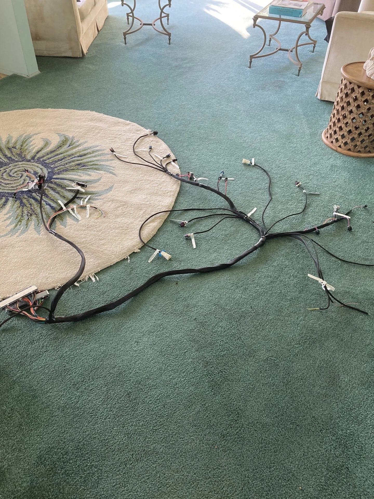

it turns out I had received the wrong wiring harness so I switched gears and got some more AC stuff done while I waited for the new one to show up.

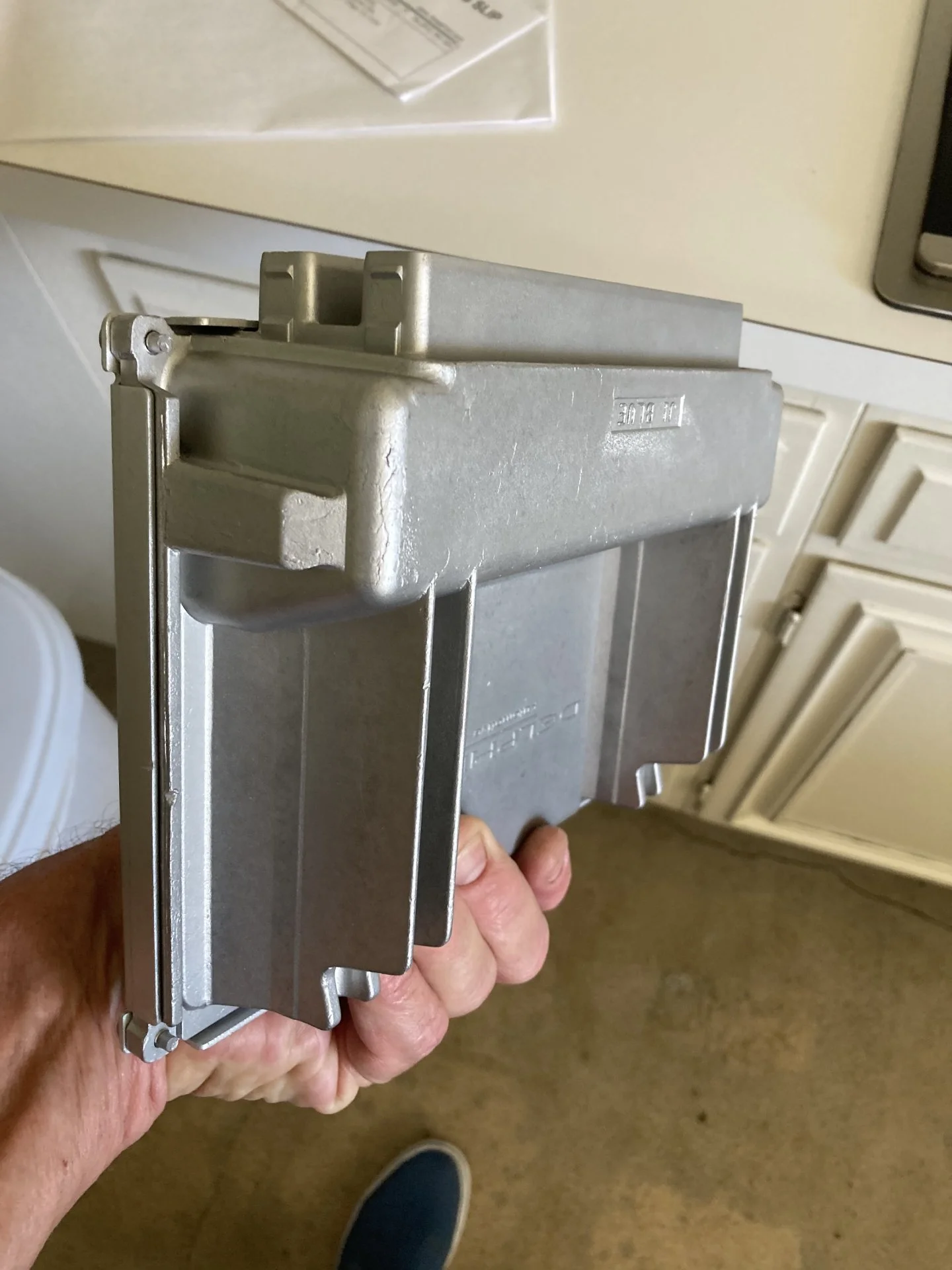

I would have hoped they would have cast some bolt holes in this computer for mounting, but no. Gotta figure out where this thing will live (engine compartment-cab) and the how to mount in place. Was thinking it might be cool to attach to the underside of the hood.
Definitely intimidated by this octopus! 90% just plugs in and there is that last ten that leaves me scratching my head. :/
