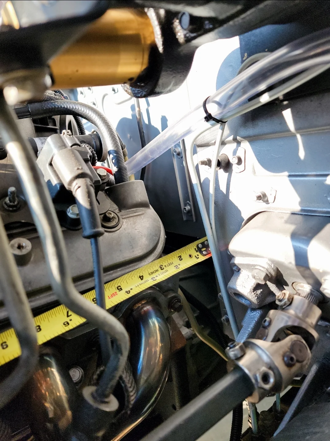

I feel like you could come up a ton on your motor. It looks a lot lower than I put mine, you have a different frame so I am not sure.

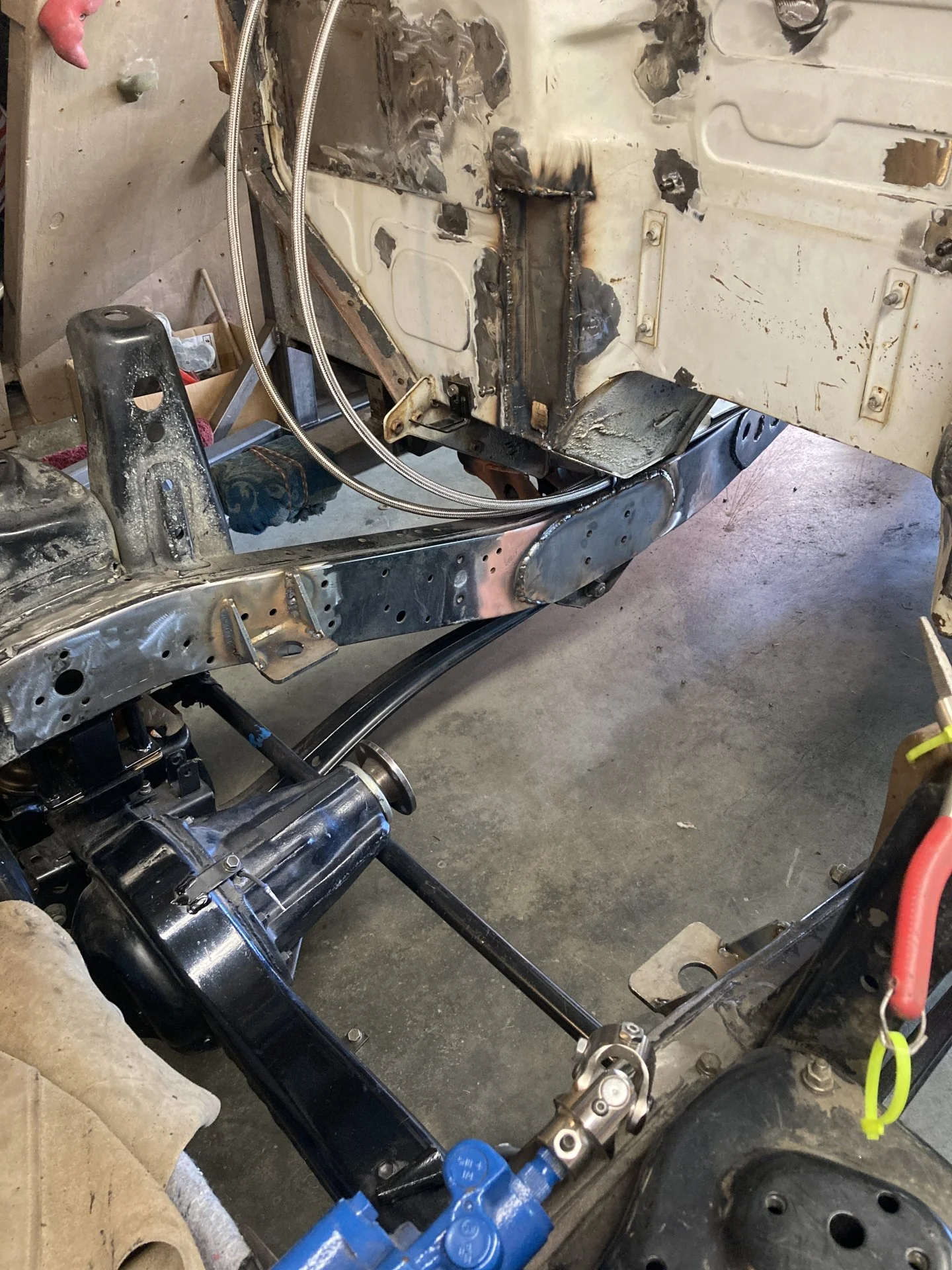

I’m not up to speed on that tube but this was my thought..what are the loads on it?
The track bar goes from one side of the frame and connects to the front of the axle housing.
This bar connects both sides of the frame. On one side it connects at the same spot where the track bar connects to the frame.
It helps prevent the lateral load from sheering the track bar mount off.
Does that make since?
I used the pics that you got me a while back and I think as far as the body is concerned I am pretty close to where you were at.
Yours
Mine
All bets are off with this different frame.
Oh ya, maybe you are pretty close to me.
Ok so just a tube crossmember then, no real issue rebuilding with a bow in it I’d think?
Yes. I was dickering around with these little 1/8” here and 1/8” there, with nothing that gave any real clearance, so I finally cut it to make some more reasonable spaces.
Gonna make it look pretty today.
