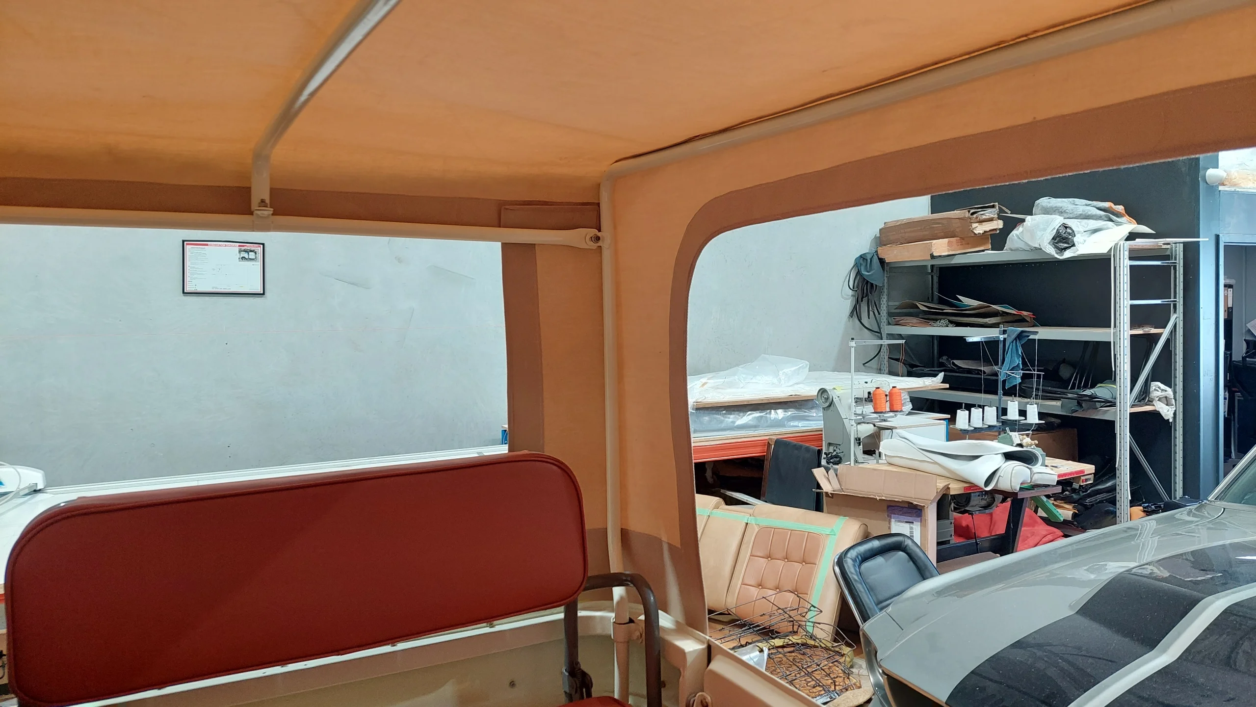

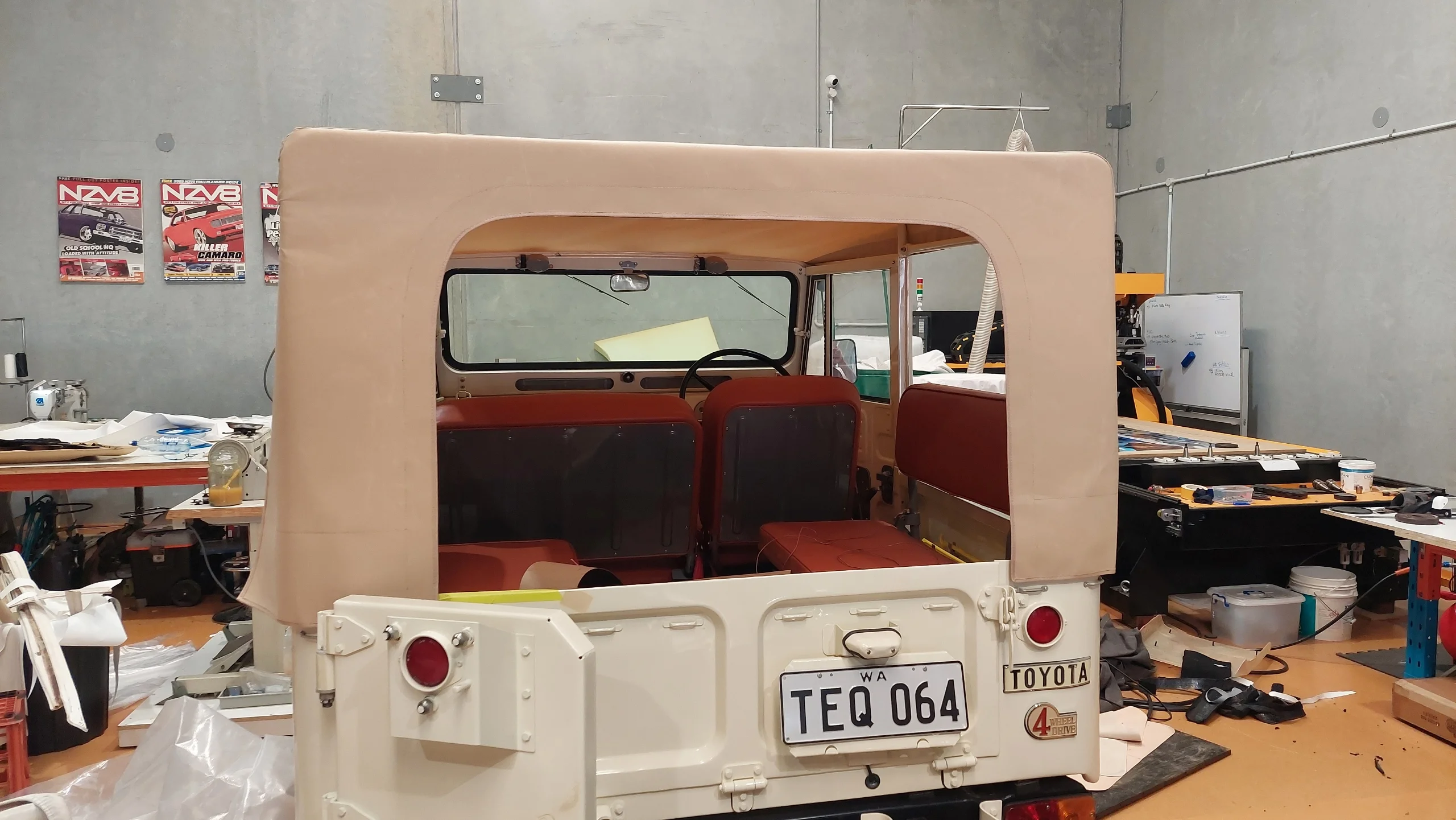

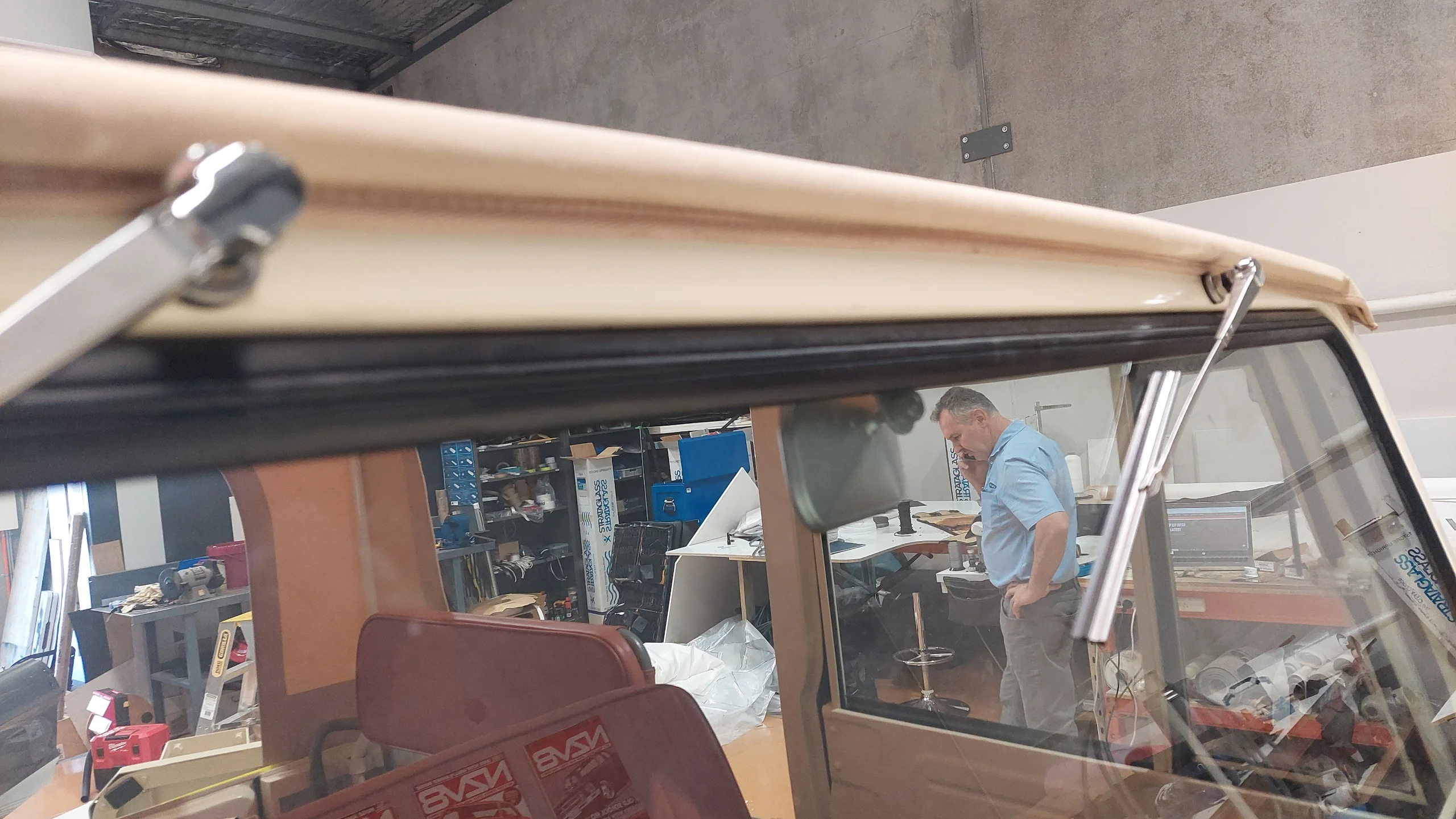

I will have an update soon. Upholsterer started last Monday.
N.b. using Haast Stayfast Tan/Tan. Clear Vinyl is thicker. It's what is used on Flybridge Canopies on Boats. High UV resistance, doesn't pucker , prism or yellow. Fittings are genuine oem or as close to original as I have been able to source over the last 10yrs. It should be amazing!

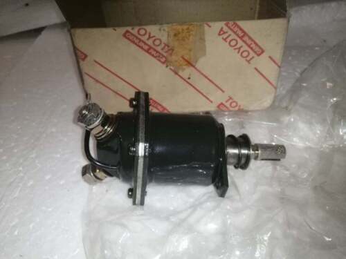

Here is a option for Solenoid.I have an Auto Elec here in Australia that can build one up , just need parts. My Armature is cooked, Brushes , Commutator etc very worn. Solenoid tired too.
It's a 24V solenoid. I bought one without looking closely. To be fair, it is advertised accurately and is absolutely mint.Here is a option for Solenoid.
