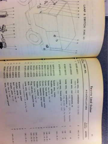

Get some measurements on the tail lights and I will compare them to the earlier 45 series long wheel base pickup. Also contact Dobster, his 45 has the same lights. In a few days I can compare parts between the two. Not many early shorties around in Australia. Much earlier and everything from the cowl was made locally not by Toyota.
Very nice 45 there. Looks like you did a great job restoring it.
Do you know anybody who does work with plastics? Anybody work for Sabic? :)
You are going to need to cast new lenses... These lenses were Aussie specific ... You could pull the part number from the link I posted in the other thread from dobster but I think he had tried already... Pm dobster he may have found something ... I found something that's close from a daihatsu... There are 45 lights that are close... But... They are also rare to find in good shape
No problems here Johnny. I do find this tail lights to be interesting. The lens appears to have a reflector cast into it. Wonder if Australia required a reflector on both sides. Here in the US DOT lets things slide. FJ25s with spare on the weren't require to have a reflector on that side. Don't think Australia let things slip by. You would be the one to find the thread on the other early FJ40 with the small round turn signals mounted to the bottom of the rear crossmember. Was it a 63 or 64. Excuse me if it's already linked. Using my phone so not as easy following all the links.
