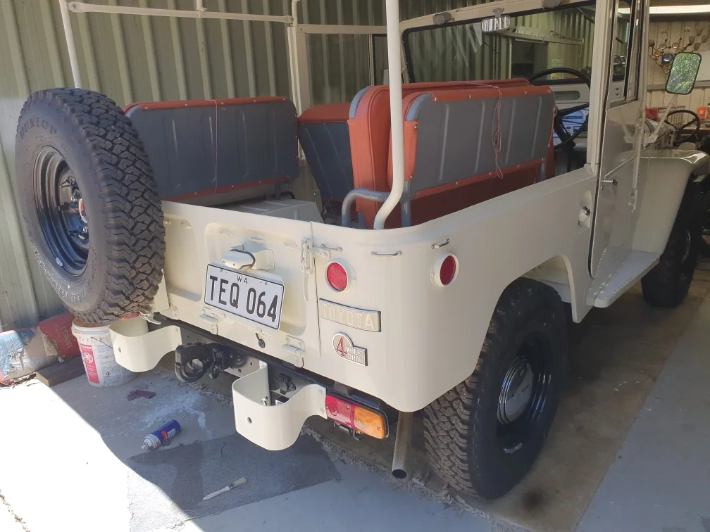

I rarely visit the 25 section and haven't followed this thread. Question why does the exhaust exit on the right side? Air cleaner used in 64 was different than the earlier air cleaners. Thought oil bath was rare in Australia? US got the oil bath and hub caps which were actually options but seem to be standard in the US.
Also I would be sure the B pillar bow in long enough to reach the second hole down in the tub. Can't tell if it as long as stock. I was guilty of cutting one of mine a little short on my 68 hard top. I was a little younger back in 1974 when I did it.

Yes, I'll be getting the angle of exit of the rear pipe altered to come out at 90dg to chassis. This was an error.

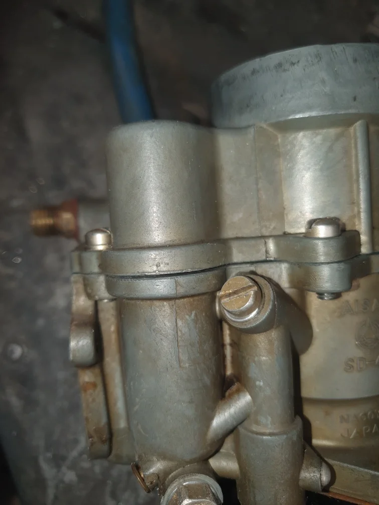

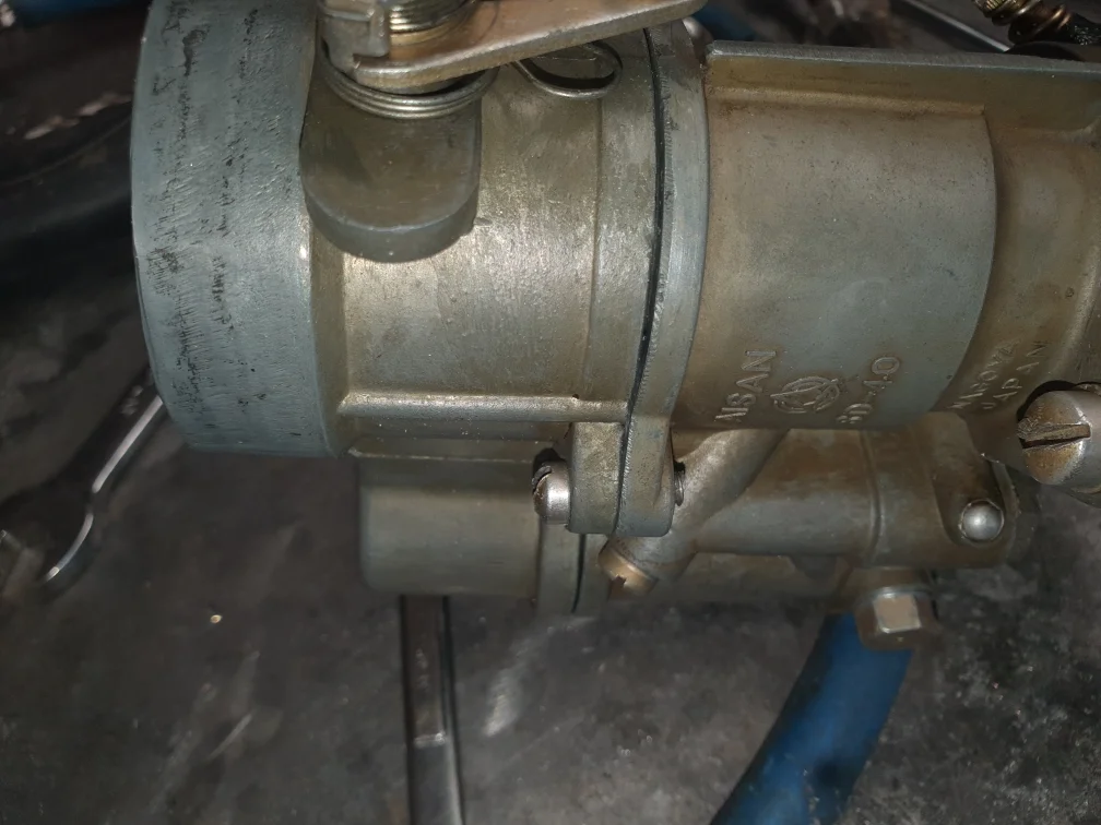

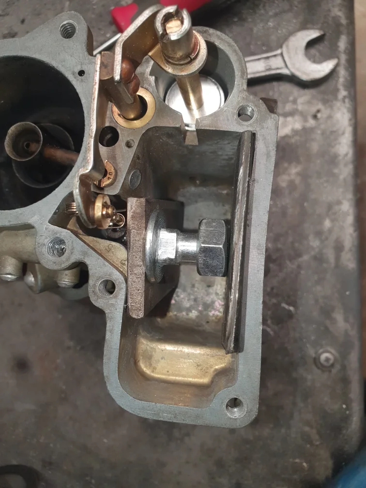

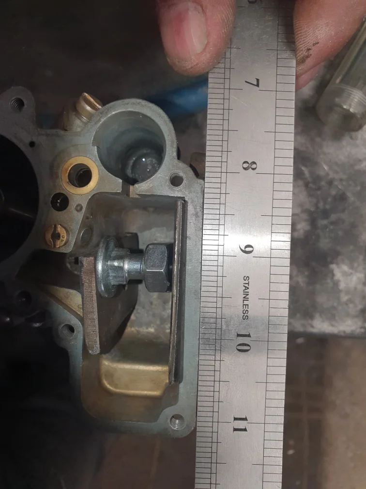

What part is warped, the top or bottom half?
I have seen them resurfaced by sanding with fine emery with the sheet of sand paper on a 1/4” piece of glass. Has to be a very flat surface and glass will suffice.
