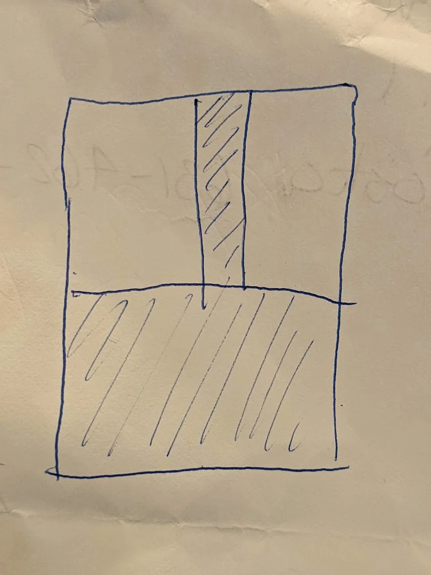

When I have the bikini (or both), significant amounts of rain will pool on top in the areas between the bar tubes. (Yes, I have the bikini strapped down as tight as I dare). It doesn't penetrate the bikini but I have to dump it off there eventually and it inevitably makes a big mess.
I have been playing around with ideas for some way to stop that from happening...
- Some sort of modular panels on top of the bars that I can put under the bikini when it's going to rain.
- Some sort of "arch" (pvc pipe?) arrangement to dome the bikini when it'll rain
- I don't want a full permanent hard roof although I did think about one for the large open space at the rear of the cage above the "cargo" area. Maybe even down the middle between the 2 center bars in the front section of the cage. (shaded areas below.)
So.... what are people doing to prevent pooling?

Ive actually seen a 2x2 piece of wood used for this. It didn’t seem to be vey tall either mostly just barley pushed up on the top material.
I want something that I can take with me in the 40 and break out when I need it. I tried a pool noodle sliced so that it fits over the top of the roll bar. I used it on the mid crossbar. It helps a little but it's not enough. I was thinking about some pieces of rigid plastic that I could put on top of the bars and velcro in place. One piece for each open section. Maybe in the rear section it would even be hinged so it could be half size one stored. Although that seems like a lot of hoo-ha to carry around in the 40.
As mentioned above, the 2x2, I think something on top of the mid crossbar tall enough to create a peak might do it for rain.
Either that or always park the 40 on a steep hill! :-)
What if you stitch 2 ends with a space to wedge something akin to a tent pole that would bow upwards enough to have the water run off the sides? I can envision it but maybe not explain well what I mean.
I understand what you're saying. I was thinking about a couple pieces of 3/4 PVC wedged between the outer cage bars forming a dome arch thingy. It would probably only have to arch three or four inches to get the job done.

I used a 2x2 with a tennis ball on top inserted vertically between the console and middle of the bikini.
Simple and effective.
