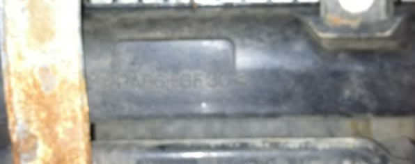

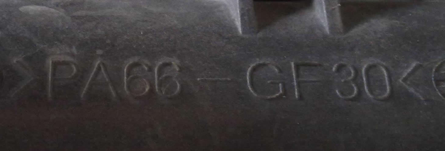

Good info here with a few twists and turns. Came across this thread as I saw a 2005 LC with the “PA66-GF30” radiator. Sounds like this type of radiator is OEM but not the stock one or the preferred one?
Here is some information I found about PA66-GF30 on the plastic radiator tank:
Customers often contact advanced radiators looking for a radiator and they give us a part number of PA66GF30. As they find this number on the radiator.
However this isn't a part number, this refers to the type of plastic used on the end fittings of the radiator.
Apparently it is made up of: Polyamide (nylon 6,6), 30% Glass fiber. Its very strong and is easily bonded and welded - ideal for use in car radiators!
More technical details about the plastic can be found here: http://www.merrem-materials.com/uploads/File/Kunststoffen/PA66_GF30_black.pdf
