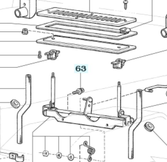

Hello, welcome!
You must have a early 78 because i think that vent ended in 1977??.
Thats called a cowl vent, it lets fresh air inside the Cruiser. Should be a pull switch somewhere on dash, or under dash. Land Cruiser air conditioning. It had two drains that are probably full of dirt and broken down leaves.
New vent seal and drain tubes can be purchased to fix problem. Check out City Racer LLC - https://www.cityracerllc.com/password, You can get everything there.

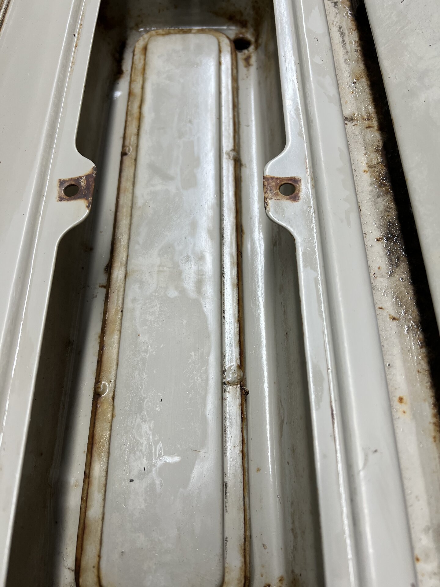

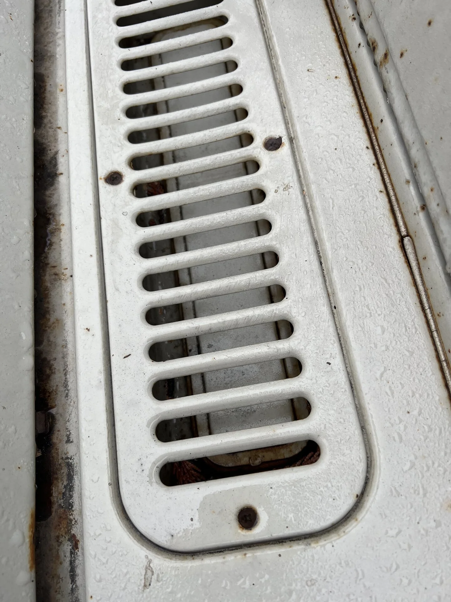

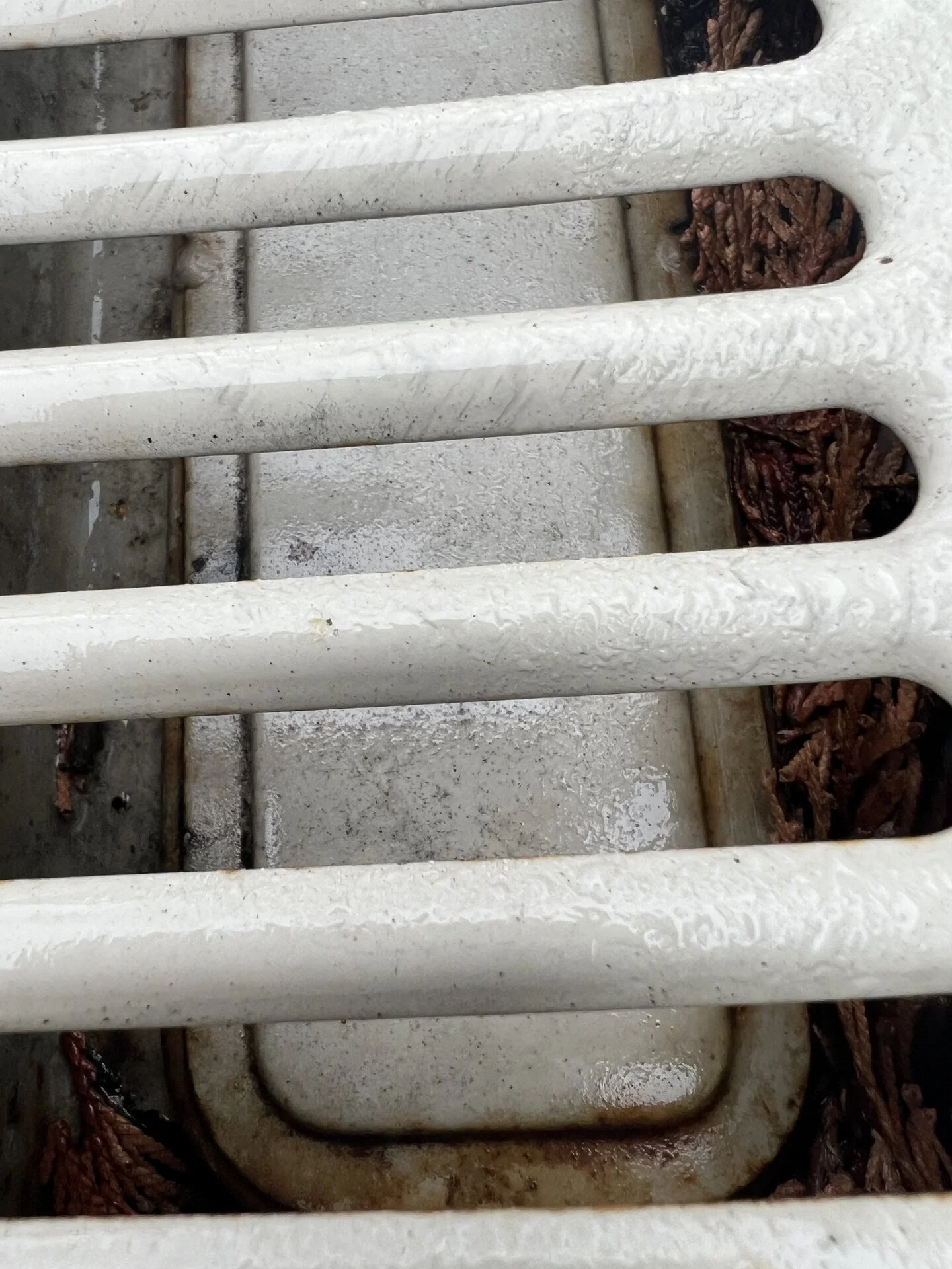

I do have a vent, but have not yet dismantled it to see how it operates, if it does
It’s for looks only, welded shut with 4 tack welds.One vent was clear, the other blocked completely took a while to clear it.
