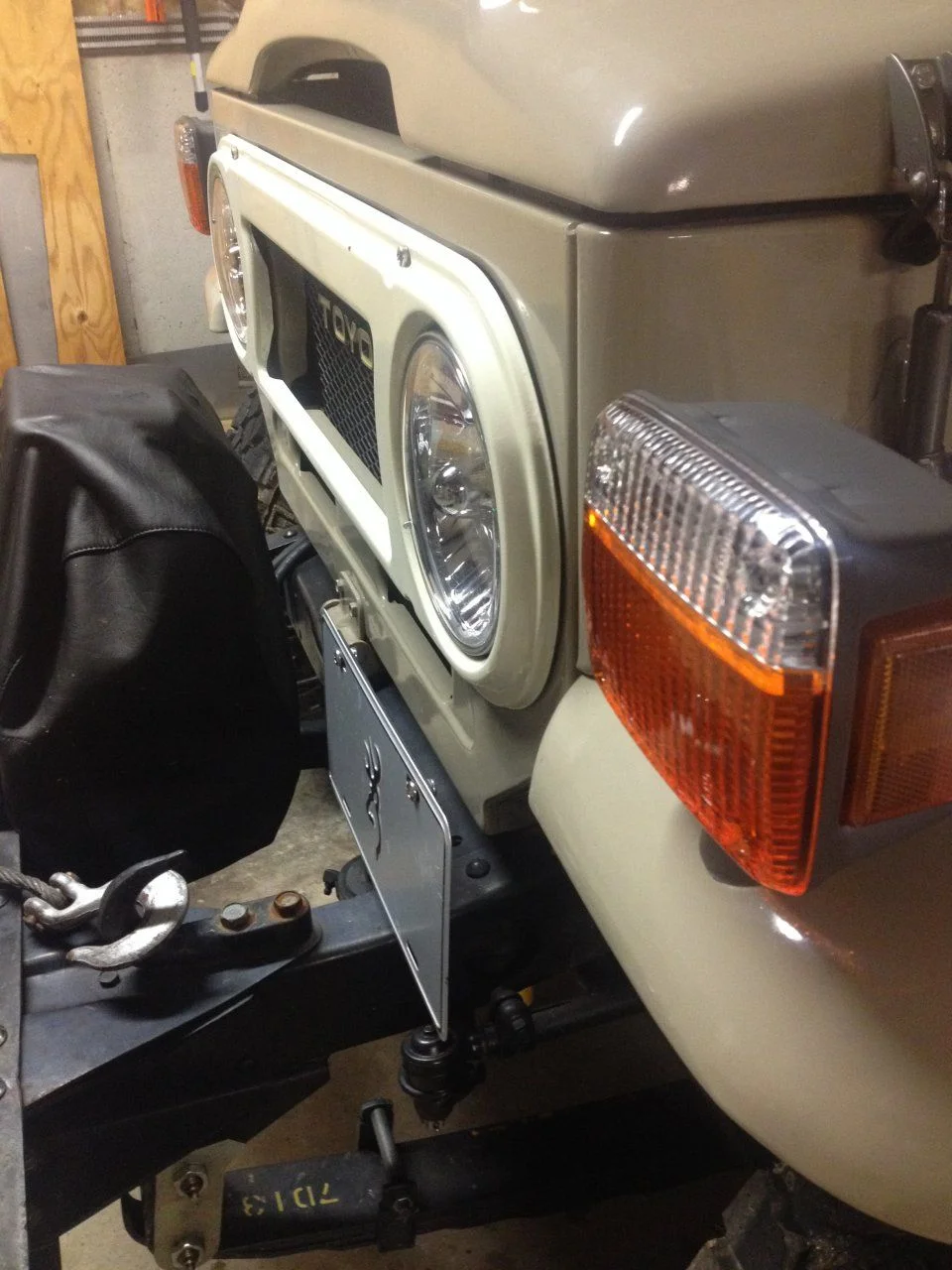

Finnish version, that’s how the reg.plate is mounted here ‍♂️
I will move the plate somewhere else, when I get them back. Those have been missing last 15 years.

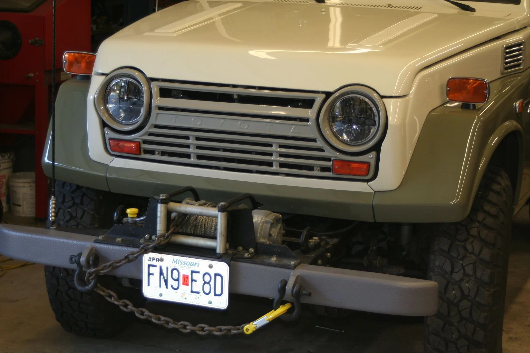

Some even put the license plate there. (photo from treerootco)
winch1-jpg.16316
source:
factory fj40 upright winch mount/bumper
Also, from what I've learned, the larger fog lights are JDM.
Great, glad to see another BJ.
You can relocate this plate as shown by treerootco. :)
