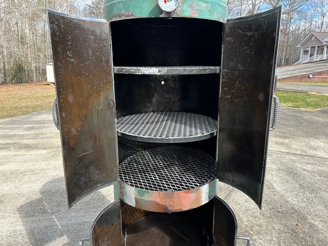

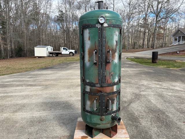

Probably going to be a learning curve. Maybe smoked turkeys for Thanksgiving this year. I think I can fit about 20 in there!
Practice makes perfect.
Paint makes almost everything look better. Still waiting on latches. Shouldn't have ordered Amazon but they had a thermocouple I wanted and it pushed the order over min for free ship. Also got a deal on a pellet feeder/smoker add on that I may try to plumb in at some point.
Nice steampunk look to it. (or is that "Smokepunk"... ? )

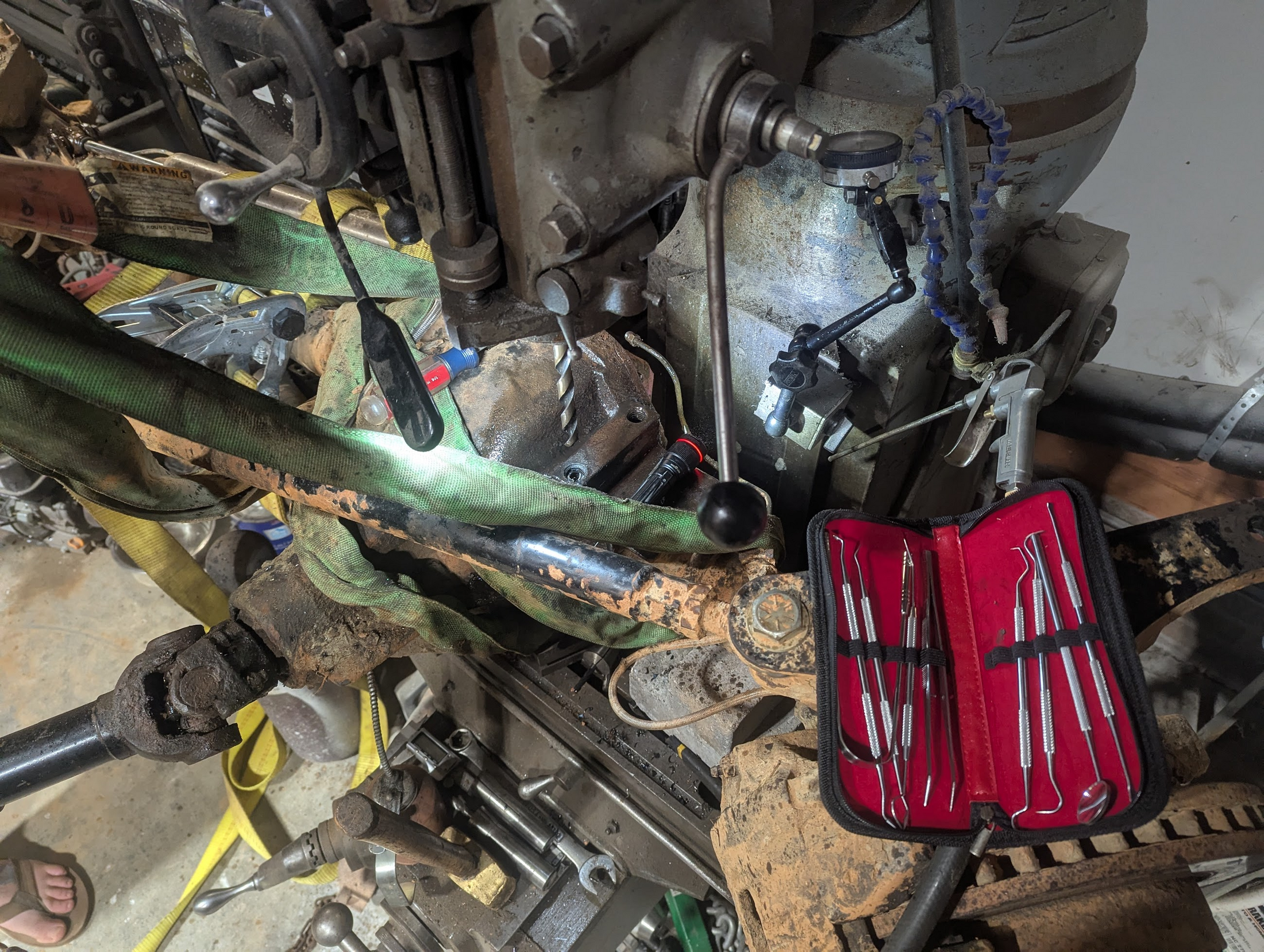

Had to get my front axle housing on the mill table to remove a stubborn bolt after attempts to extract in the truck didn't go to plan. Carbide end mills, hss end mills, drills, and picks to get it out, then a final cleanup with a tap.
