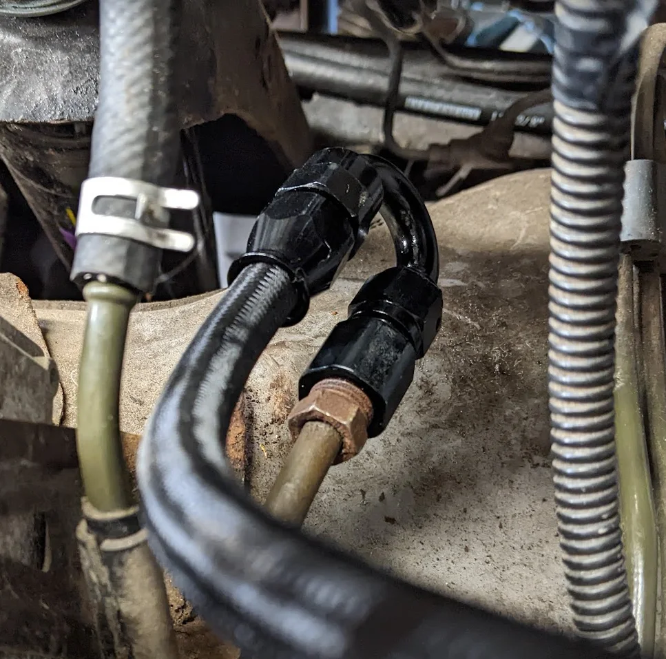

Thanks - I can't get that threaded union apart - it turns a few threads and then freezes so hard the nut is starting to round off.
Could I cut the banjo fitting off the end and do hose barb to -6an adapter, or is the pressure to high?
Are you using a tubing wrench to try and take it off? I wouldn't use a hose barb but that's just me. You can remove the entire fuel line off it and clamp it into a vice to help hold everything. Or maybe try a pair of good use grips to turn it. I know what your talking about I've had them be a pain to remove
Do you mind if I ask how you connected the fuel line to the fuel regulator?
Did you disconnect the Threaded fitting at the end of the hardline, or cut off the banjo fitting and repurpose?

This is mine..no cutting involved. It is an adapter to AN fittings.
Don't use barb on the high pressure side, unless you like engine fires.

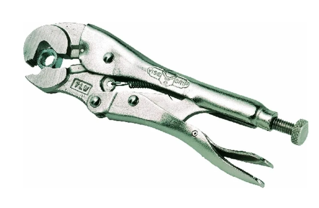

Heat, and penetrant, and a brake line wrench = success. You can get vise-grips like these.
Thanks everyone - it breaks loose, turns a few rotations and then locks up SOLID on the way out - to the point my Harbor Freight flare wrench is starting to bend. Just one of those seized-thread adventures that adds spice to the project I guess - I'll try that vice grip wrench next...

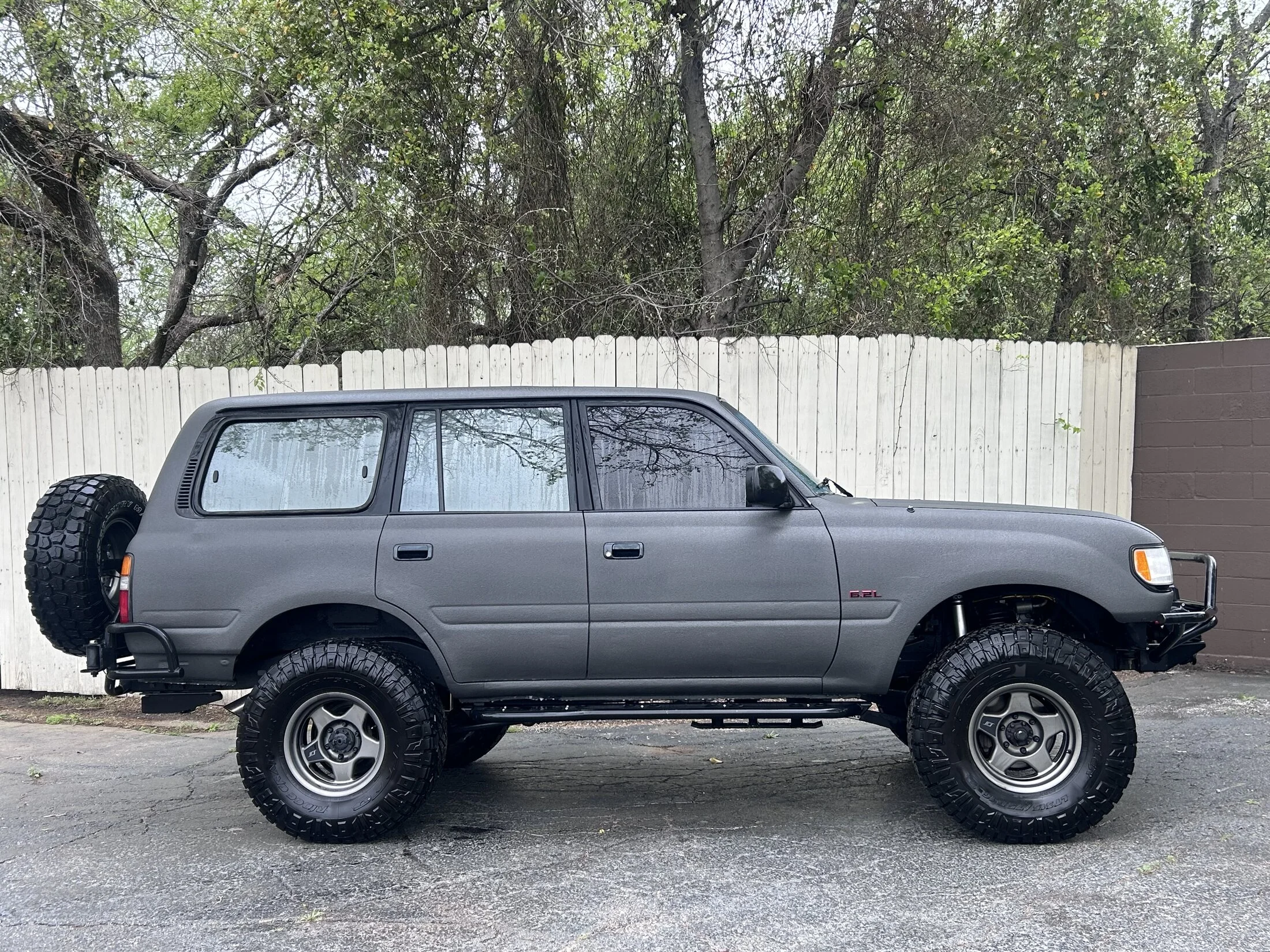

Well Its been a few months since I've been on or given any updates and here is why:
I sold the truck in September (a guy made me a crazy offer). After going 6 months without it, I text the buyer last Friday asking him to let me know if he ever decided to sell it, thinking it would be a few years. He said "funny enough its for sale now." CRAP. I wasn't expecting that! I pulled my wife aside and asked her that she thought about buying back Sparkles. To my surprise she couldn't have been more happy or supportive. She was upset I sold it to begin with and told me to go to the bank and get our 80 back. So I did. The buyer hadn't even swapped over the title yet so she even still had her "SPRKLS" Classic LP.
The buyer had made some huge improvements including Corbeau seat, Icon/Delta suspension, SCS wheels, ceramic tent and a completely new sound system. He was happy to report that the LT swap had been rock solid and towed his racecar trailer all over Texas.
So shes back home!
Ill post some driving updates and a new video soon.
I am always surprised when people sell just after completing major projects...
I don't know, but I think the offer would have to be approaching six figures before I even consider selling my ls swapped and mechanically restored LX450. Way too much of my money and time involved...
I sold the truck in September (a guy made me a crazy offer). After going 6 months without it, I text the buyer last Friday asking him to let me know if he ever decided to sell it, thinking it would be a few years. He said "funny enough it's for sale now." CRAP. I wasn't expecting that! I pulled my wife aside and asked her that she thought about buying back Sparkles. snip, snip.
So shes back home!
Awesome and congratulations! Looking forward to updates as I'm going to be doing a swap on mine soon. Something similar just happened to me. I sold my Golf R back in 2017 because I no longer had a commute. That guy (who I knew), sold it to another guy (who I knew well) and a few weeks ago that guy approached me and said he was going to "fire sale" the golf because of an intermittent electrical problem that the dealer couldn't find and did I want it. I hemmed and hawed but then he called up and made an offer I couldn't refuse. It was sitting at the local mechanic shop and I just had to tow it to my driveway. Went out, sure enough didn't start. Spent five minutes looking around and employing Occam's razor.... Found an electrical wire to the starter that had been chewed by something. Put the two ends of the wire together and voila, it started. Called the owner and asked multiple times over multiple days...are you sure. He had had enough. Bought it for a little more than 1/3 market value. It was exactly the same car in the same condition, with all the spendy maintenance done that I had sold 7 years and 50k miles ago. I can't believe a mechanic didn't catch something so simple. Or that my friend/seller wouldn't want to keep it or sell for a higher price given the findings. But karma, I guess.
So shes back home!
Pablo at Tandem told me that you had sold it. You gave me a ride in it one day at the shop. I'm still planning on this swap.

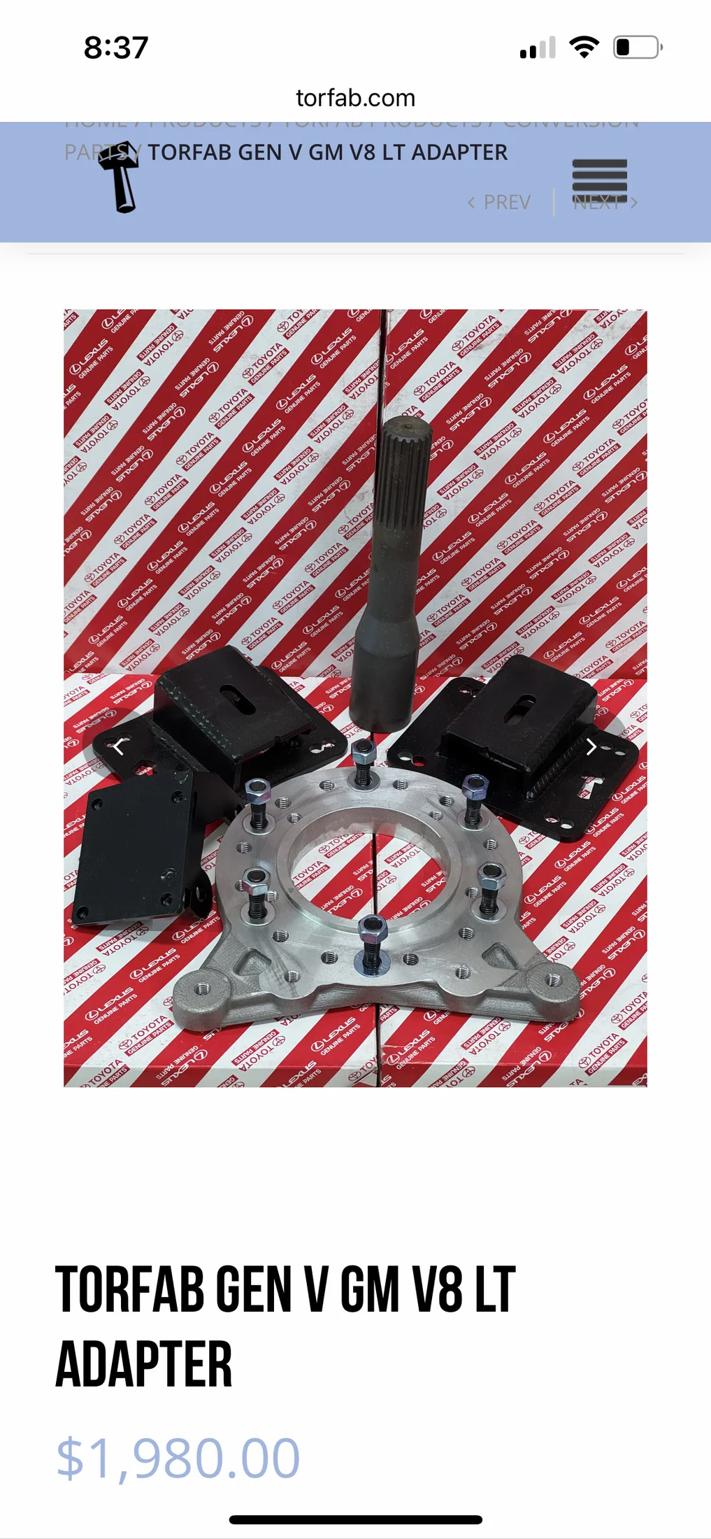

Dang. The Torfab kit is only $1980 now? I paid like $2700 😂
