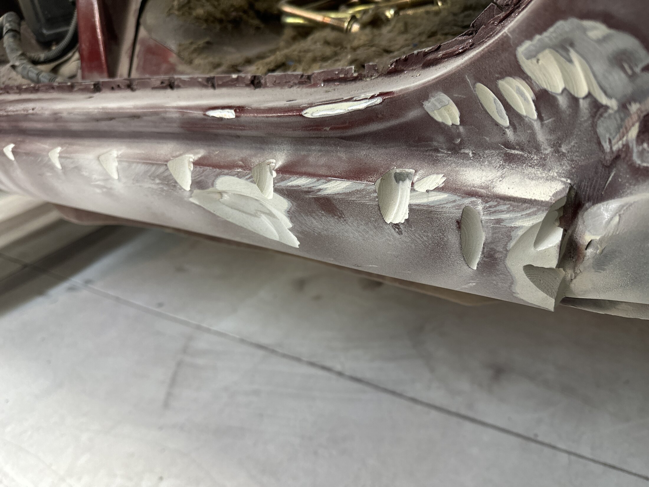

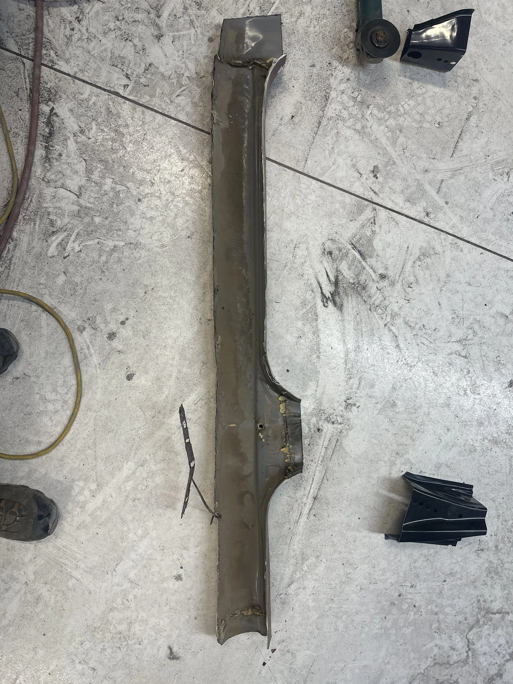

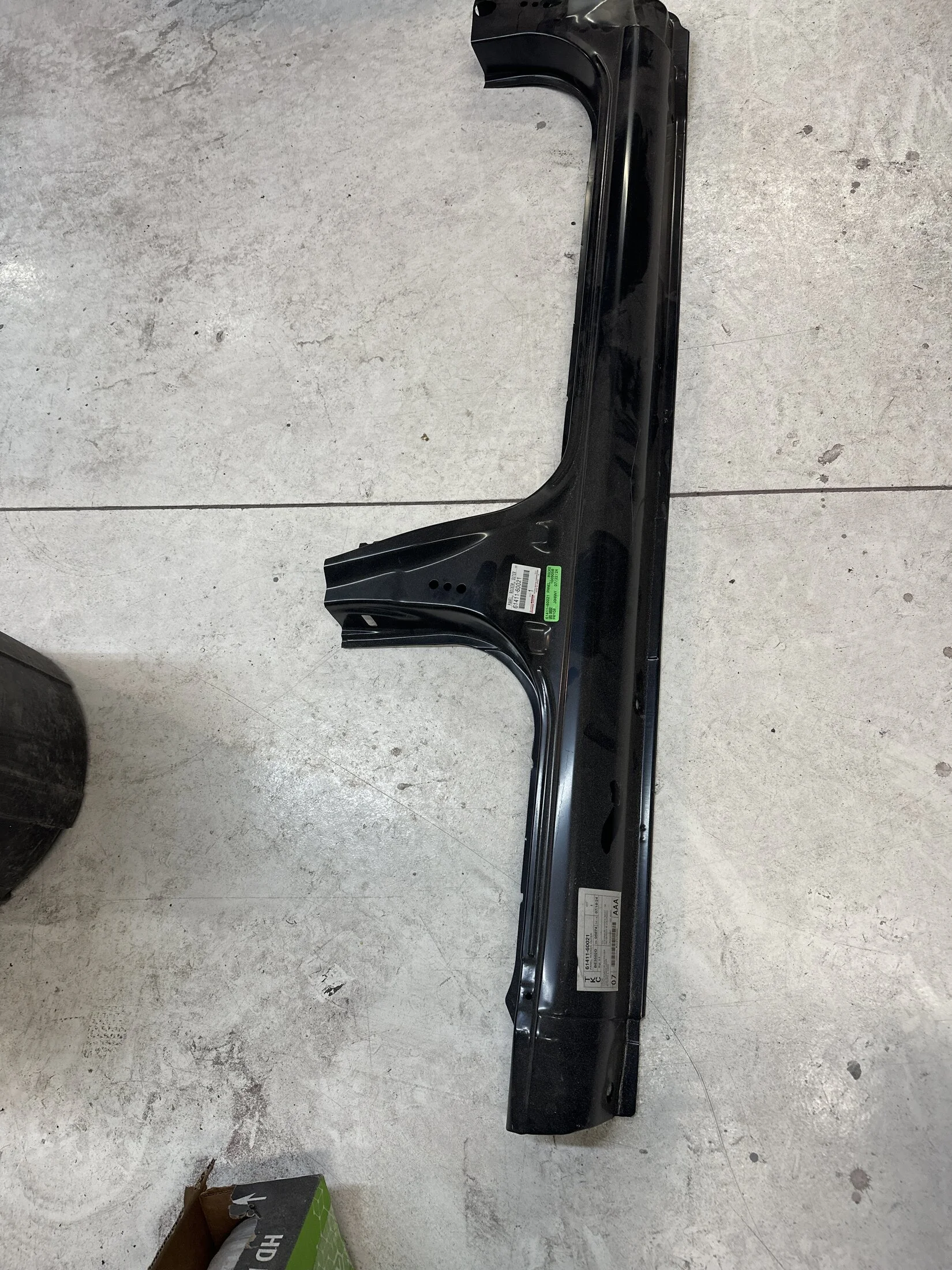

Replacing this rocker with a new Toyota part because it was previously crashed. Just for fun though, check out this high quality bodywork! So awesome. 3/4” thick filler. This body man needs to quit his job at the collision shop and become a sculptor, maybe buy a beret.
OMG! Taking out that mud is going to shave 15 pounds off this truck! That's deeper than the tail gate of my old 55
About 3/8" deep...
Haha! So funny. It’s like at least a full gallon if not more. Proof filler won’t crack if applied too thick :D

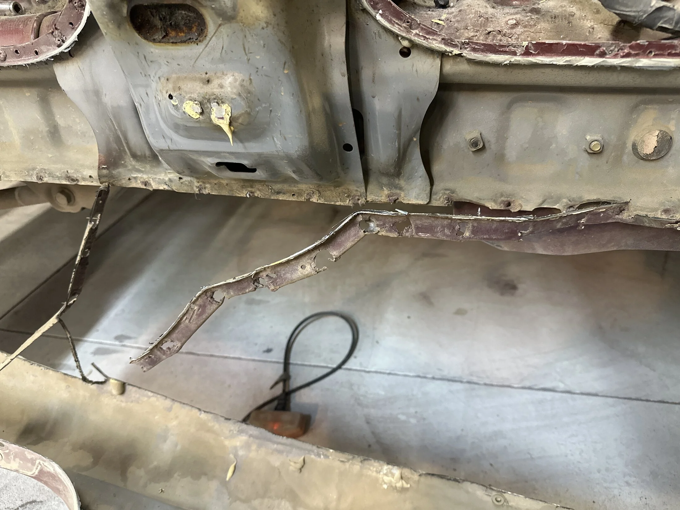

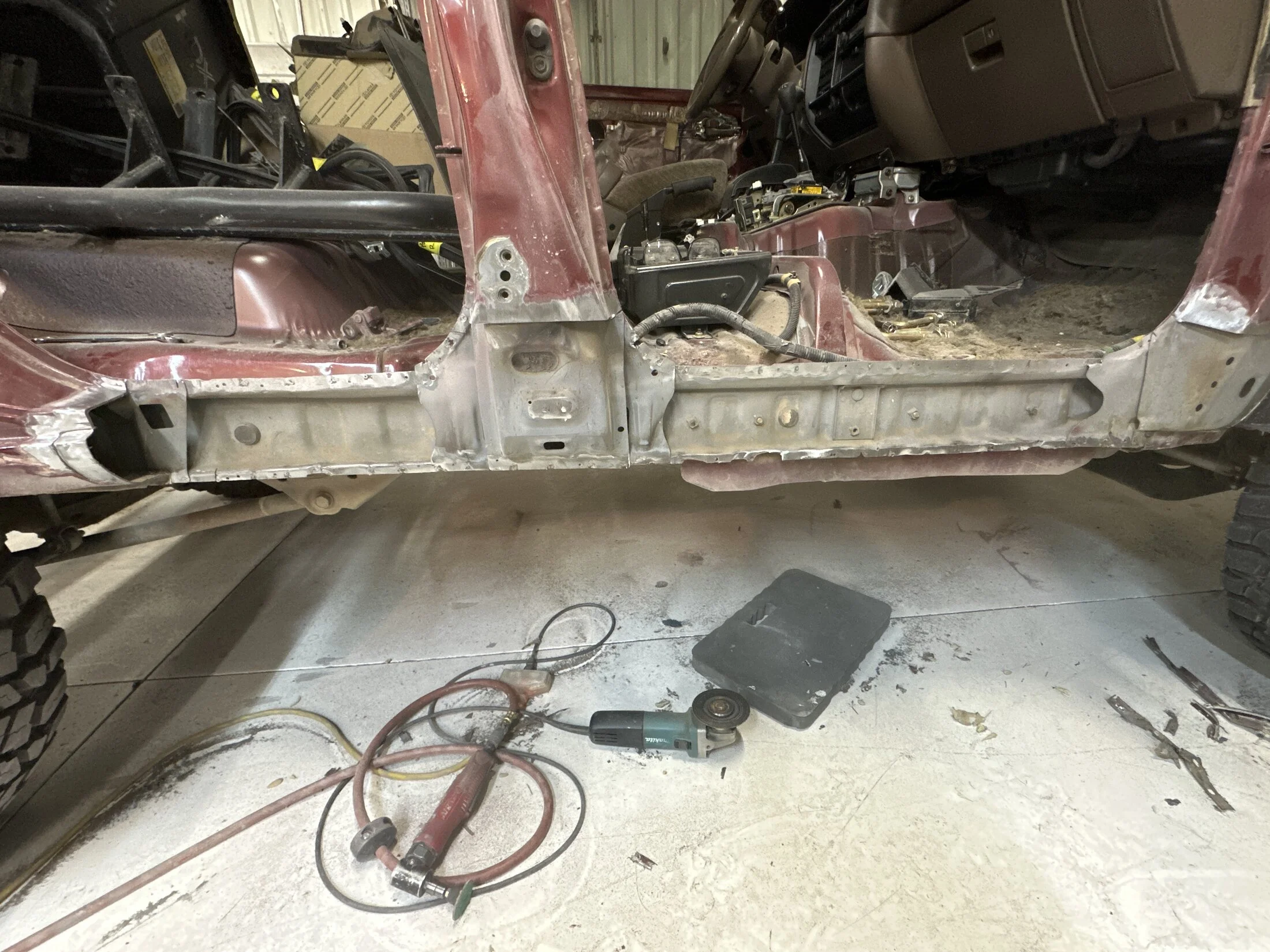

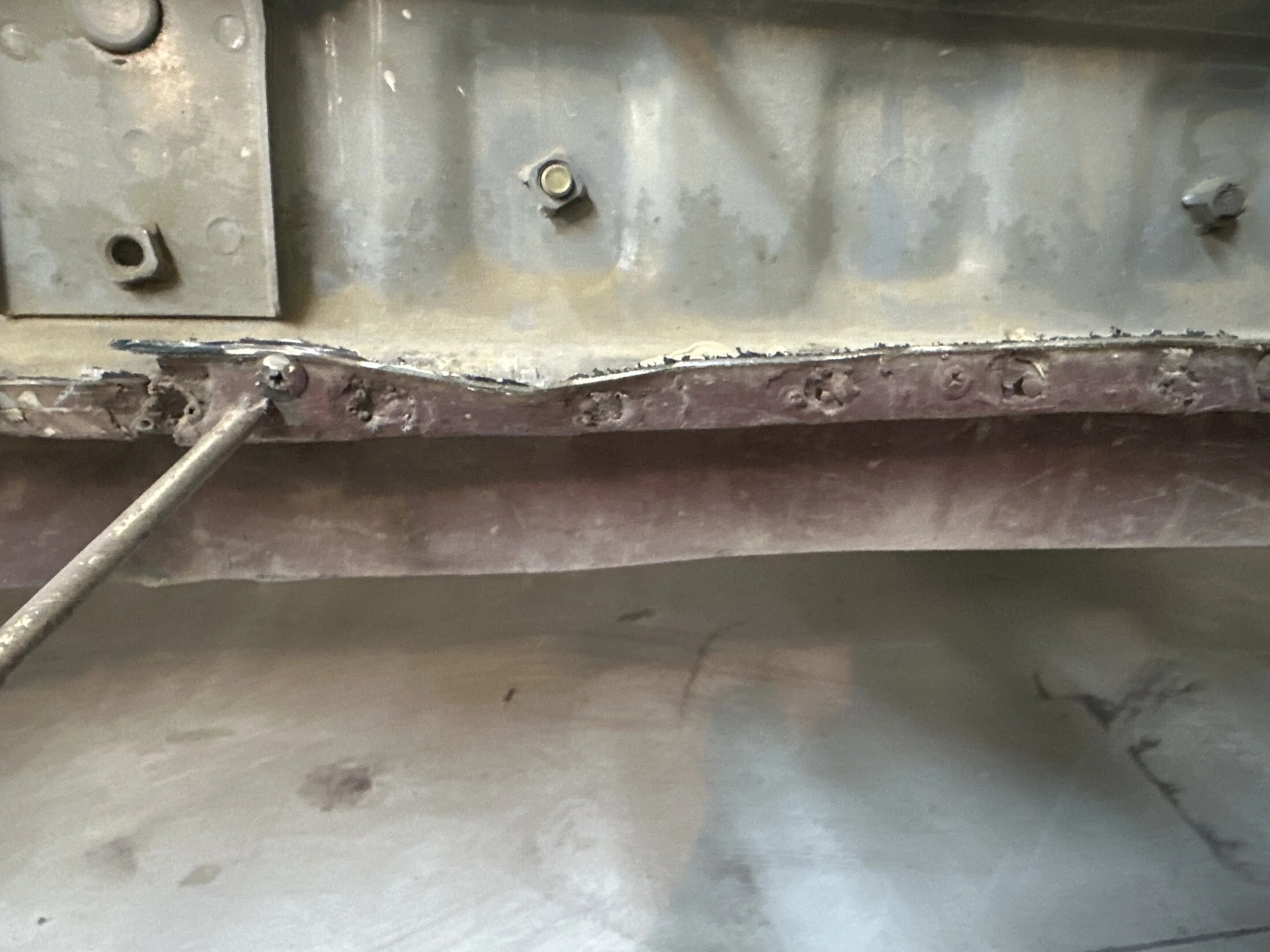

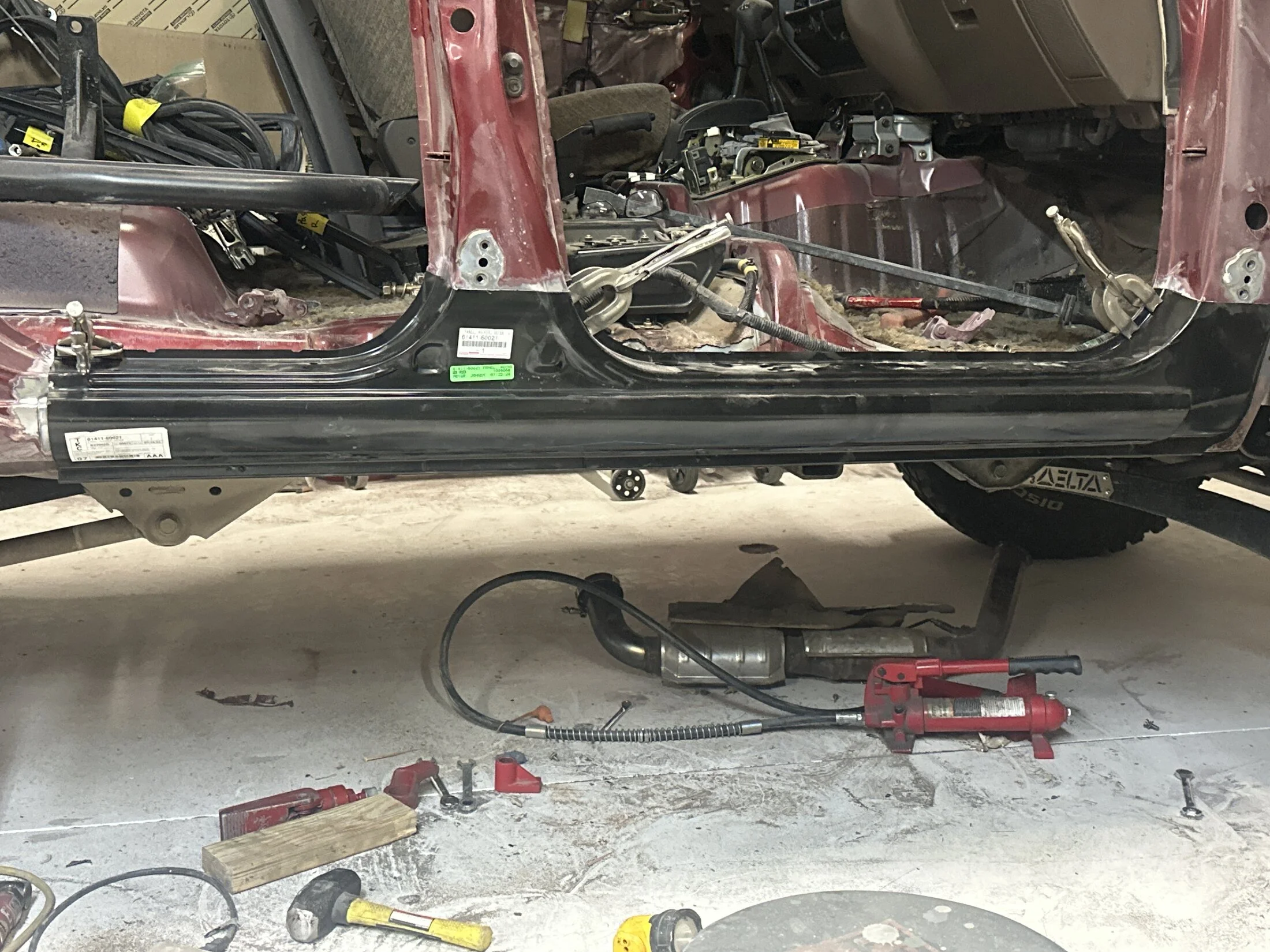

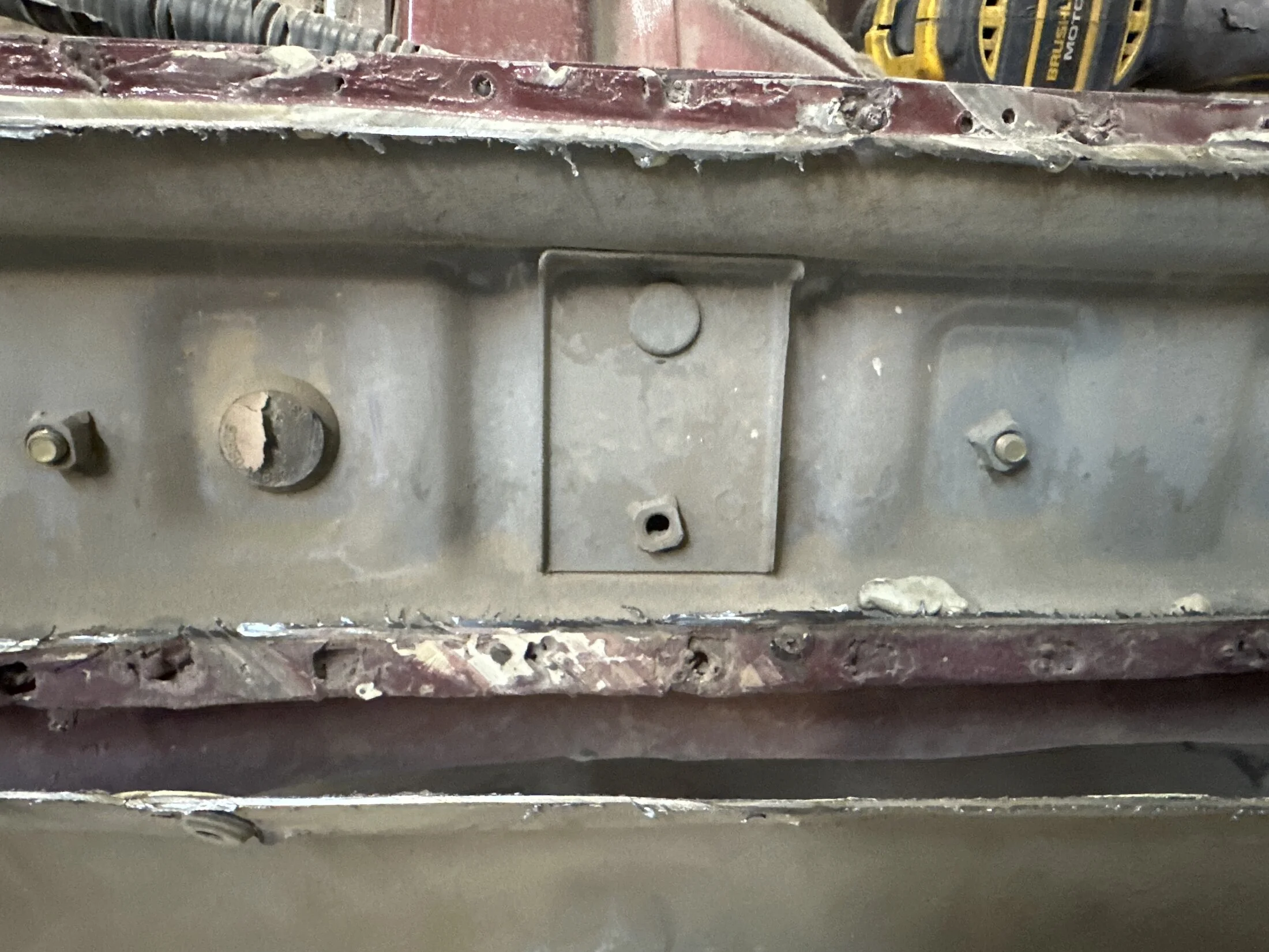

Ok, I ground off all the old weld junk and cleaned off the edges. The front and center of the inner rocker is pushed in from the crash, so I will next be attempting to straighten it for the new rocker to be installed. The lower B pillar, as a result is showing signs of it too being pushed in a bit. The door shuts too tight. Hopefully it will push out without much of a fight.
I love to see it done right, there is no substitute...however, if Brett stoves it in before sliders go on, he'll never hear the end of it. (from me anyway) :rofl:
Sliders were on before it went to Kelly! There’s hope!
He probably opened a fresh tub of bondo, dumped the whole tube of hardener in and went to work🤣
