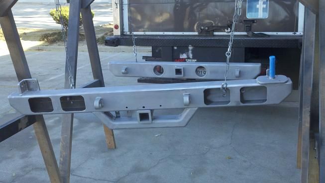

Took the bumpers to the media blaster to get cleaned up. Then I laid down two thick coats of DP90, almost ready for some U-Pol Rapture.

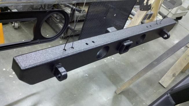

Days 124 & 125
I got the rest of the parts cleaned up from the media blaster. Next, I laid down two coats of DP90 and then two coats of SEM single stage hot rod flat black. Then I finished the bumpers off by prepping them and then spraying them with two coats of U-Pol Rature, they are finally done!

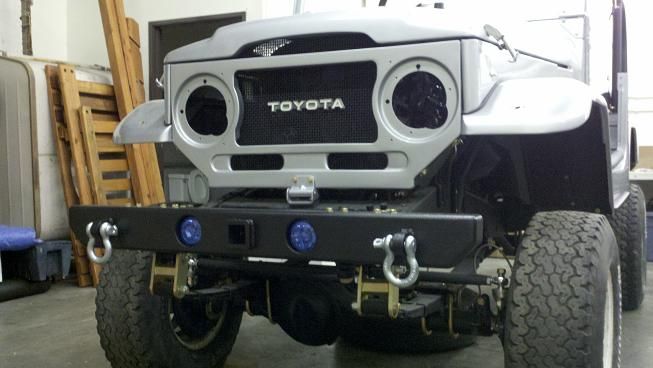

Day 126a
I applied some Xpel (headlight protection / blue tint) on my fog lights, see picture below (left untreated / right treated). Next I install the lights on the bumper and mounted it to the frame using all factory bolt locations.
Then I installed the running boards, I used some left over fender welting so they would not scratch the paint. Next I bolted on the windshield bumpers and latches.

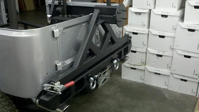

Day 127a
Finally got the rear bumper fully completed and assembled and now it’s ready to be installed. Check out the hide-A hitch with the IROC license plate holder. Then I installed in some new seat belts from CCOT.
Day 128
Installed the rear bumper using eight 9/16 grade 8 bolts. Everything lined up perfect and is solid as a rock. The last picture shows a 30” tire and wheel combo, it is sure going to look good with a 37”. Thanks again everybody for all the support, it keeps me motivated!
