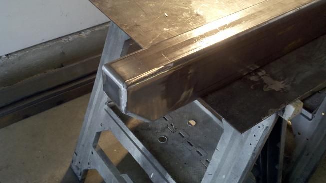

I finally got back to work on my bumper project. I started off by capping off the ends of the 3 X 5 X 0.25 rectangular tube with a 45 degree angles.
