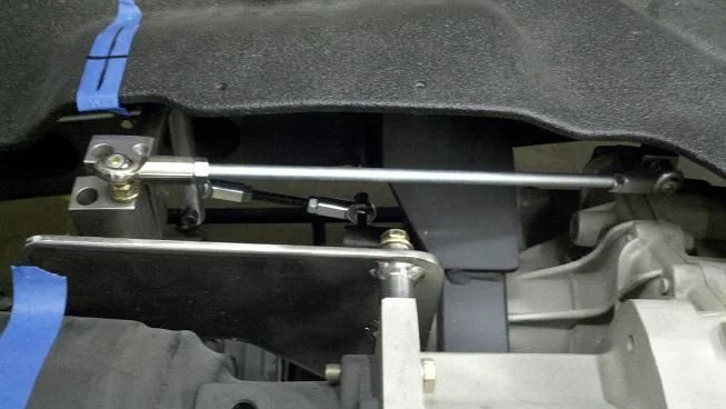

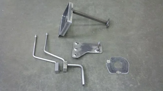

The next project on the list was to fabricate a shifter mounting plate for the twin stick set up. My goal was to place them dead center in the original location. Then I cleaned up some roll bar pads, re-tapped the threaded holes and mounted them up.
