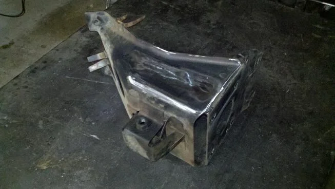

I finally got some extra time. I ended up finishing up fabrication on the front bumper. Not to bad for my first bumper project, I love it when a plan comes together.

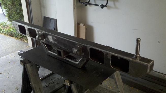

Started fabrication on the rear bumper / tire carrier. Everything is constructed out of 0.25” or thicker mild steel, kind of over kill but well worth it. I call them (F & R bumpers) Civic crushers, because if a Honda Civic hits them, well its self explanatory.

I cut all the pieces for the tire carrier, mocked them into place and laid down a few beads. I’m glad I ordered the 1500 lb spindle because this thing weight at least 75 lbs by its self.

I fabricated some fog light mounts for the front bumper. Next I added some wire mesh and a trailer lights plug mount to the back side of the rear bumper. Finally I assembled the completed rear bumper with tire carrier.
Nice work. They look very heavy duty and I think you are right that any small car would not like getting hit by either one.
What type of tail lights are you using in the rear bumper? Are these the type they use on some Frito-Lay or UPS trucks?

Can I ask a noob Q - what is the purpose of the press? I'm assuming its because the cylindrical piece is a tight fit? If so why so tight? (sorry, dont know how to quote to include the original pics)

@ Soup, you are right it was a really tight fit. I used a hole saw to cut the holes and the OD on the tube was the same size as my bit. I didn’t want to spend a long time grinding the hole so it would fit easier. I just decided to press them in.
