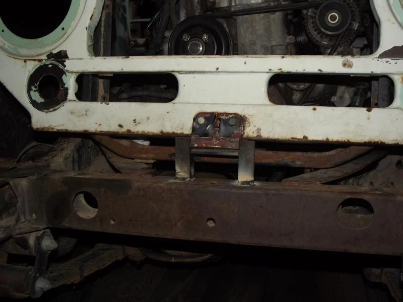

Brock and I got the front bib mounted and the radiator bracket mounted. slow going since I have little time to work on it at home and can't transport it until the motor is mounted in, which is the next step.

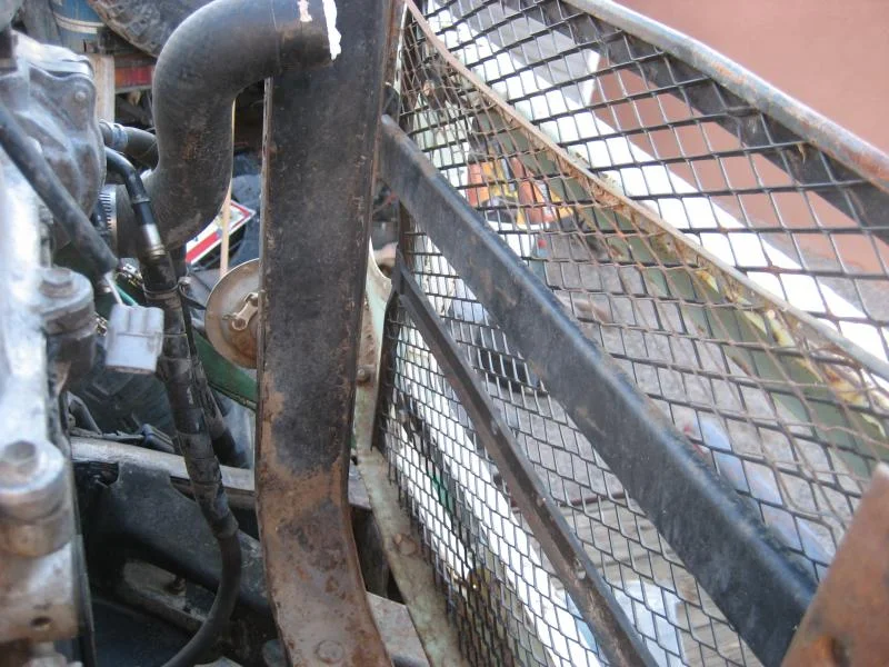

well, Brock has been bugging me to start working on this again. yesterday he ground out a notch for the new radiator (aftermarket) and open up the drain plug access, then cleaned the rusty nuts in the rad mount. next up is mounting the new Taurus fan.

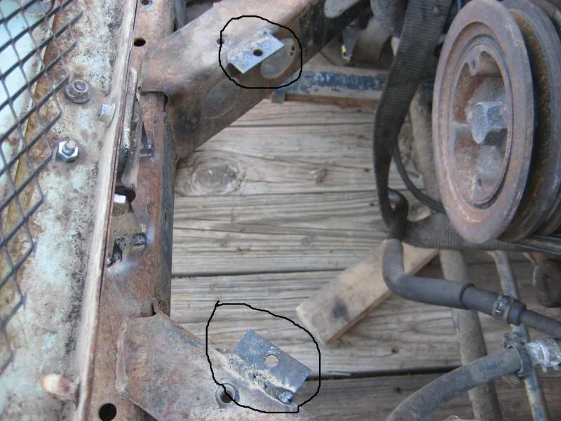

slowly getting more done. Brock pulled the frame mounted hard fuel lines since they have to move to the driver side. front motor mounts are tacked in. we used body mounts that were cut off the rear of the frame. very minor mods and they fit great. I don't like the penetration I got on the tacks, so the ratchet strap will stay in for support for the time being. next up is transmission mounts. they should go in tomorrow.
