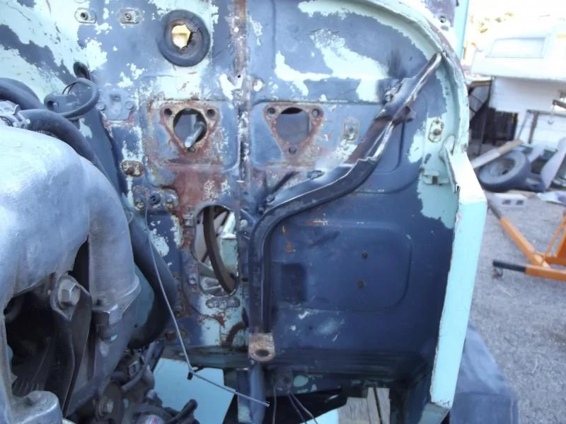

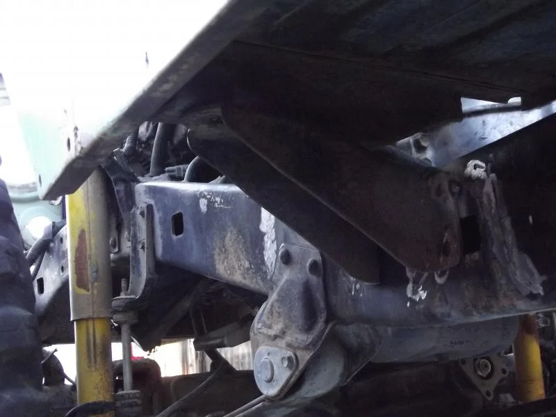

lots more done, but little is pic worthy.
the cab is welded to the front tub. the body mounts are tacked in, and the firewall support is cut out and partially replaced with one from the '73 body from Paul B.
still needs a floor in the tub, then finish up the mounts for body and roll cage.
