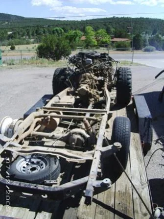

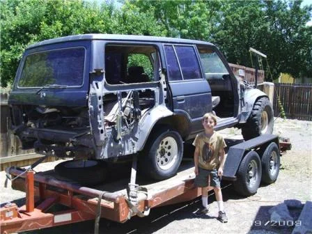

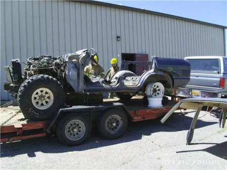

this is Marc's parts FJ60. I hauled it away for him. it took a whole morning to get it on the trailer, go to the DMV and get the title transfered to my name. of course, most of the time was spent at the DMV.:bang:
here it is when i brought it home. the tires are just what i had lying around.

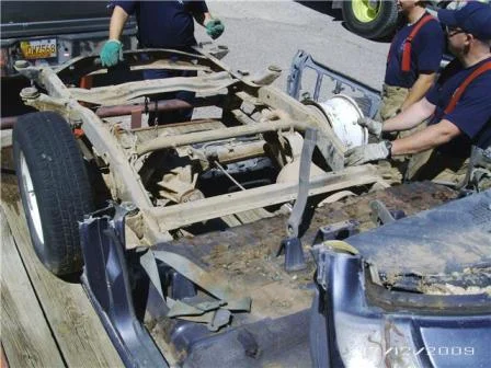

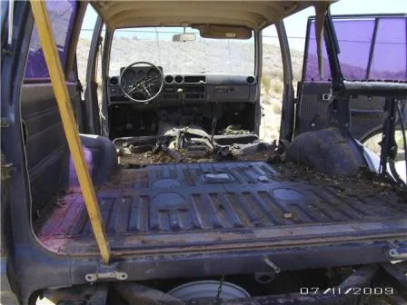

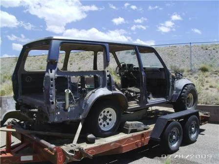

here it is yesterday, after working most of the day on tossing the junk in the back and removing the entire interior.

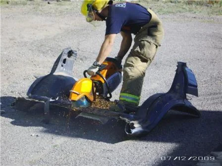

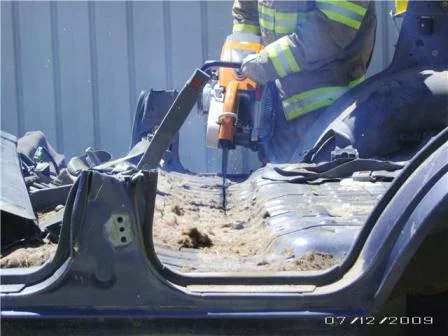

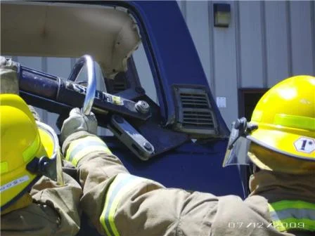

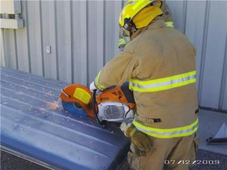

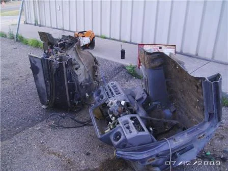

i am on OT today, so another day to work on it. and having all the cool tools to use. you'll be happy to know that it actually makes for a return on your tax money, because we usually pay for junk cars to do this to, for training. my guys got several hours of training today(I actually did the official paperwork for a training exercise too).

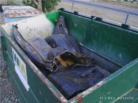

a body in a dumpster!
it's amazing how a body fits in a dumpster after cutting it into little bits!:lol::ban:

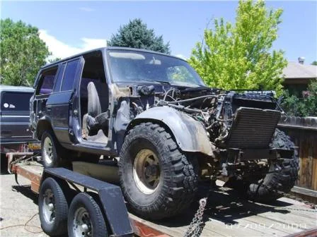

the plan is to put the front part of the FJ40 body i have onto it, and make it into a FJ45 cab. some type of custom made flat bed with the frame cut off after the rear spring mounts. drive train will probably be 350->auto tranny->FJ60 doubled tcase. my old FJ40 3'rds into the FJ60 axles with their 4.88's and lokrites.
you've seen the fast part of the build. the rest probably won't be so fast.

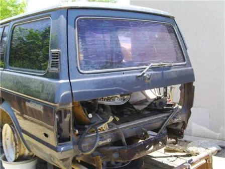

4 hours after closing the dumpster on the sectioned body, a guy from canada asked if i had the body. he wanted a rust free one...oops.:bang: of course one rear quarter was removed already.
Yeah, those cutoff saws are cool...
So are you planning to stretch the 45 cab a little or always drive with the steering wheel in your chin?
yes, and we got new blades that we were testing out. diamond all-purpose blades. about $200 each. they behave a little different, so it was good getting some practice with it.
