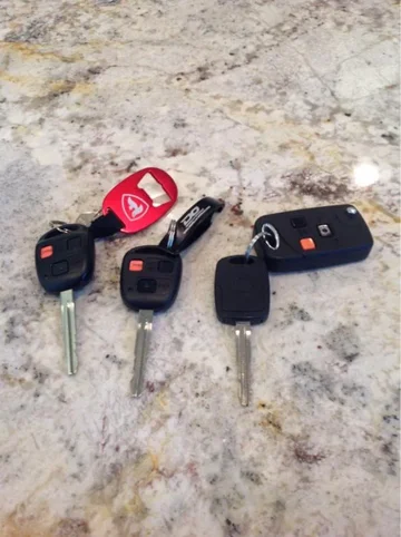

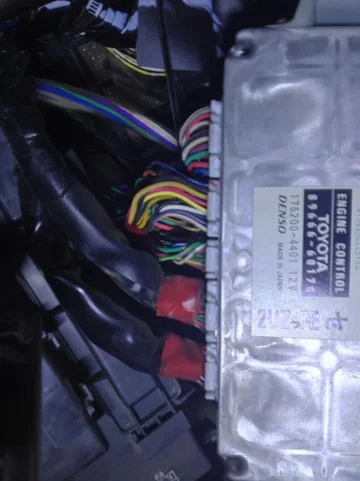

Received the ECM module back quickly from Locksmith Charlie. He communicated the entire way and turned it around the same day he received it. I put it back in and followed his instructions on his website and it worked perfectly. I now have two masters and a valet. Two are exact matches to the factory key fob I got on eBay for $89 each and the other is one the PO had that was previously a valet key. Happy Happy Happy.Sending my ECM to Locksmith Charley tomorrow. Took 5 min to take out. Although there are locksmiths in my area who will reflash the ECM, they all want $300 to $450- which is a total rip-off. I have a 2000 with two valet keys and no master. I ordered the fancy 3 button original looking keys on eBay and have them cut and will set them up as two masters once I get it back and set up the other two keys as valet later. He quoted me $150. I have this feeling it is just setting a jumper pin on a circuit board to clear onboard ram- but I'm just guessing. One guy local would do it for $200 but I had to have it in hand and track him down and meet him when I was ready- Houston is a pretty big area so that was not a good option. Note that some locksmiths have the ability to clone your valet key transponder using some type of device. The local quote was $125 for two keys to do this so if you just want more working keys without sending in your ECM, this may be an option. Sounded sketchy- but two of the 8 locksmiths I called said they could do it. So this will all cost me $350 for two keys and reflash. But I'm in control of which are masters and it clears out all those others floating around out there. I guess a little cheaper than the $500-$550 for the keys and $100 to install the "free" ECM. I read most all this thread and the statement that any key can be a master as long as it starts your truck is not true as pointed out by Beno and Dan and others. You must have the master to program or even clear other codes or you must reflash ECM and then those keys could be set up as the master.
