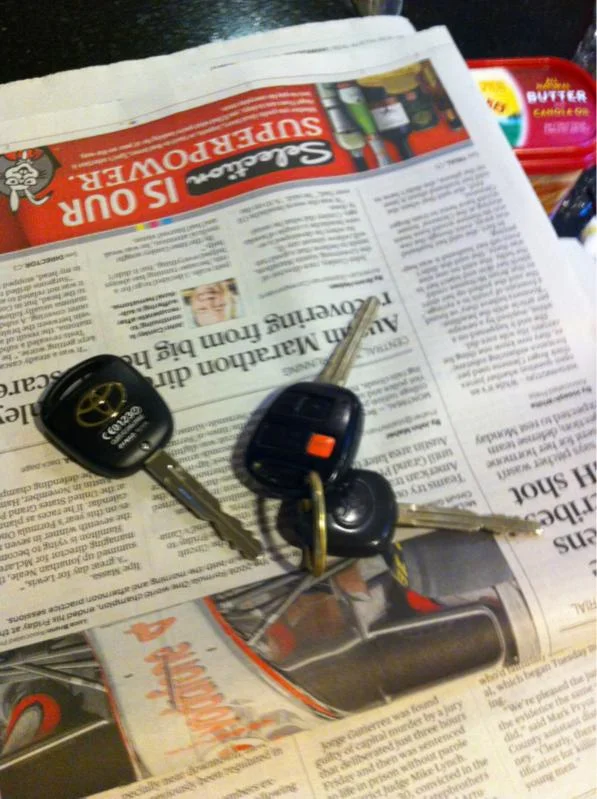

Hit the deck for a 1999 and just order a couple of three button keys off eBay. Truck came with a master (light goes off instantly) and a valet, going to try to add two more keys for good measure. Will report back, great thread.
Ebay keys worked great for me. I ordered the $8.99 free shipping plain transponder key and had Lowes cut it. First one worked like a charm. Lowes screwed up the second (they never charged) so I chunked it and bought another. Third worked as good as the first. Then I got home to find the seller that sold me my cruiser mailed me the other three button remote key! Now I have two remote keys and two working plain keys!
New 3 button key arrived and I stopped by the dealership to pick up parts for both LC's. Dealer cut the new key for free and this morning I used the steps from this threads 1st post.

I'm not sure how your '00 differs from my 99, my light is on the console where the radio is, I'd run out and shoot a pic but I bought my 99 for service at a second home. IIRC one of the posts in this thread shows the light.
Found the light. Hard to miss really. It's a red blinking light shaped like a land cruiser. When I got in the truck and locked it with the remote, the light went on solid and went out immediately when I put the key in the ignition. Yes!! I have a master key.
