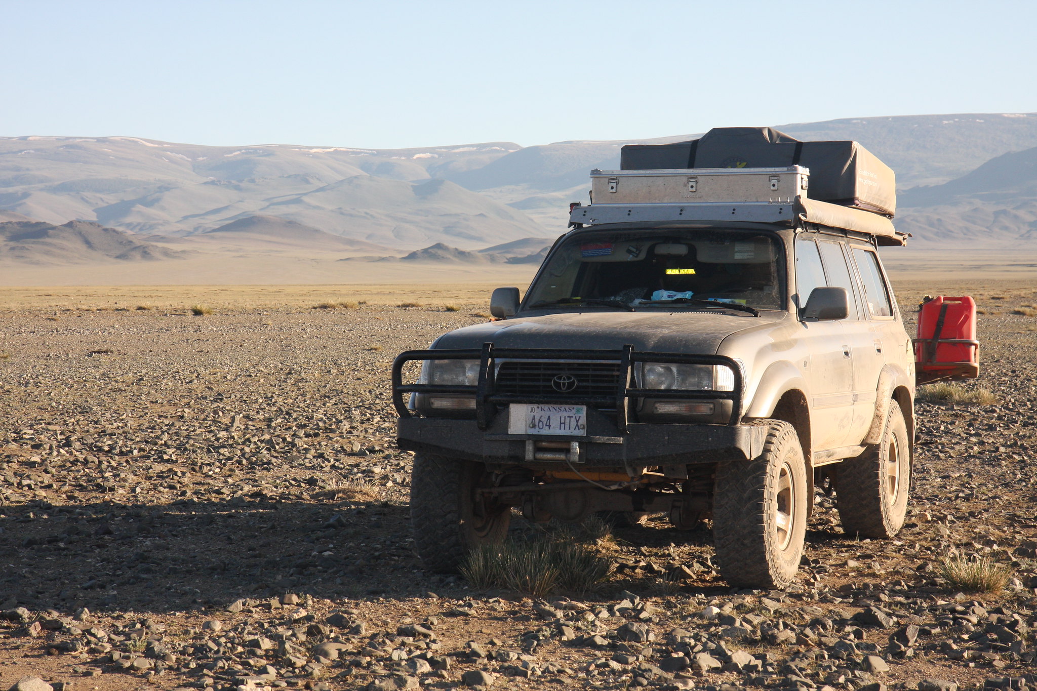

We had the Prinsu roof rack for road trip in Asia/Europe and it hold pretty well. Sometimes the brackets were getting loose and I had to tighten it little bit but that was all. I would really recommend this roof rack to everybody.

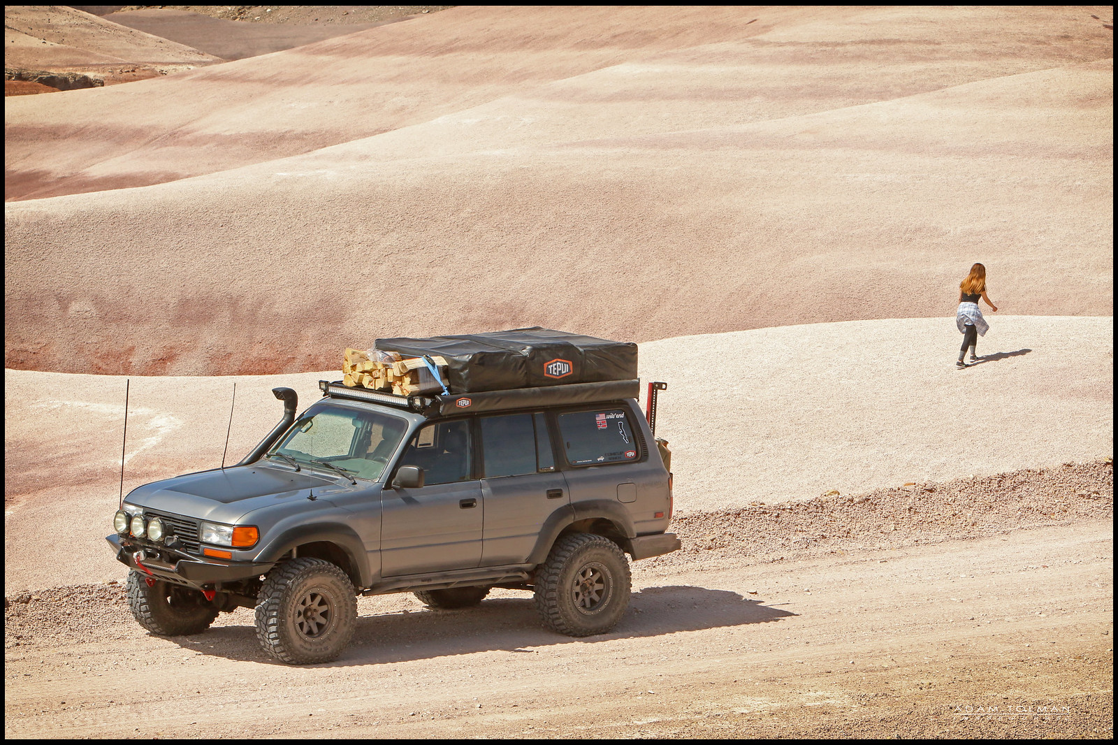

I've usually had the tent mounted closer to the rear of the rack. That has left me room in front for other items on the rack or room to use the sunroof opening.
Untitled by Adam Tolman, on Flickr
However the tent I have now covers most of the rack so it's still mounted to leave a bit of room at the front. It's been a good place for firewood etc.
IMG_0189 by Adam Tolman, on Flickr
I hope you have good liability insurance because the way you have that wood secured in the last picture is very dangerous.
haha! why!?
We were in a remote location. No other traffic to worry about. We weren't on public roadways with the wood in that location. It was only put there once we were on the dirt roads. Never saw another person on that trip. Besides it was secured well. We were driving quite fast on rough roads and not a single piece of wood ever moved.

Looks like this pic was about three hood scoops and several sets of tires ago....(and a bunch of other mods too I'm sure).
I guess the better question is: are you still running that light bar set up that way? Looks like no prinsu cut out wind deflector, and just bolted to the front of the crossbar? I was contemplating that same move recently. Do you get any additional wind noise, I mean assuming you're not carrying a bundle of wood and an RTT, 12 shovels, some axes, an awing and a snorkel? Never-mind, this is a dumb question. LoL. :cheers:
I took my wind deflector off for a trial run last year and wasn't much worse noise-wise on the highway, but if a lightbar was whistling up there I'd go nuts.

yeah, that pic was a little bit ago. But not that long ago.
I have a 42” lightbar mounted to the wind deflector using the standard lightbar mounts that came with the lightbar. I mounted it so the top of the lightbar is level with the top of the rack.
I did not have any additional windnoise from the lightbar. Recently I replaced the lightbar. I had an odd noise that sounded like it was coming from the base of the windshield. I chased it for weeks trying to find out what it was. One day I opened the sunroof and put my hand on the lightbar when the noise was present and it went away. The new lightbar had a whistle at certain speeds. I made a small tweak to the angle of the lightbar and the whistle was gone. No more issues.
