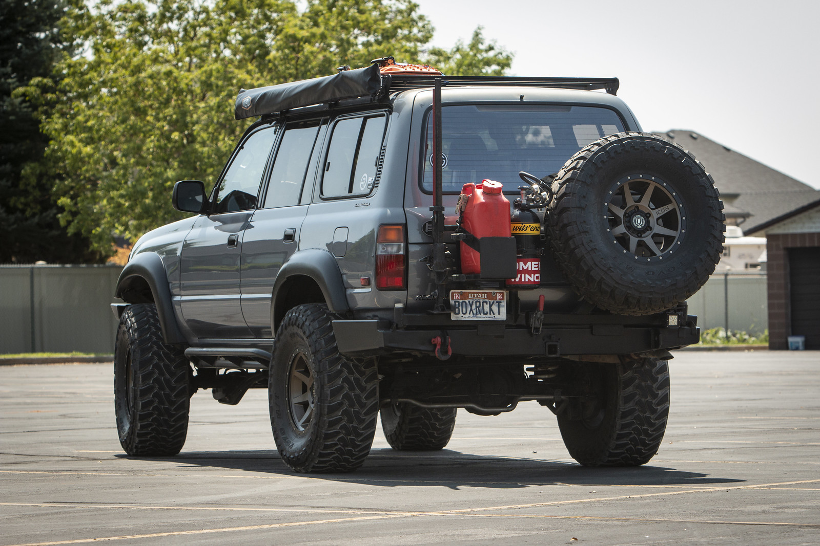

Anyone recently install an awning on Prinsu rack? What kind? How did you mount?
It wasn't recently but I have a Tepui awning mounted to mine. It's just a simple 6' awning, not a batwing or 270*. I used the aluminum L brackets that came with the awning. I actually drilled down through two of the crossbars and bolted the brackets on. Maybe a bit more intrusive than some would want but the 80/20 crossbars are not expensive if you wanted to replace them with new ones. Mine has been on the truck for 5-6 years and super solid.
IMG_4957 by Adam Tolman, on Flickr
