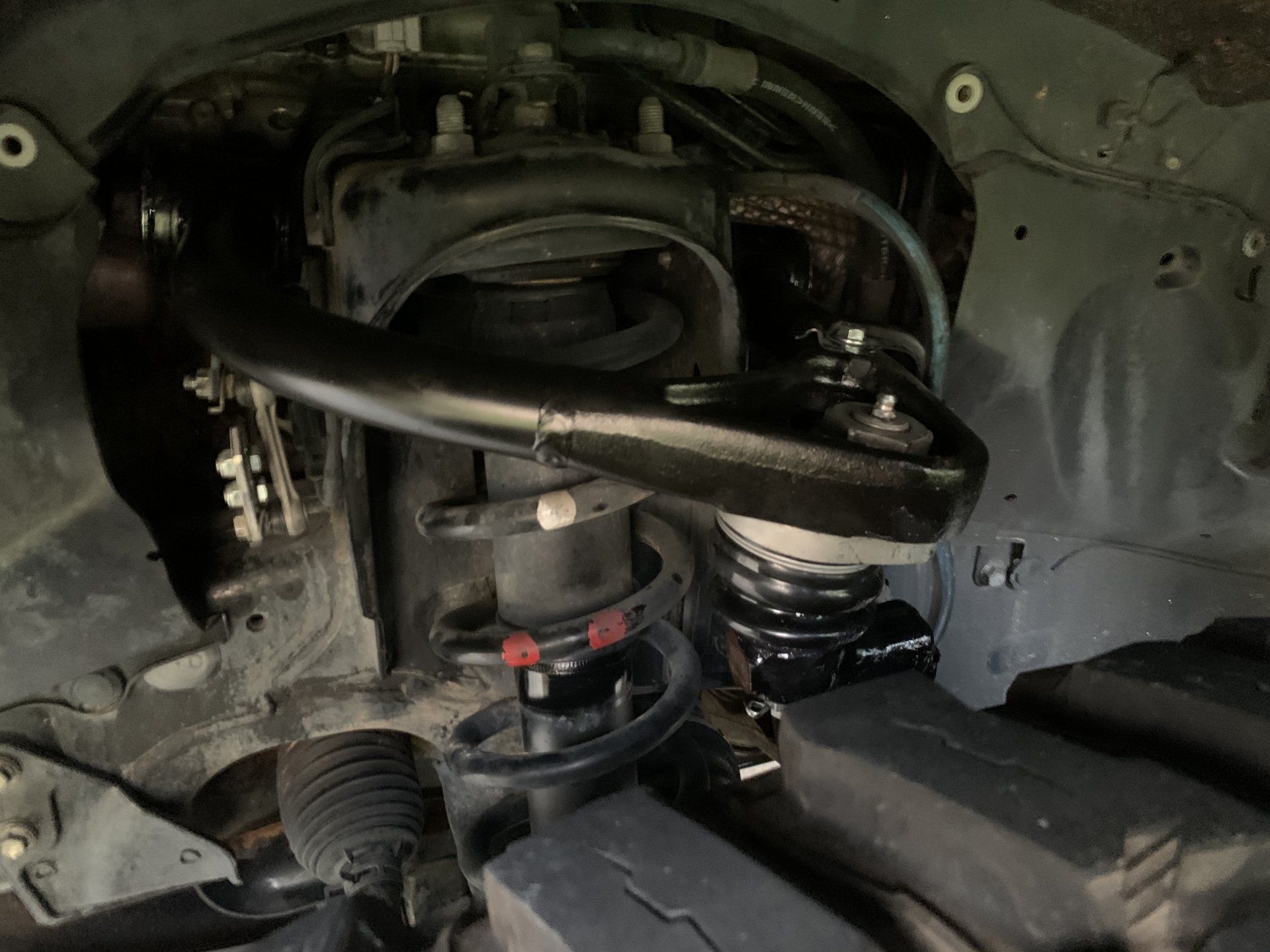

Mind sharing a pic of how you welded the AHC sensor bracket? I'd love some extra caster even with 33s.
The SPC uppers have the bracket already there! it’s not 100% in the same spot though because this thing is huge in the front now. Will probably need to rework the lift brackets I made or remove them.
@tbisaacs and I were speculating on this one night a couple years ago. Good to have confirmation @Prime
What was the reason for going with the SPC upper control arms?

Not much progress in the past few months but bringing this back up to present:
Suspension installed. Night and day compared to AHC! Don’t waste your time trying to make AHC work in my opinion...
