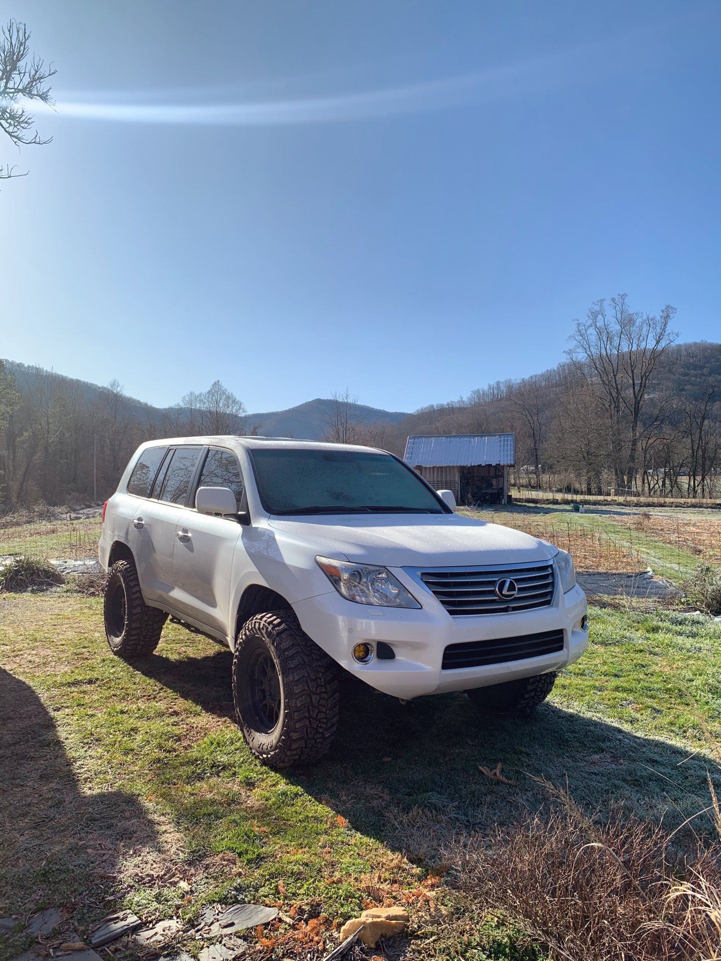

Dec 2019. First day home after picking it up from the dealer. Was passively in the market for a while so was really glad when this deal popped up. 2011 with 150k.

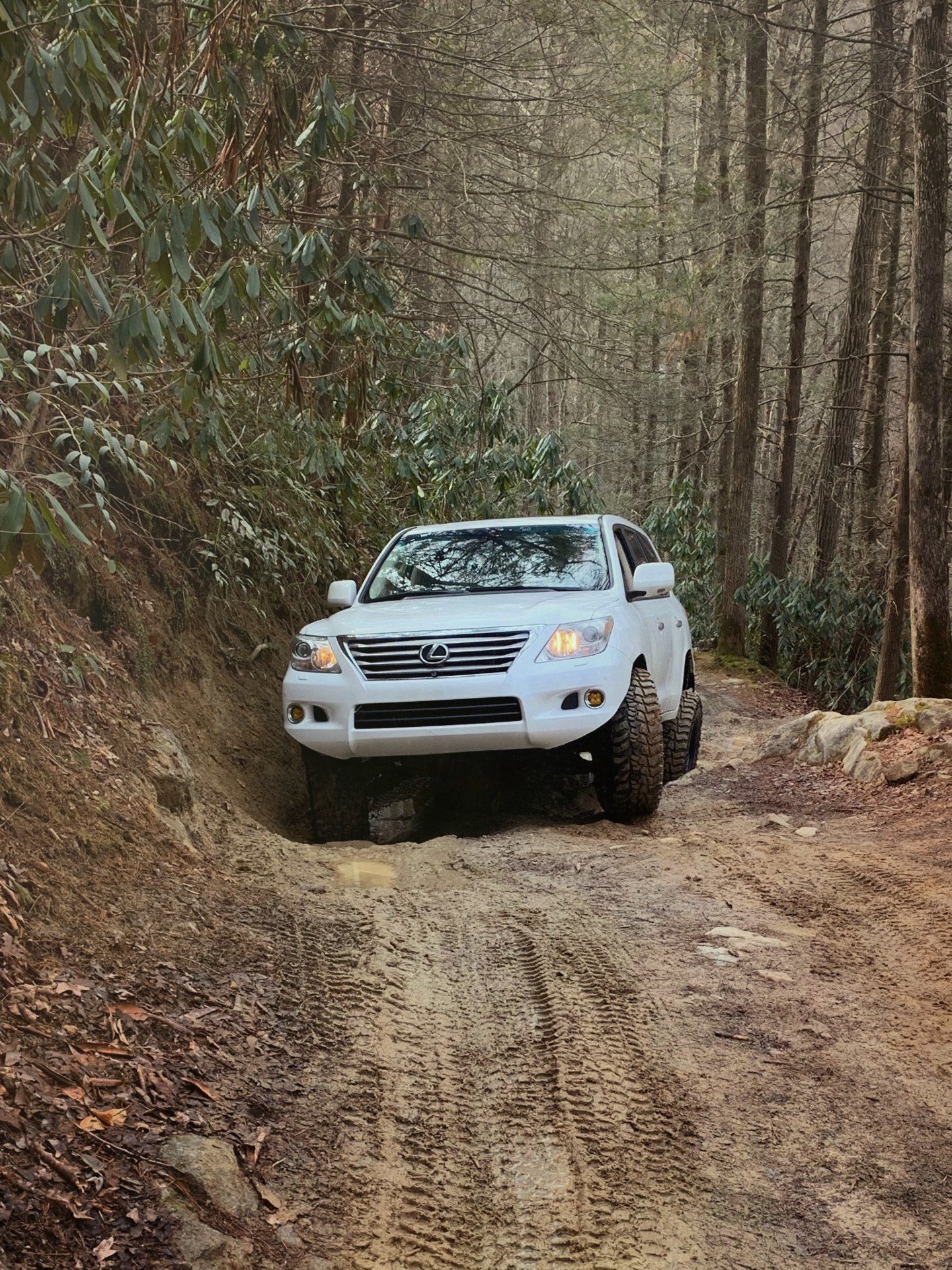

With it’s garage-mate, our Flex Dream built HJ61 imported from Japan.

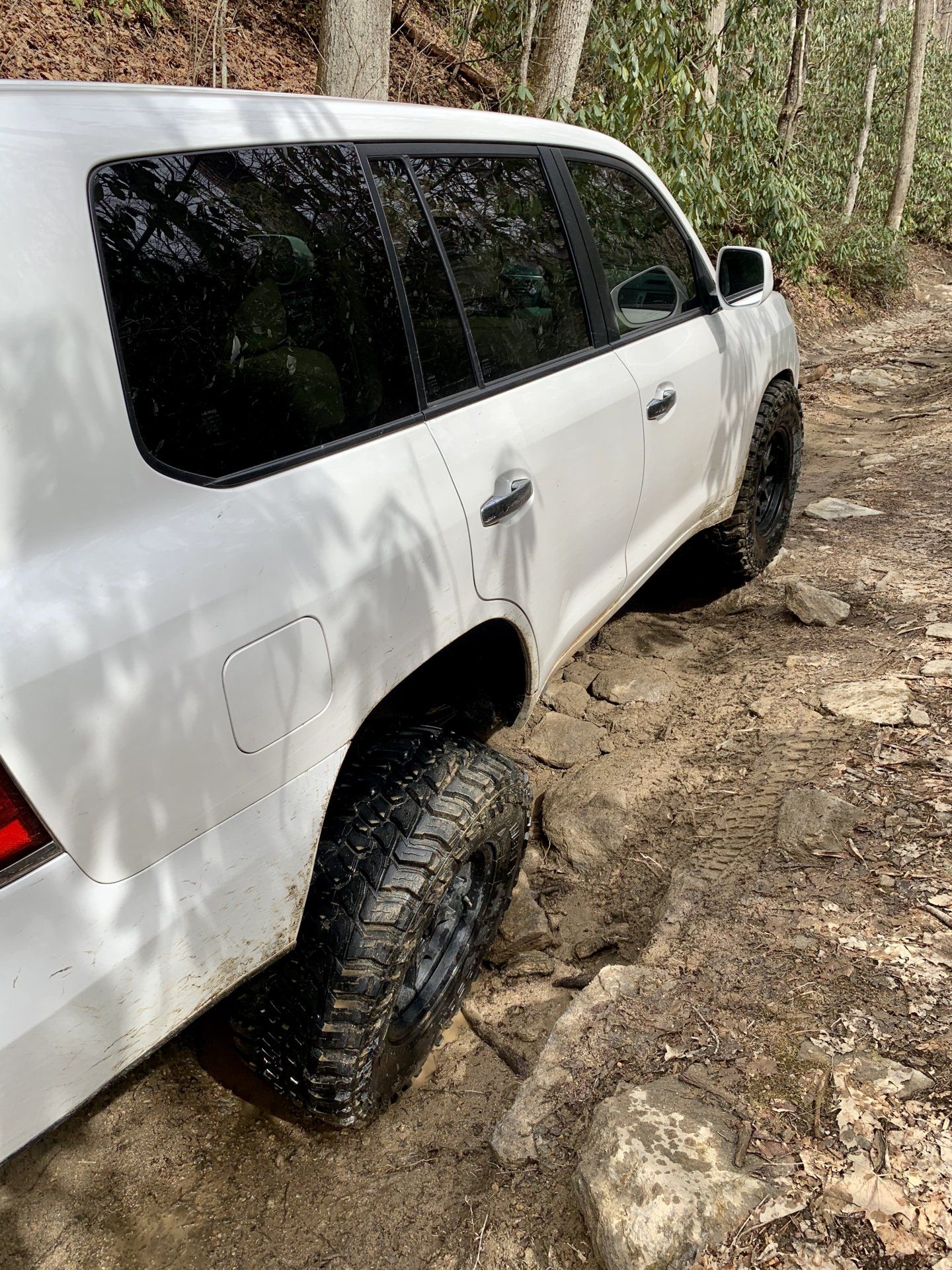

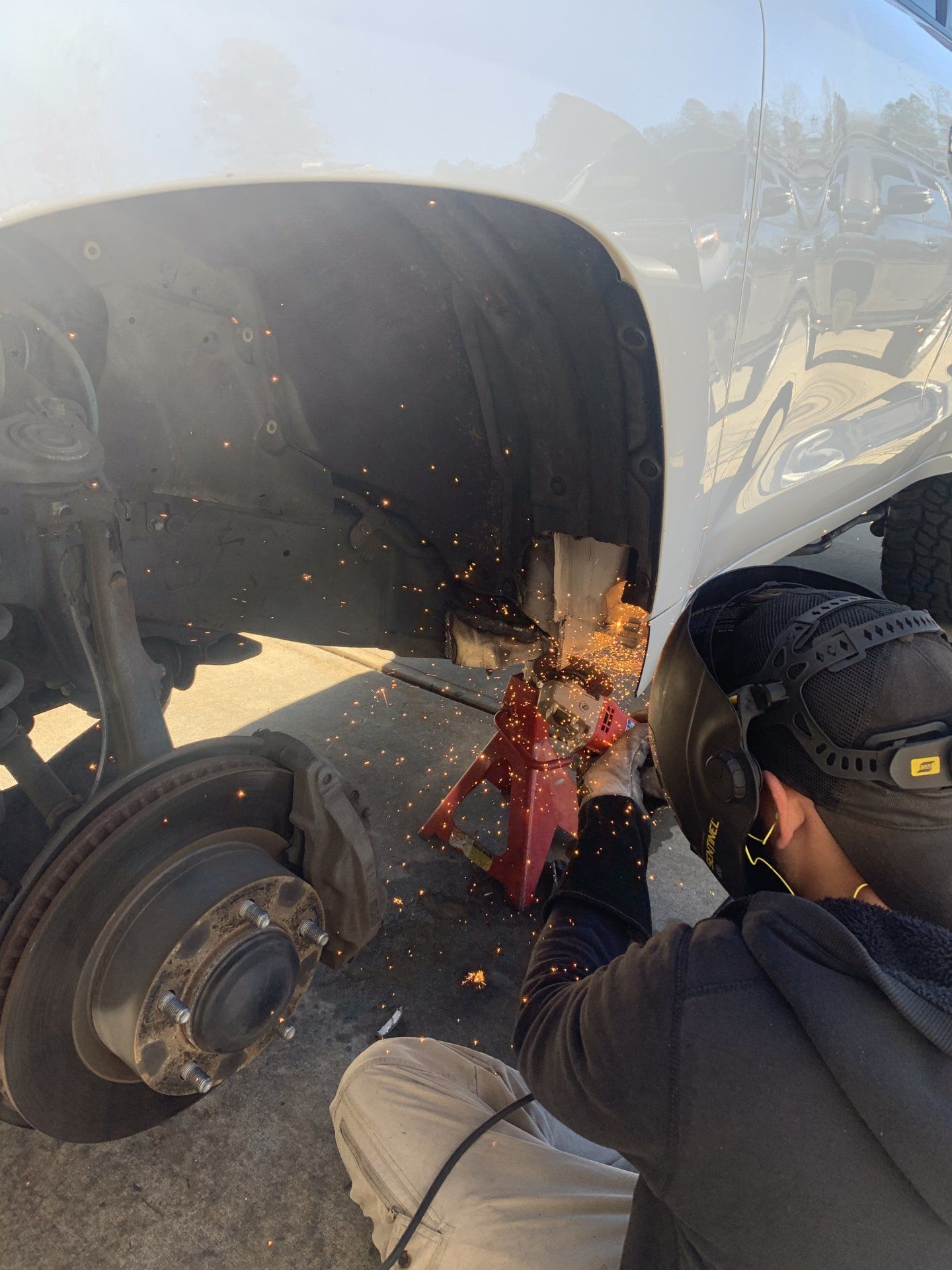

Cut both bumpers (temporary). Rear fenders hammered flat on the inside for clearance. Did a little wheeling to make sure everything functions ok.

Any concerns in your locality with the tires extending outside the fenders?
None at all, thankfully.

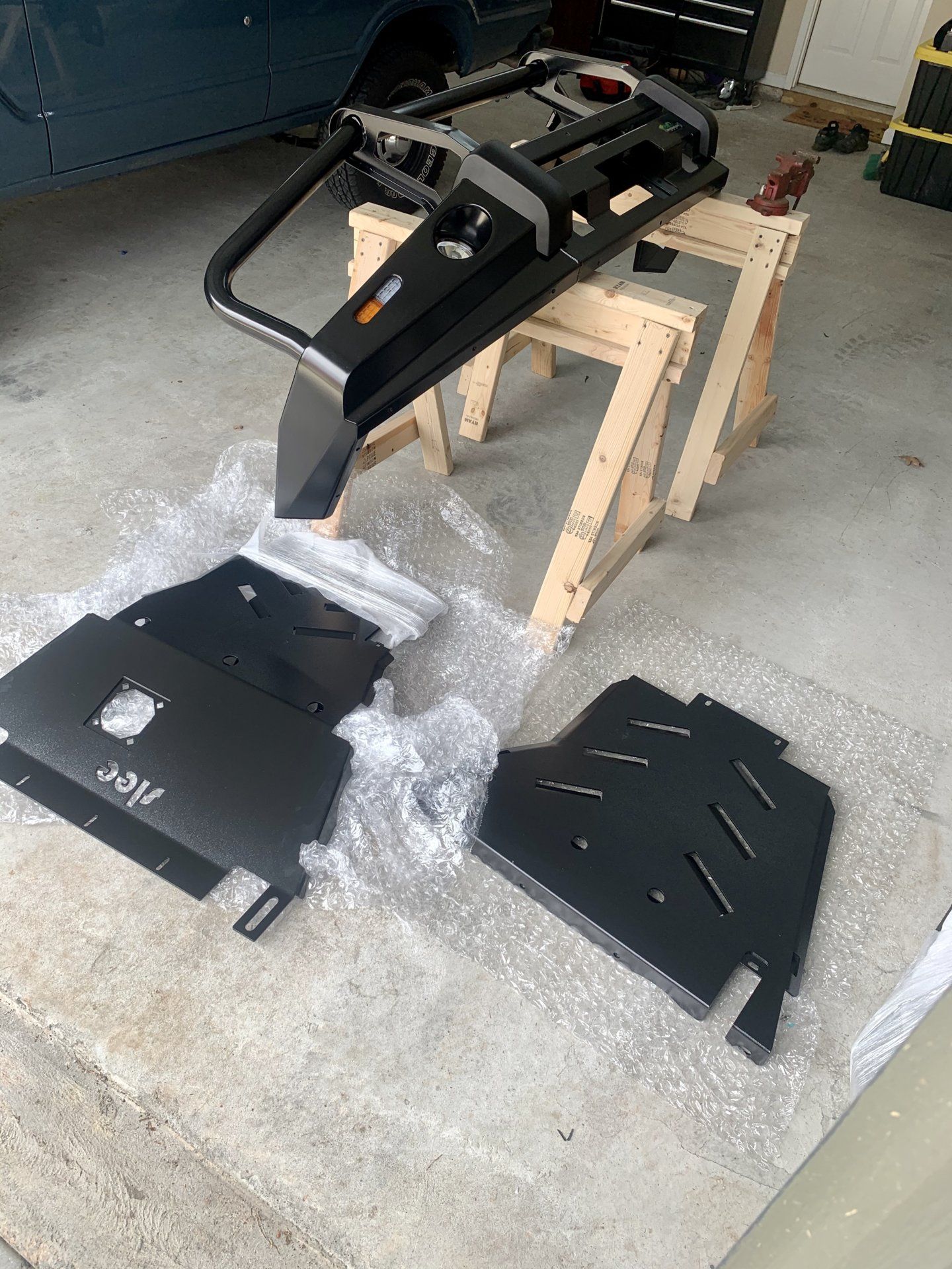

Since you brought it up... work in progress.
@Prime Man you aren't wasting any time! Curious to see what your plans are for the sliders. Are those prebuilt from somewhere, or are you fabing them yourself? Curious how you mount them to the truck (bolt/weld, etc).
Also, is that flex pic on the trail trail somewhere off the GA Traverse? Looks familiar...
