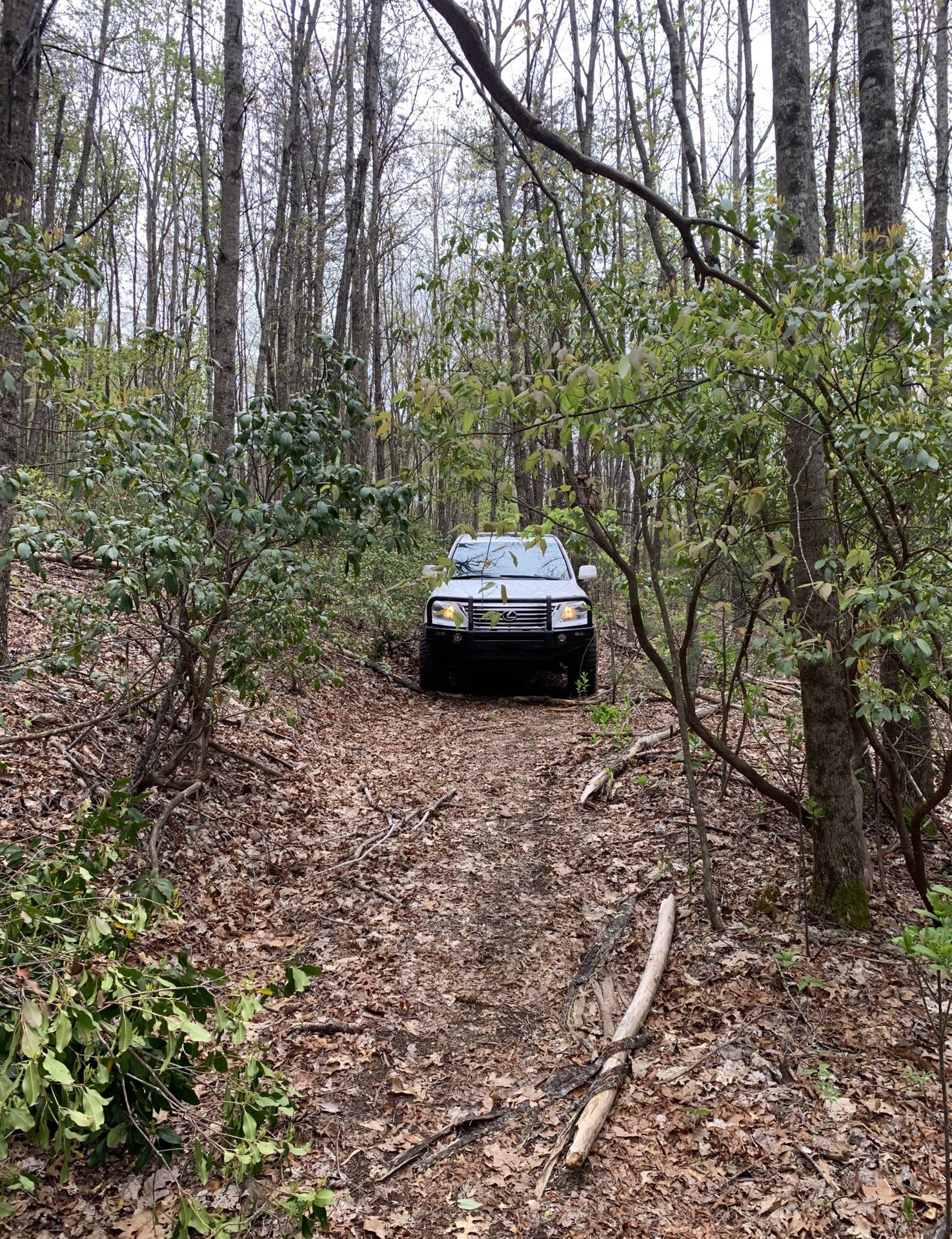

Kinda lost motivation for a few weeks with Cruise Moab cancelled and being stuck at home. Got some new part dopamine via the ARB rear locker arriving so had to take a quick trip to the mountains to escape weekend isolation. This thing is a little tight on the trails...

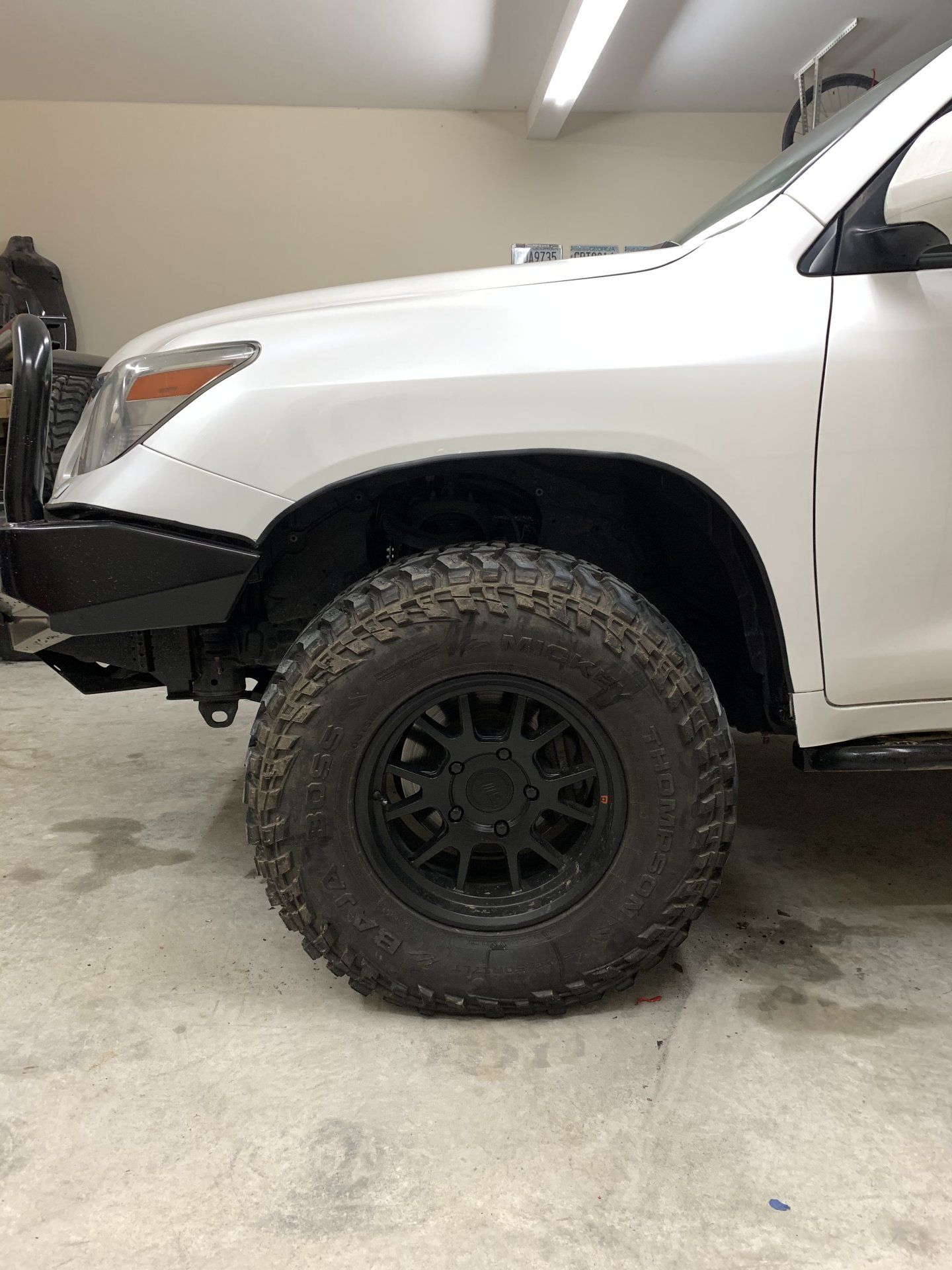

Nice build. Curious what the AHC sensor extension brackets and new ‘normal’ setting do to your alignment, and in ‘H’ how it impacts your drivetrain angles?
I am curious of the same thing. I pushed this idea off because of how adjusting sensors within factory parameters affected it, and thought more adjustment would mean even worse handling/turning radius. Even then, for me extra clearance with worse turning angles is still better than less clearance with better turning angles, but worse departure angles. My bike rack is barely getting stuck when I enter a ditch, on the way out.
OP, can you chime in on this? You don’t seem to have any issues which really makes me want to revisit this idea. I would do it with 33s still so I don’t need to regear, but extra clearance to help clear my bike rack would be great! Did you have to add more fluid to the system since you are raising it past factory parameters? I would love to see a post just on this part! It would be very much appreciated.

Those cuts look really clean. What tool did you use? I'll be installing Slee rock sliders on my LX 570 this week and need to make the same cuts.
I installed a set of Slee sliders on our LX570 a couple of weekends ago. What cuts are you making? Believe that @Prime bought the Land Cruiser rocker panels so no cutting is required to install the sliders. If you haven't done the install already I'm happy to give you some tips from my experience; parts of the install can be a real pain.
As for Prime, the build is looking great. Would love some more info and pics of your AHC bracket and mounting modifications.
@JadeMonkey I was referring to the cuts on the rockers...I thought @Prime had cut the LX panel/steps but I guess not?
I installed a set of Slee sliders on our LX570 a couple of weekends ago? What cuts are you making? Believe that @Prime bought the Land Cruiser rocker panels so no cutting is required to install the sliders. If you haven't done the install already I'm happy to give you some tips from my experience; parts of the install can be a real pain.
Hey guys, I cut the factory LX panels. I used a cut off wheel on just like pretty much everything that's been cut on it.
And I am absolutely in love with the build by the way.
The suspension setup is just OK which I why I haven't been super vocal about it. I didn't add any additional fluid but I do have spacers to install front and rear which could offset some of the pressure and make it better.
