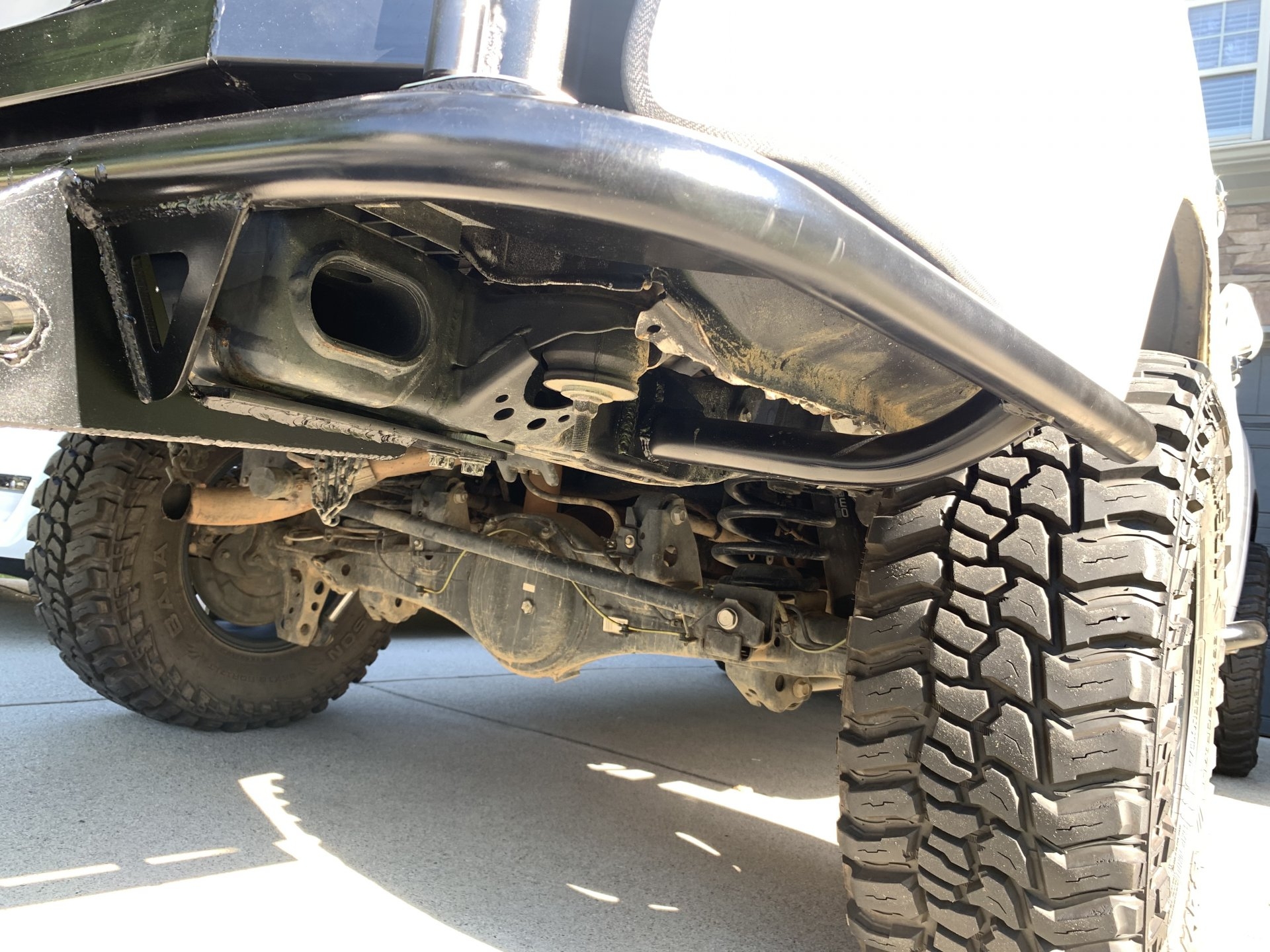

Finally got the rear bumper done. Simple high clearance dual swing out a local shop helped me put together.
I ran my exhaust similar to that on the GX for two years without issue, I did the same on my Power Wagon as well.
This build is awesome. Wheels, bumper, all looks good.
What OME's are these, just the standard ones from the LC200 version? If so, did it require fabrication, and do you get a errors/warnings with the AHS disabled?
OME BP-51 for LC200. No fabrication needed. AHC can be disabled by unplugging the module inside the driver quarter panel trim piece. I do have a light on for the adjustable headlights but haven’t really worried about it much.
Im likewise interested to hear if you get any exhaust smell. I planned to have some tube welded on as a resonator delete but that’s pretty darn simple.
No exhaust smell. I plan to tuck it up higher at some point but hasn’t been an issue.
