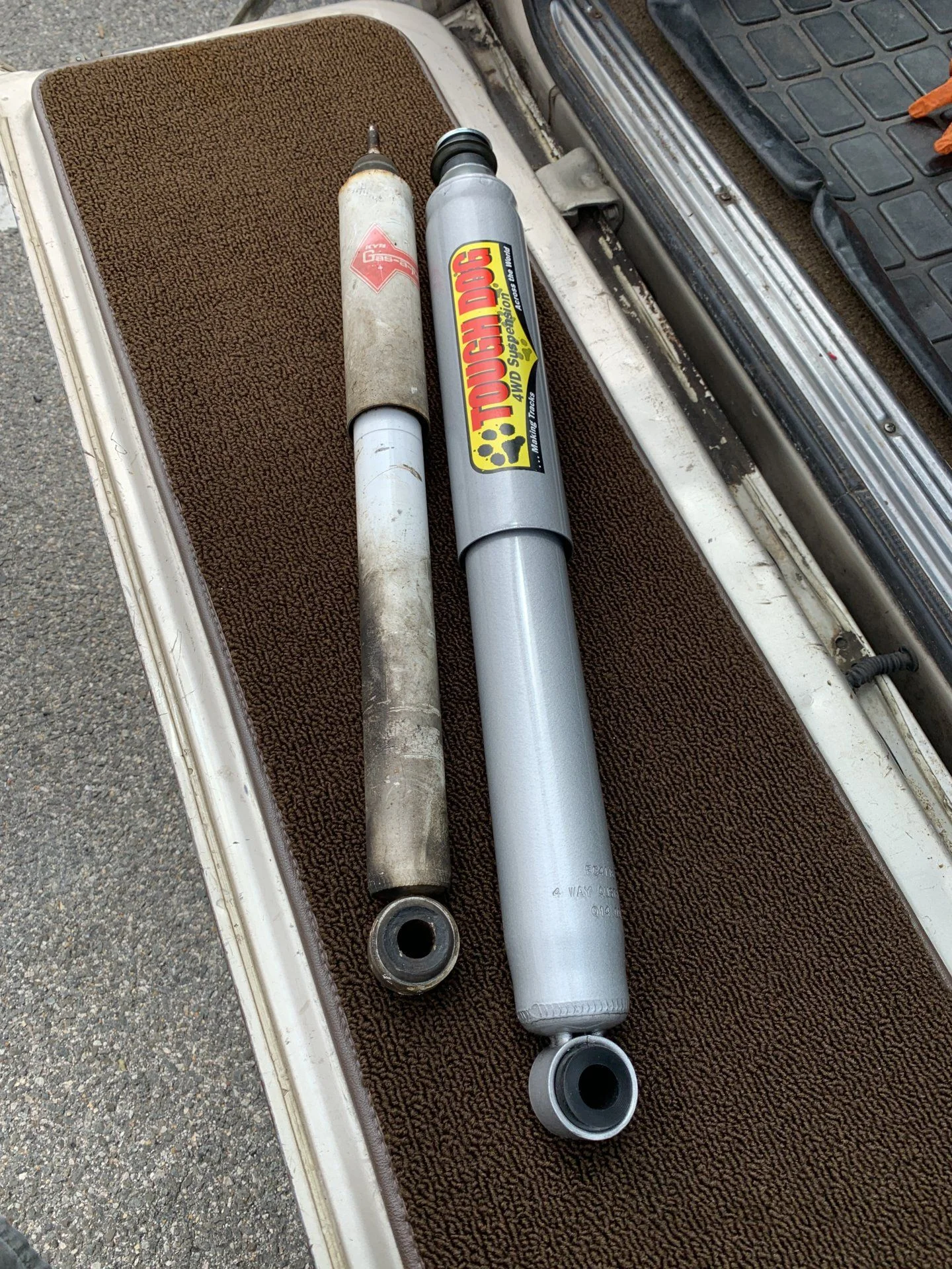

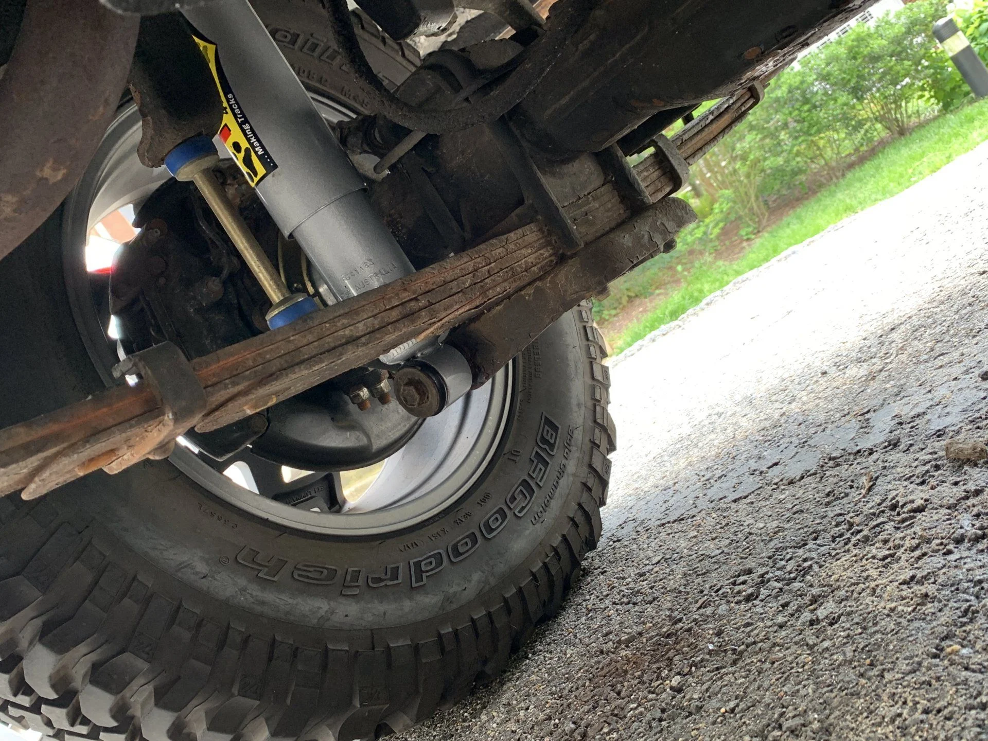

Couldn’t make it to tech day Saturday but managed to get the front shocks in before having to pack it in. Will get the rears in one night this week.

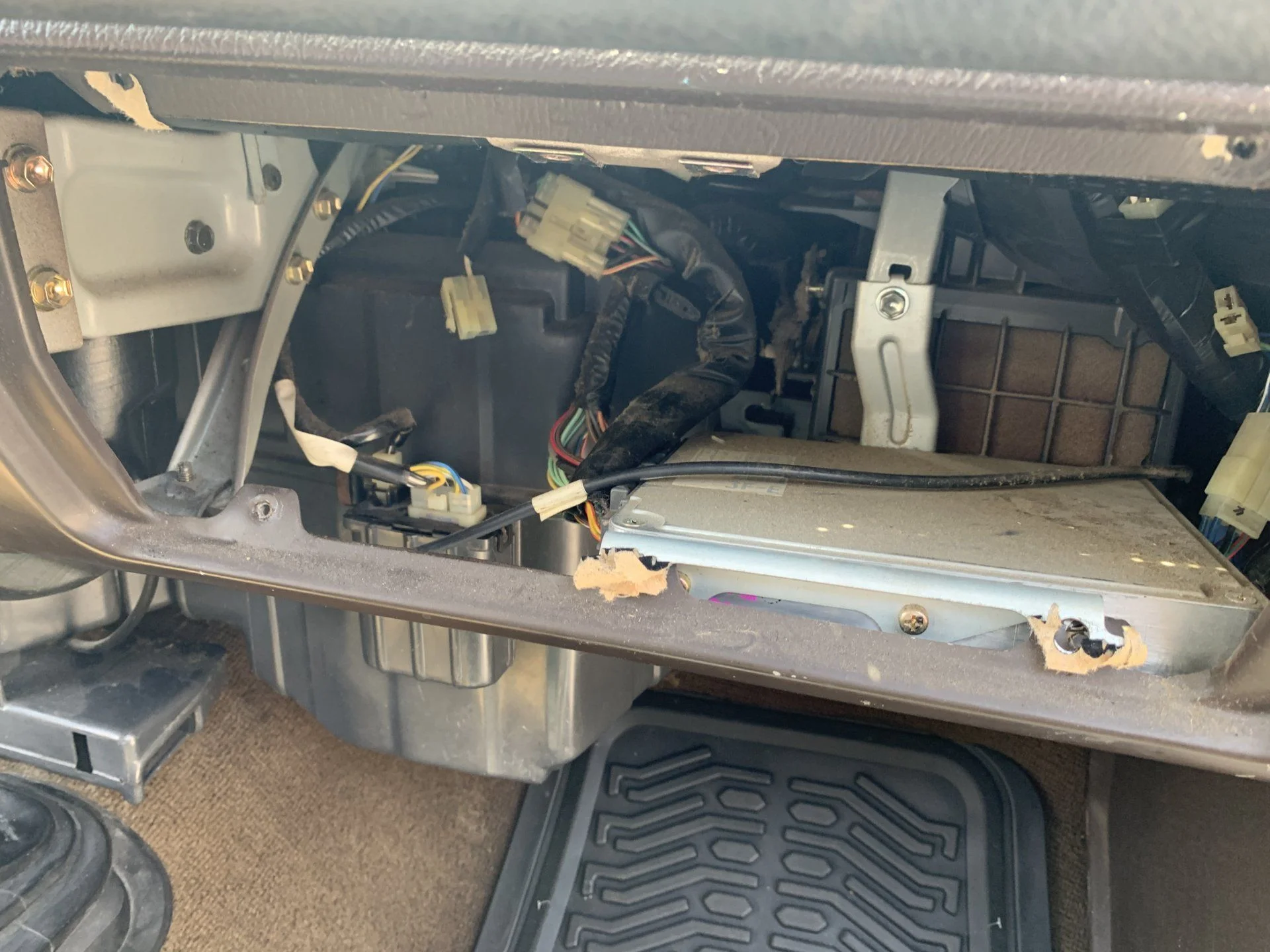

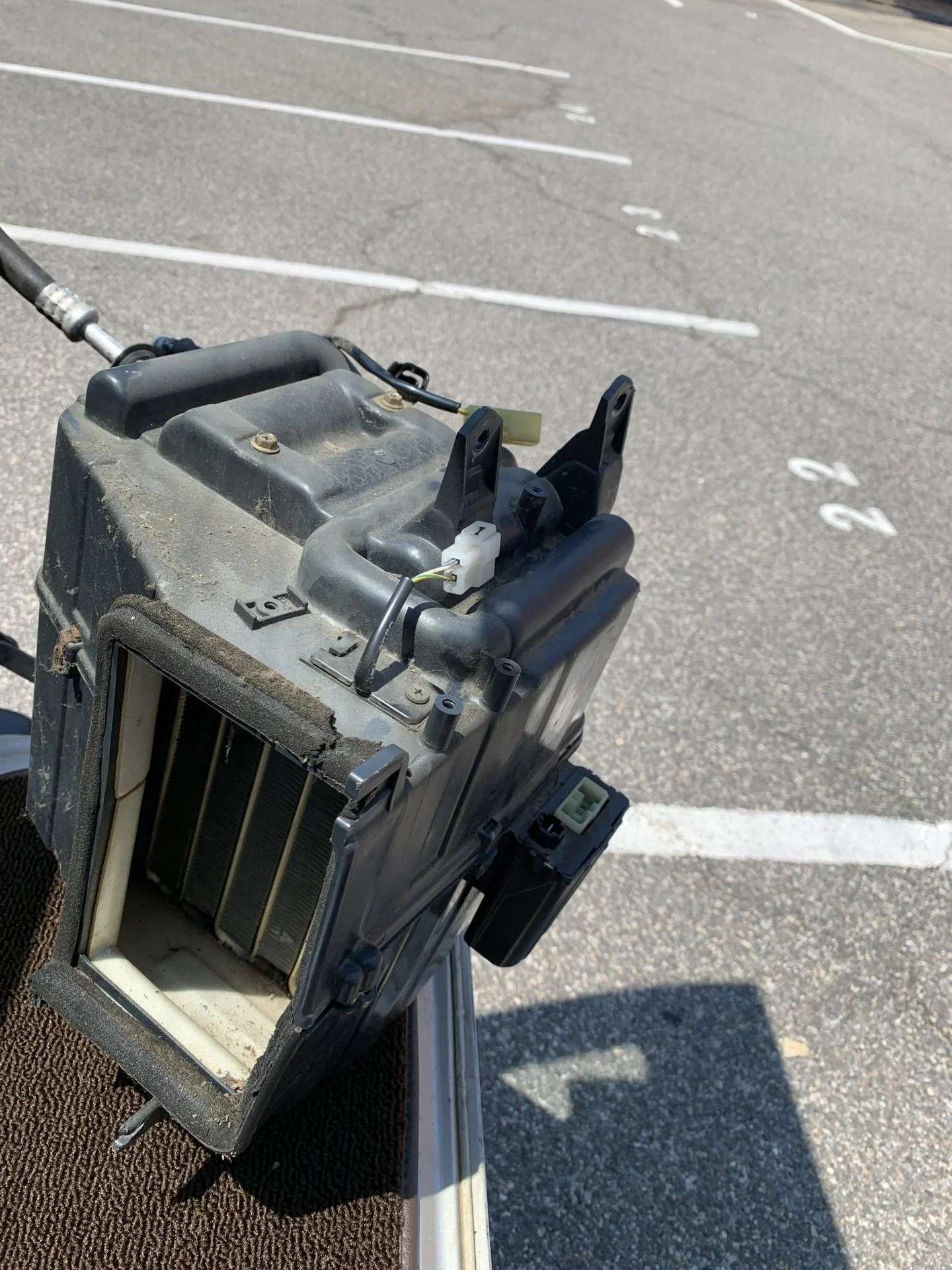

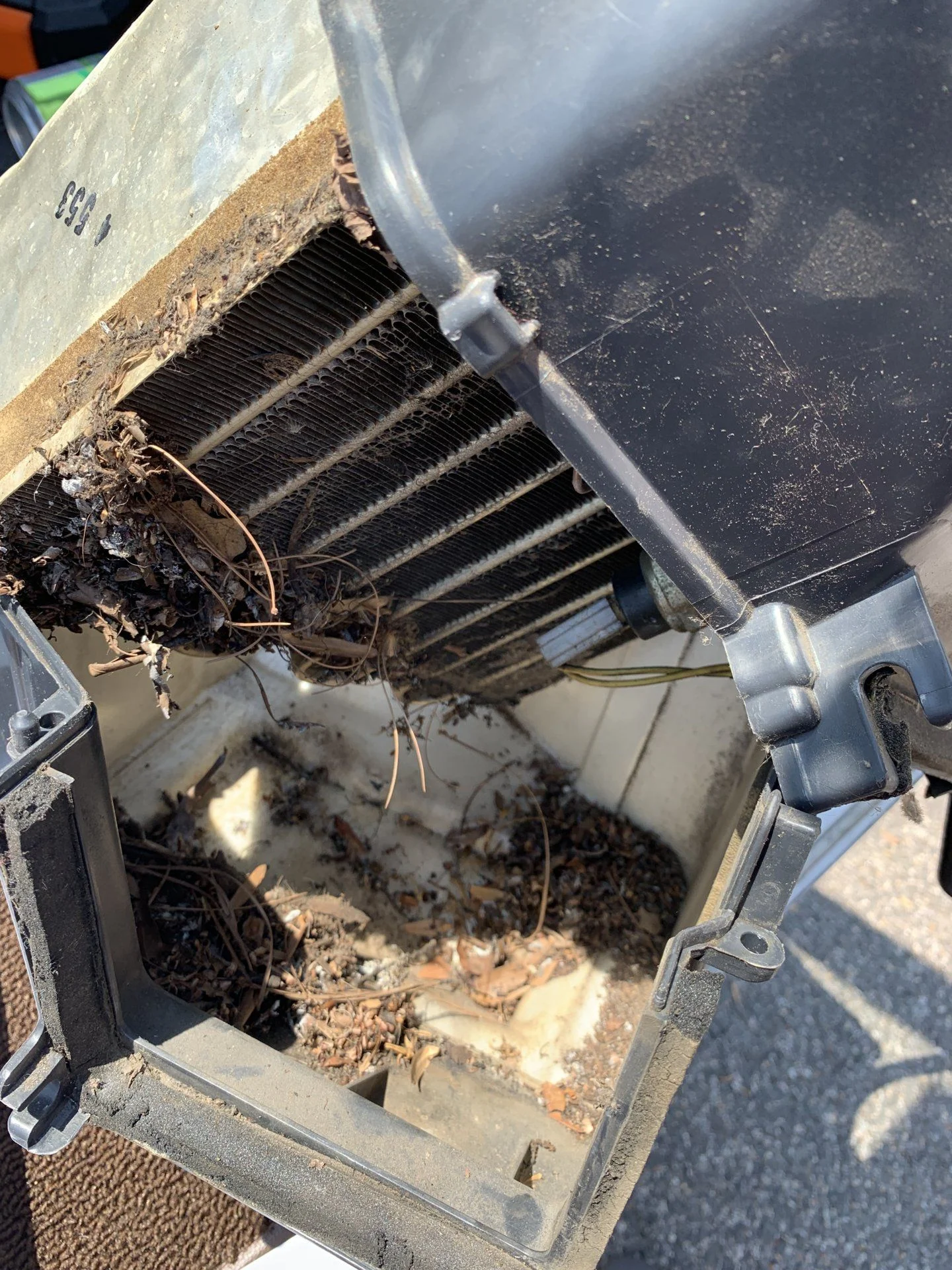

Since it was the first hot weekend I was more interested in focusing on the AC today. I rebuilt the compressor last fall, put in new o-rings, and dryer. No luck. Despite adding dye I was able to find a leak. In March, I ordered all the parts to tear into the parts under the dash (evaporator, pressure switch, and expansion valve).
Got everything removed and the biggest pita was the high pressure line fitting where it goes through the fire wall. Feels cross threaded despite looking like it had never been touched. I didn’t replace the o-ring in it because I didn’t want to fight it then. Can I chase the threads? Is there a good shop that could put on a new fitting?
And summit racing, apparently it came straight from denso though, sent me the wrong evaporator (476-0072 but sent a 476-0027). So I wait :bang:

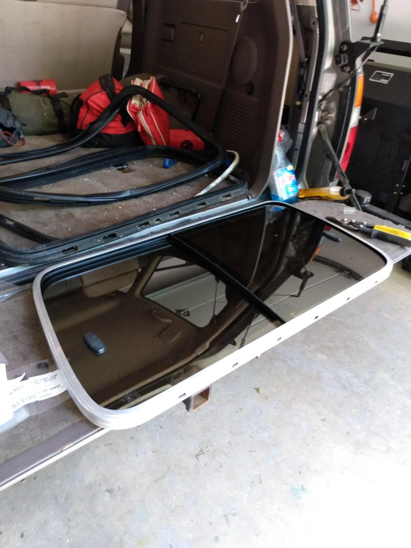

My new rear quarter window frames came in this week. Got the window we popped out at tech day put back together ready to be roped in. Never roped a window in so might be soliciting some help if anyone is willing. Hopefully I'll be able to get DS window out without @davesax36 .
Edit: And now both sides done. I now know what @OTRAMM meant in his video about the outer weather stripping being a pain in the ass. A set of cheap picks from HF with the hook ground down and smooth did the trick. And a cup of soapy water.
