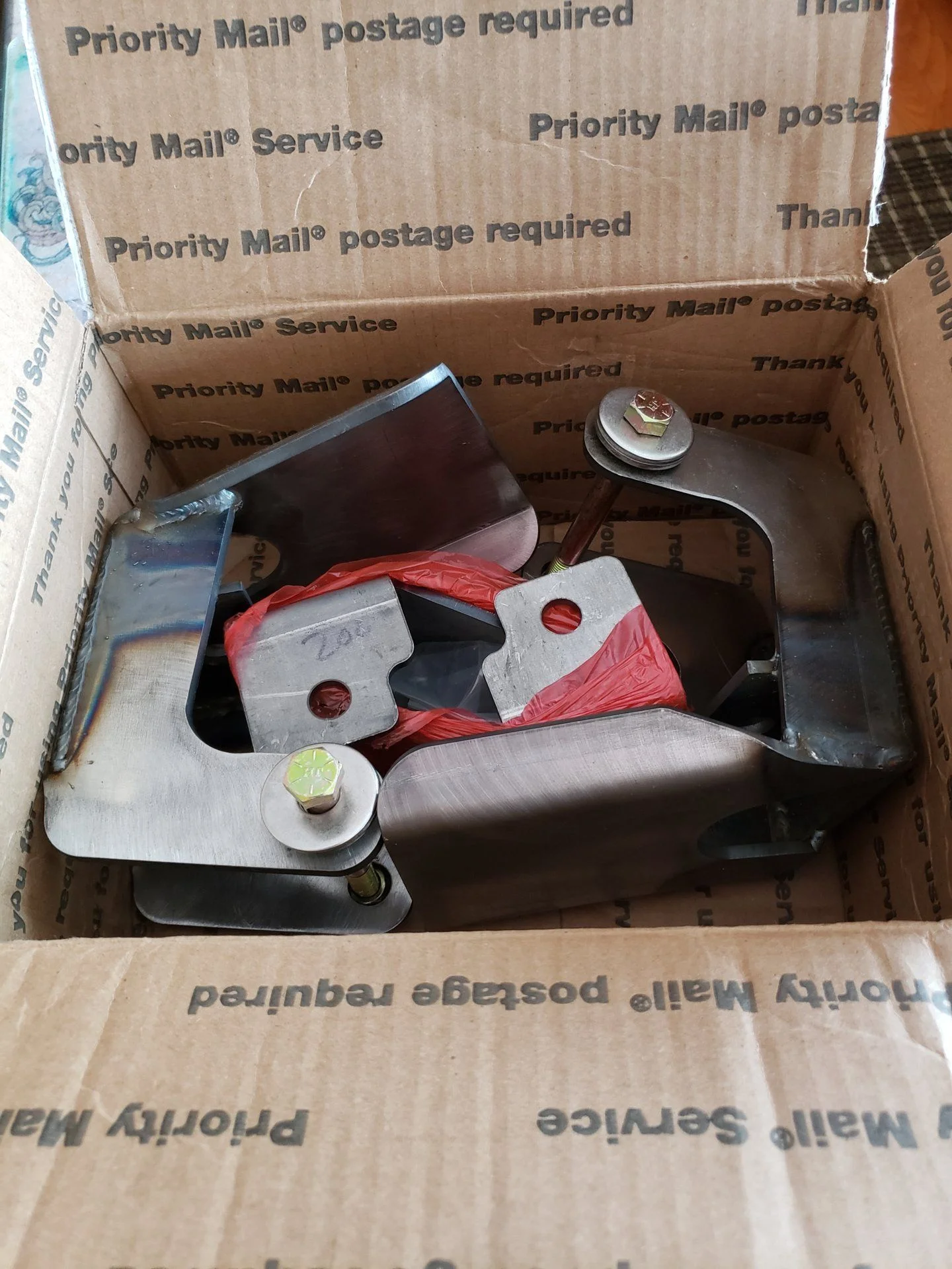

More armor came in! Rear LCA skids and shock guards from Trail Tailor

I just did this before my most recent wheeling day because of your last wheeling trip. Glad I did, the rocks love to jump out and grab the low hanging bits on these rigs.

That's exactly why I got it. Smashed the Passenger side Rear LCA pretty hard in Uwarrie. Figured I'd rather take care of this before damaging them anymore.

I received mine Friday morning from FedEx. Opened them up, slaped some primer on them and bolted them up Friday afternoon. You have to bend some metal to your will and allow the fasteners to conform the protection to the truck. I installed them laying on my back in the driveway in about an hour and a half. Good luck!

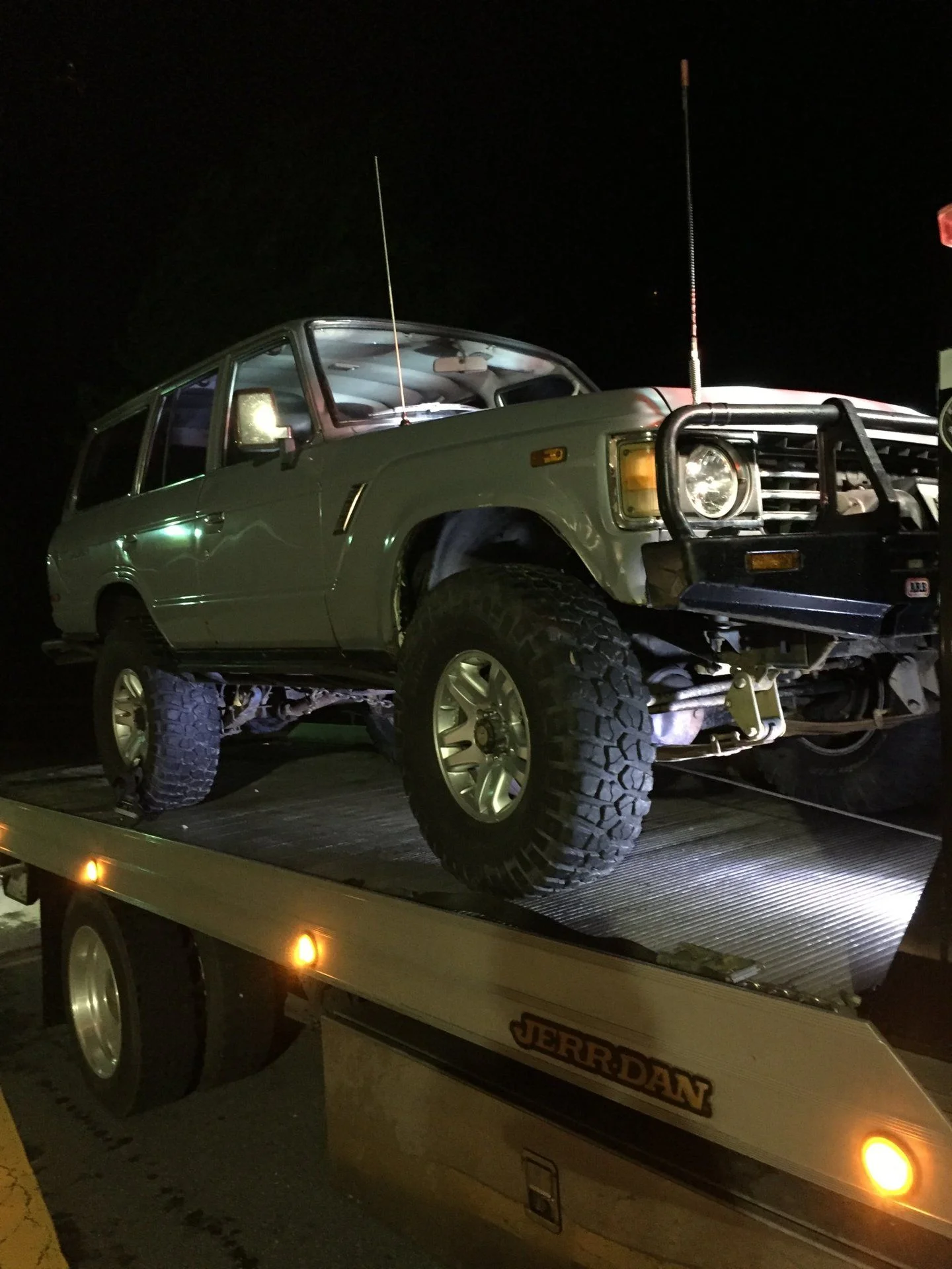

Mom's day ended a little less than ideal.. I noticed my temp gauge was moving around a bit. On the way home from Harpers Ferry I dropped into an Advanced Auto to grab some coolant and a socket set to pull my thermostat in the parking lot as they were closing. The radiator was barley hot but the thermostat housing was quite hot! It would spike to Hot and then drop down again. And then the garbage socket adapter broke!
So we figured we'd let her cool down see how far we could go until the gauge climbed to Hot status again.. Surprisingly made it until we were about 20 minutes from home and called it quits. Tow truck came and brought her home. Only the second time I've been stranded in a land cruiser and the other time was cooling related... Hopefully she'll be back up and running by the weekend

I guess my thermostat got stuck closed. I pulled it today and was going to order from cityracerLLC but they aren't fulfilling orders until later next week... looks like rockauto has the Aisin parts so probably order from them tomorrow. I'm just making sure the gasket set they have included the o-ring (appears too)
