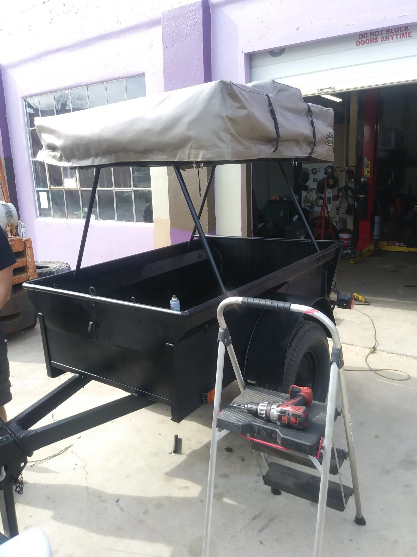

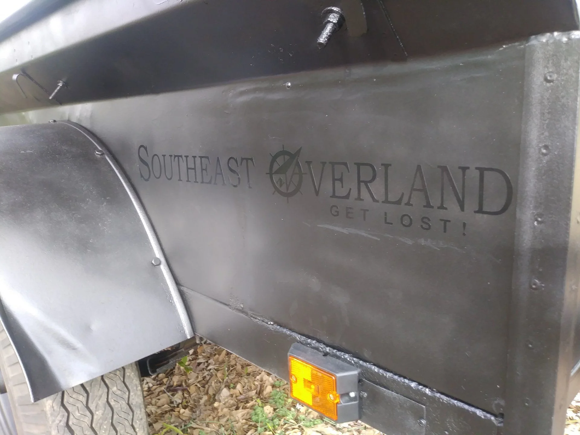

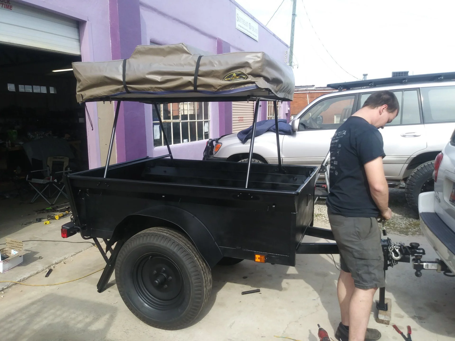

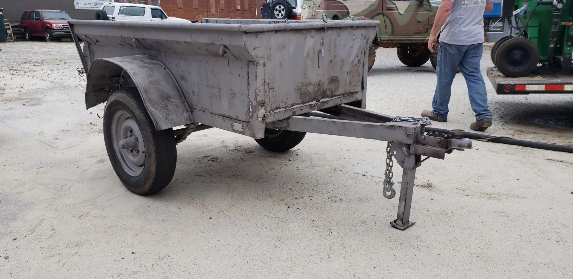

Current project is this trailer.
My trailer but they did all the repairs etc...I can't weld so they had it sand blasted and patched up all the holes. I still want a different hitch setup and extend the tongue but $ is short for now!

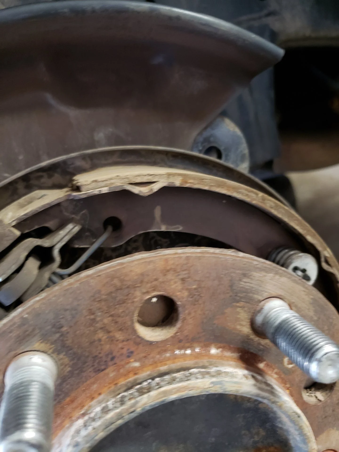

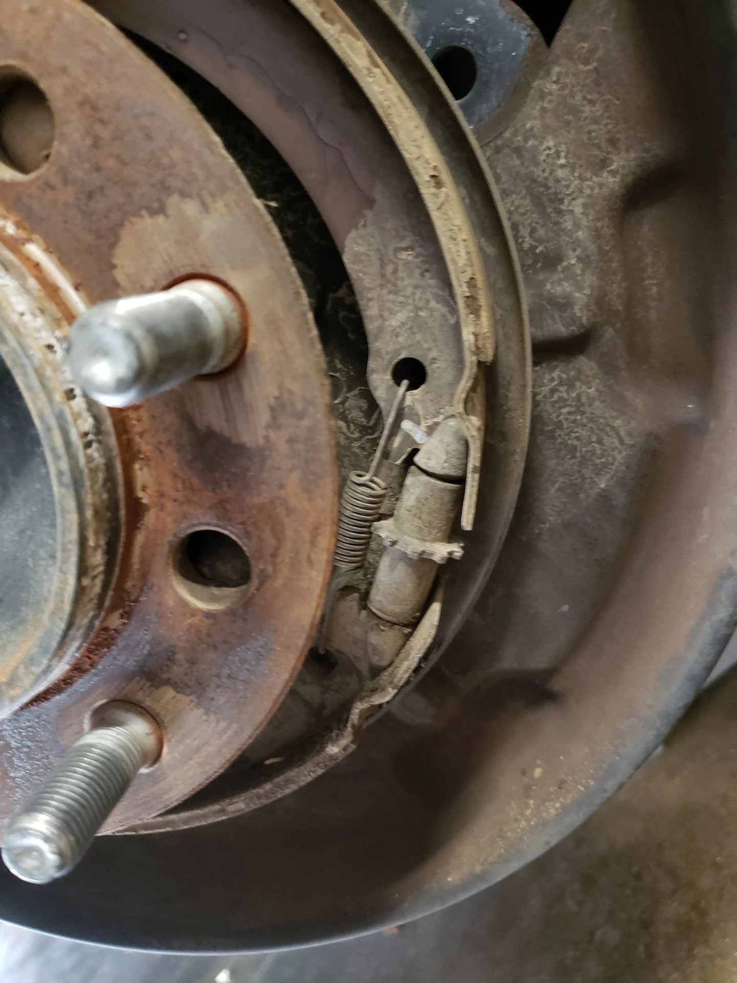

Finished rear pads and rotors.. only thing left is brake lines.
This is the parking brake pad, do I need to replace this or do they still have life left?
I wouldn't replace the e brake shoes yet.
Perfect! I didn't do anything with them. Just tightening the parking brake adjuster to actually hold the rig. Wanted to make sure it wasn't something I need to replace soon though.

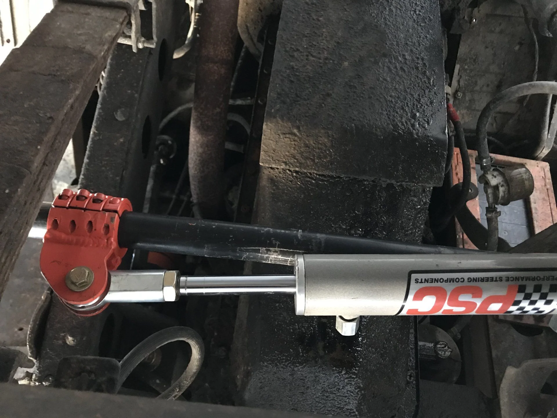

Might have hydro assist done in time for the Relic Run.

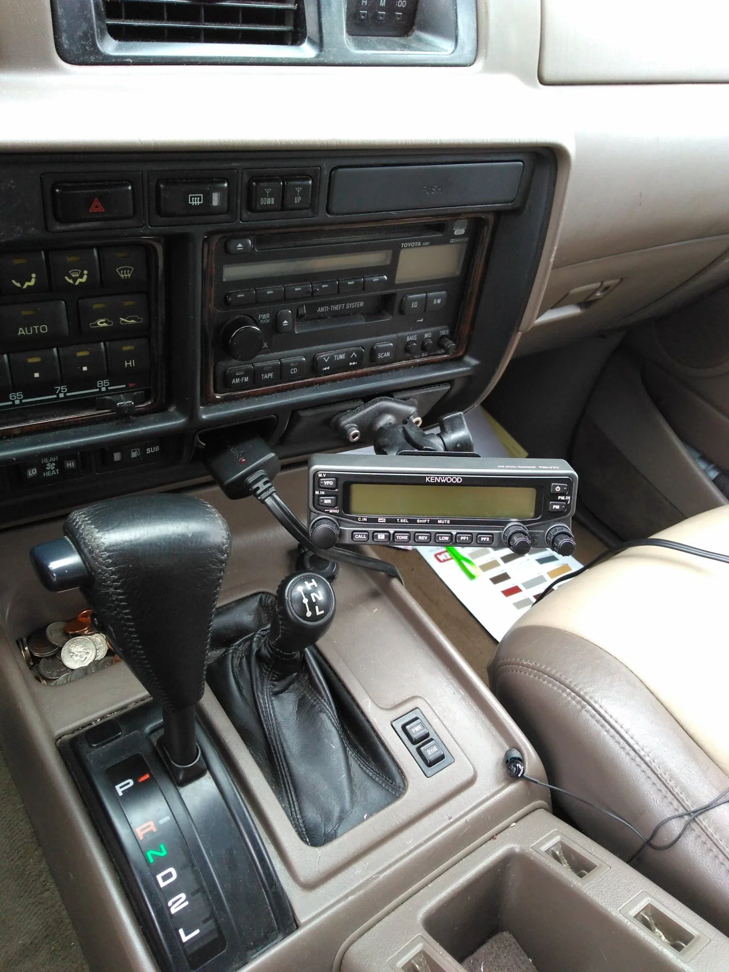

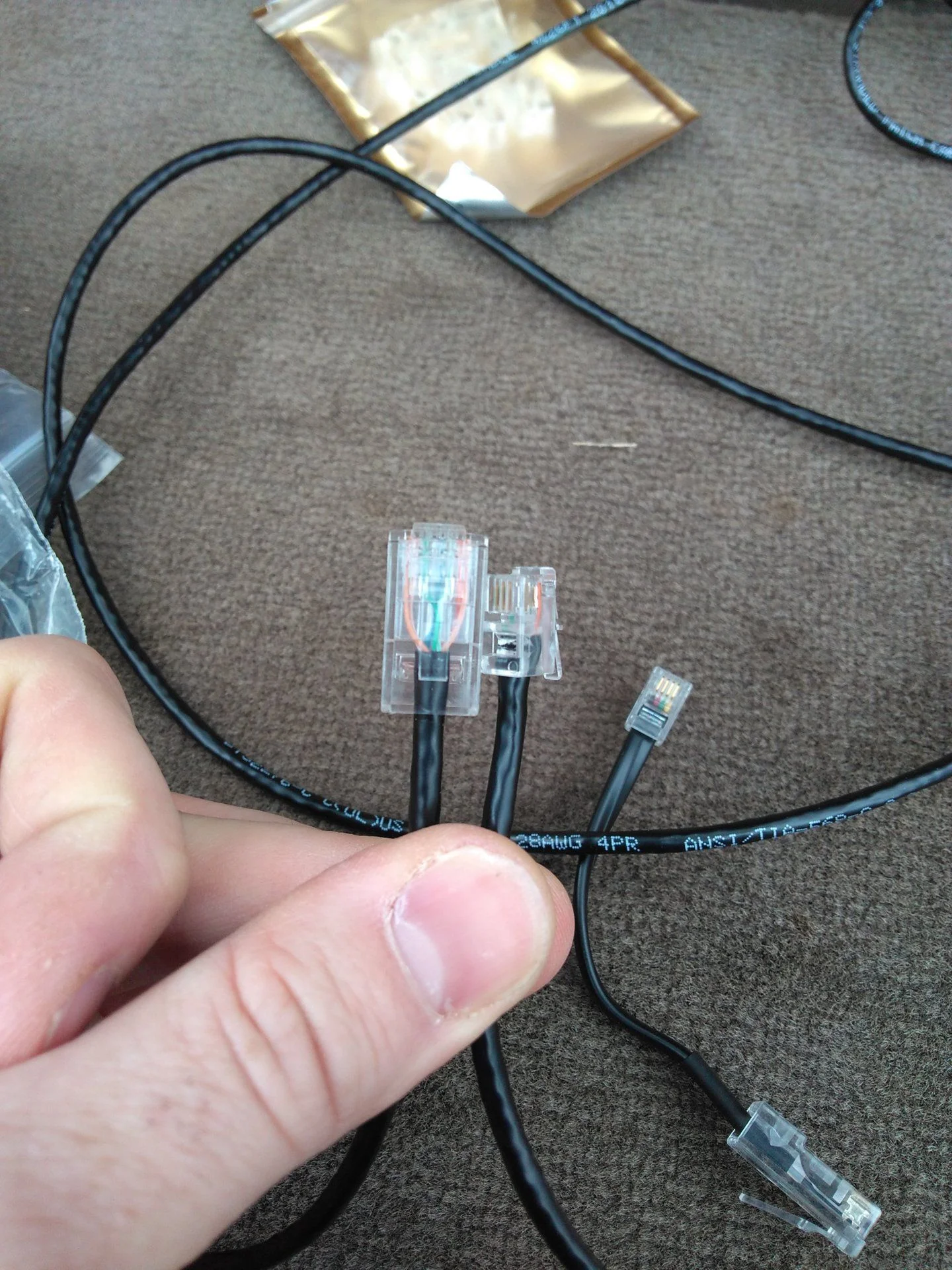

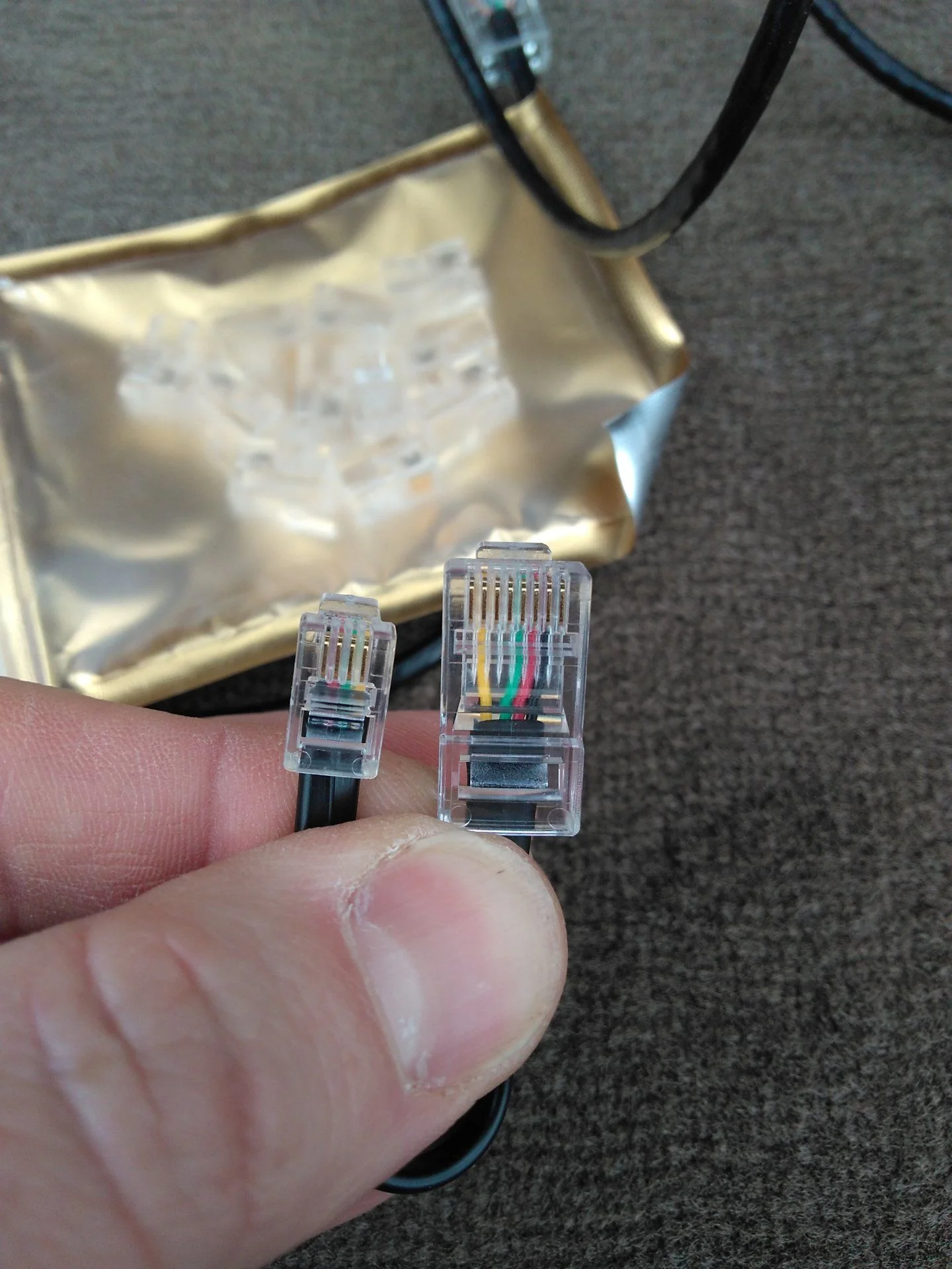

Got my radio face plate mounted up using RAM mounts and a sweet 3d printed ash tray insert by @OverlandImage. It's a little longer than I anticipated so hopefully it doesn't vibrate too much on the road. Still need to wire up the face plate to the base until in the back. I also built my own base to head unit wire out of slim line Cat6. I bought some RJ9 (headset plugs), cut the end off one side of the Cat6 and matched the pin outs of the stock cable and crimped the end on. I also bought some RJ45 couplers to use to extend the mic from the base to the front using Cat6.
