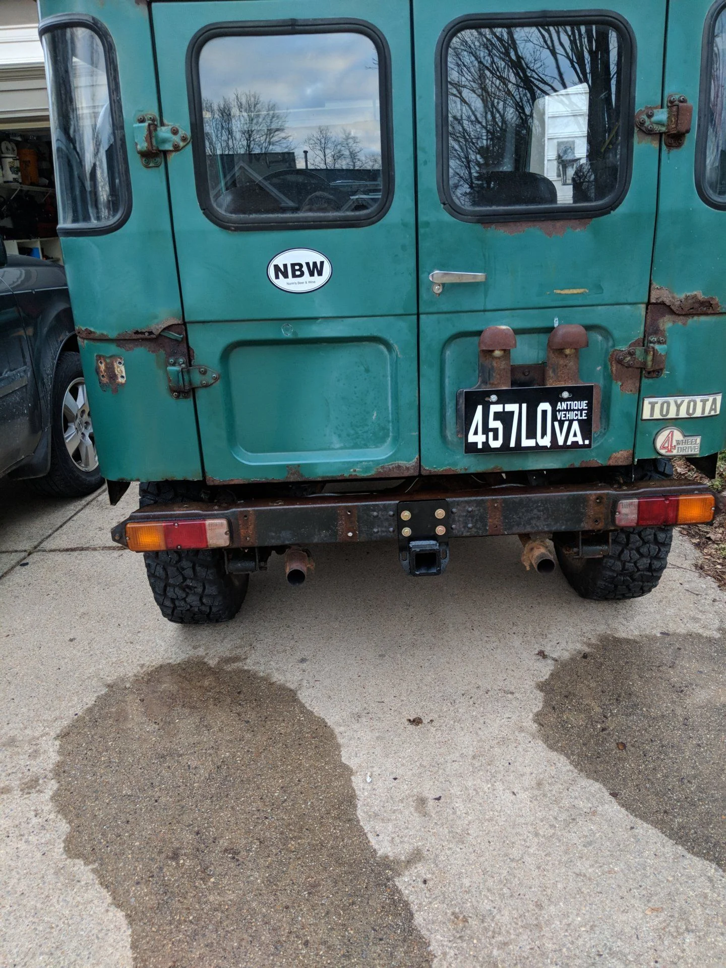

@jcj_78FJ40 we’ve had some extreme swing in temperatures lately. Last few days have been warm in comparison to the extreme cold in previous weeks. I didn’t think of how that might contribute to problem if there’s a possibility the vent is clogged.
It's not the weather temp it's the heat generated by the diff. As the air in the axle housing expands, it has to go somewhere. If the vent is blocked then the seals become the weak points.
It's hardly ever something that simple but it only takes 5 minutes to check.......
