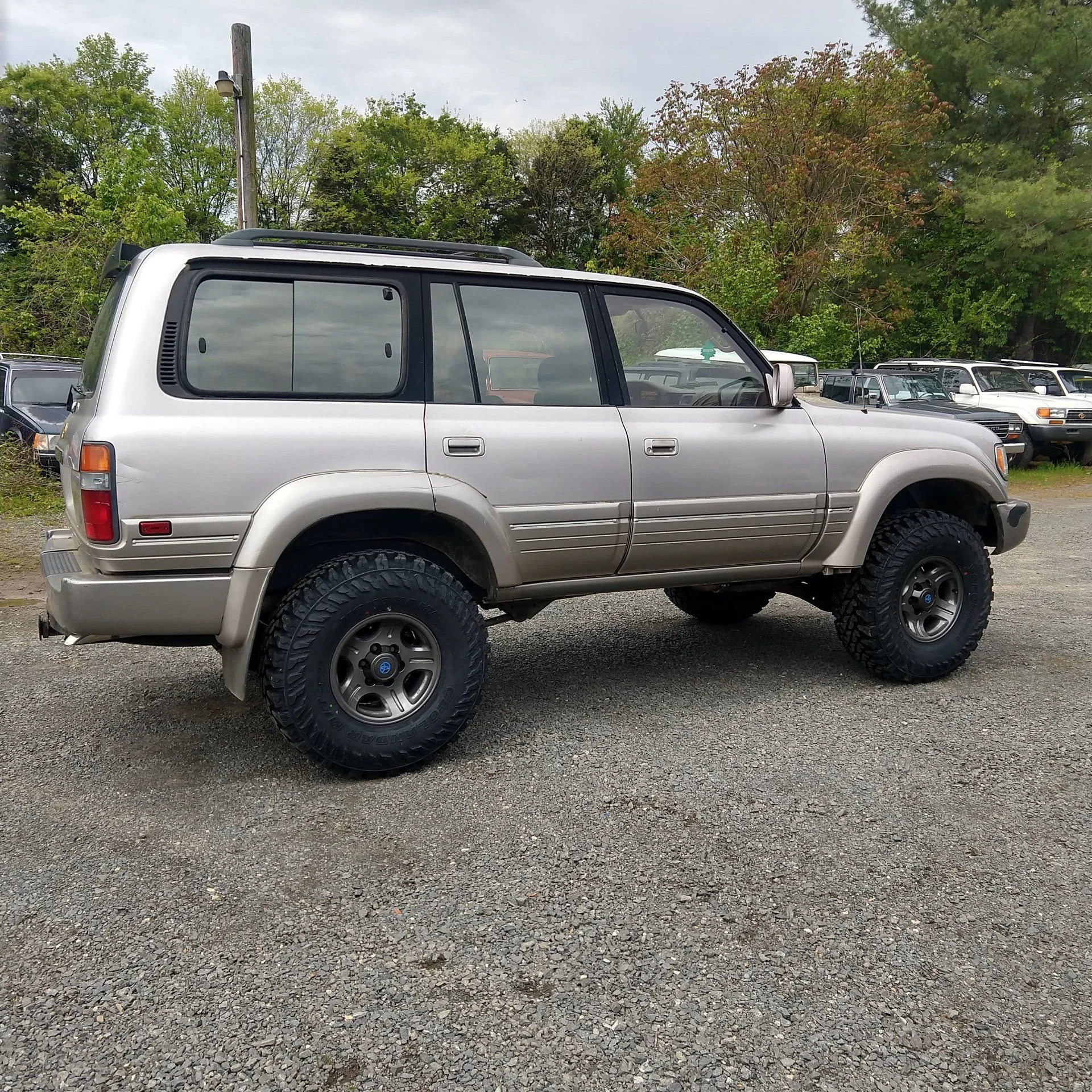

Finally sold the LX. She shipped out to Colorado to her new home today.

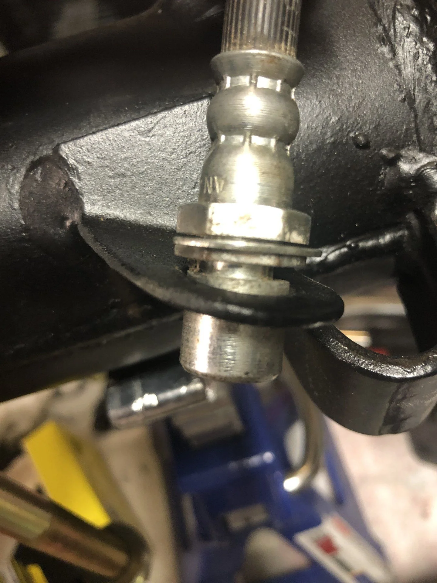

Question on brake lines while I’m waiting on the new Longfield’s......the brake line tabs welded onto the axle housing have round holes, the end of the flexible brake line is hex....looks like I’d have to shape the round hole into a hex so that the brake line clip can fit onto the flex line. Is that correct or is there another way of doing this?

Nevermind, I figured it out. I’ll just file the hex on the brake line round so it’ll fit in the hole, then the brake line clip should slide on.

No, don't file the hex, there is a clip that goes into the slot that holds the flex line in place. Check the service manual.

This is a classic issue. I think the new lines hexes are too big to fit in the stock hex hole. You might try filing them out to fit the bigger fitting. Most of mine are loose , since the spacing between the c-clip and support is often too narrow to fit with the spring clip. Very frustrating

Yes, this is the issue. I need to either file the round hole to fit the hex, or file the hex to fit the round hole. I have the correct clips, but the clip won’t fit until I file one or the other. As mentioned above, if I file the round hole into a hex it’ll prevent rotation of the brake line, so I’ll go that route instead.

That is the right answer.
