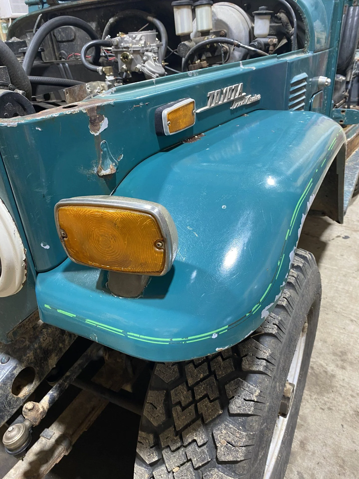

So what's the aversion to just using Penetrol the whole body paint? Just that a proper polish and wax is a preferred path if possible?

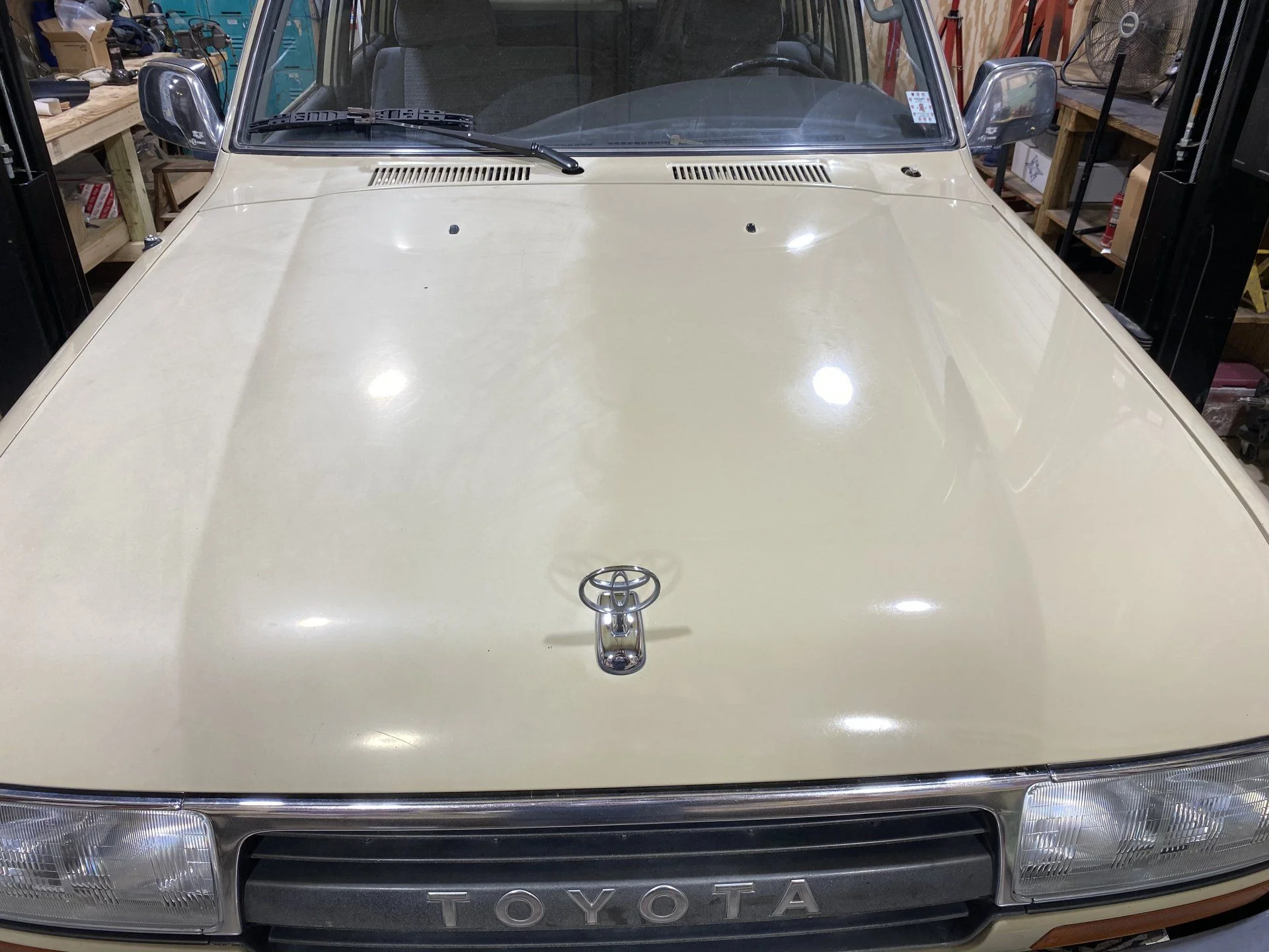

It’s nice paint. Maybe if it was not super smooth and able to be polished but this paint polished up like a new paint job.

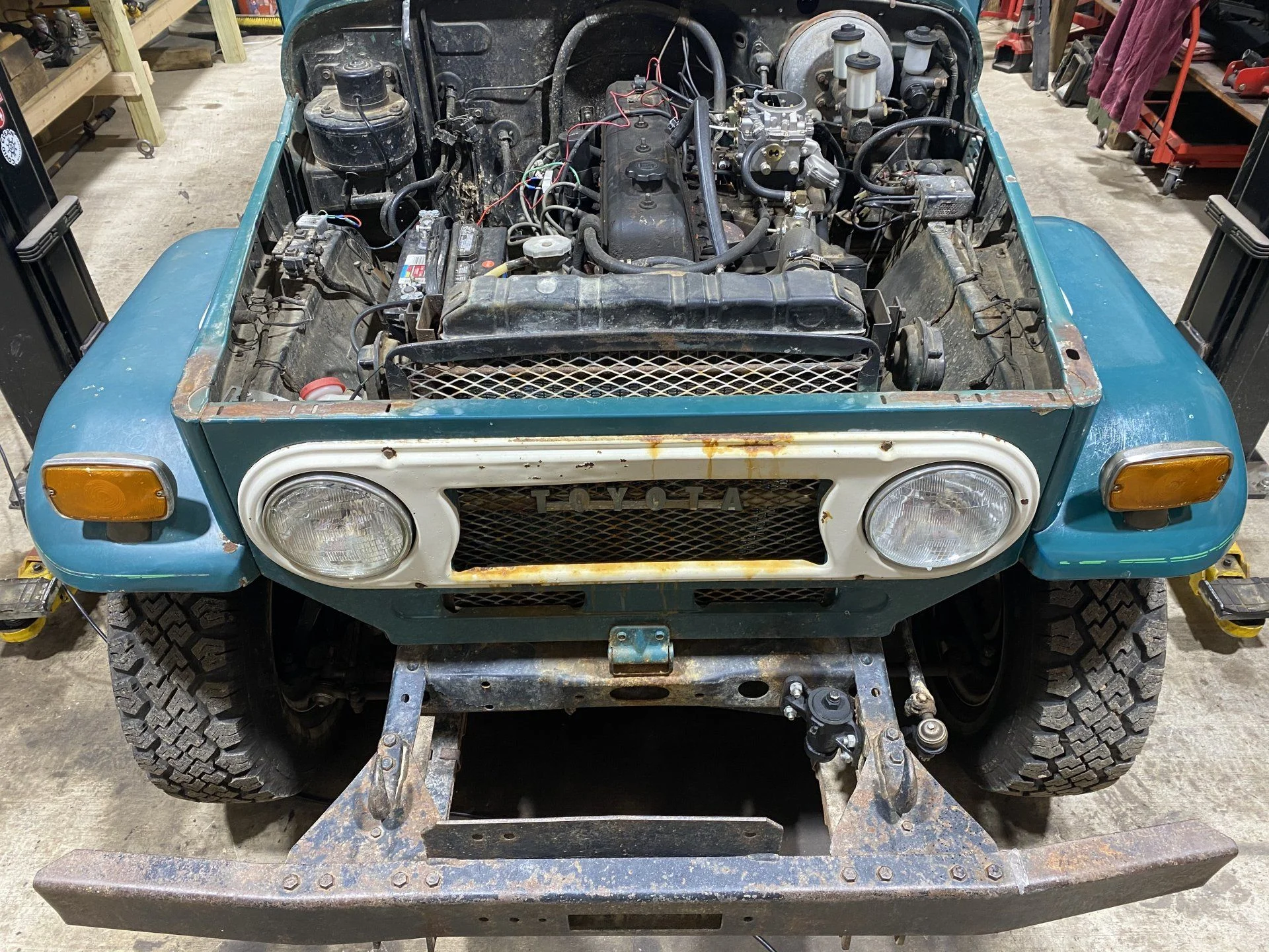

It also depends on your paint. This is my Ofdball80. I did not want to swirl the paint with CLR and 0000 so I went all orbital
I'm pretty happy with how the Penetrol turned out, applied to both patina and paint. It gives a fairly glossy finish on paint, but it's self-levelling and looks pretty good. And you don't have to mess with spot application and wax on your patina.

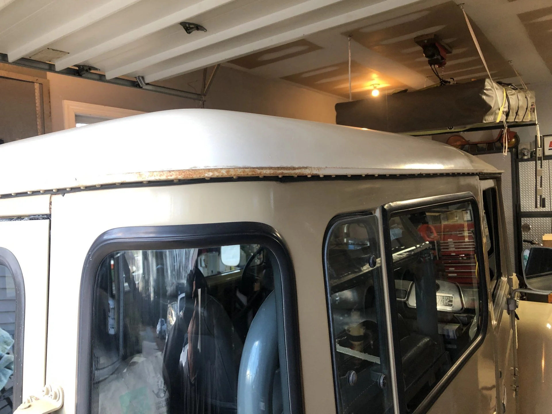

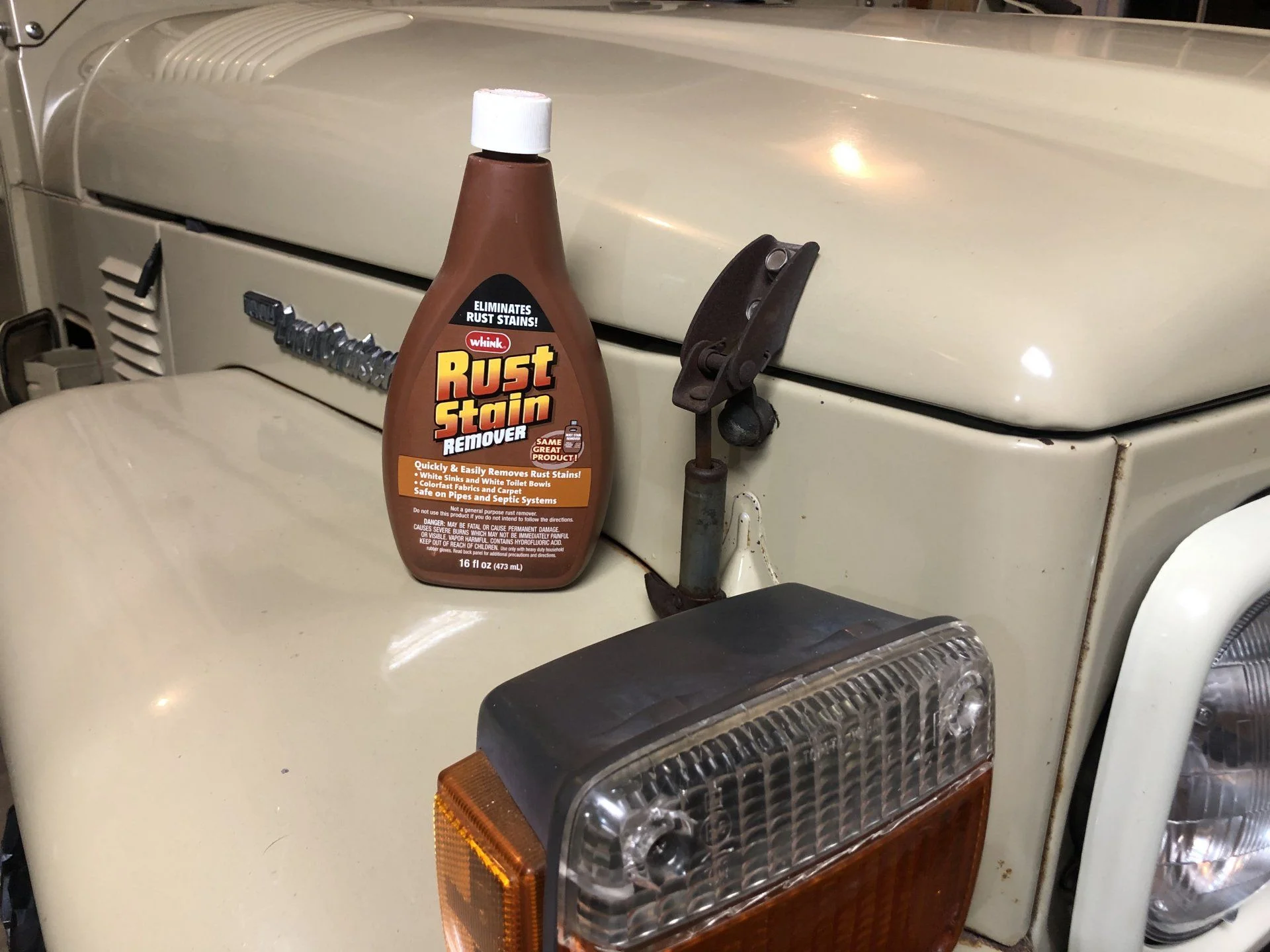

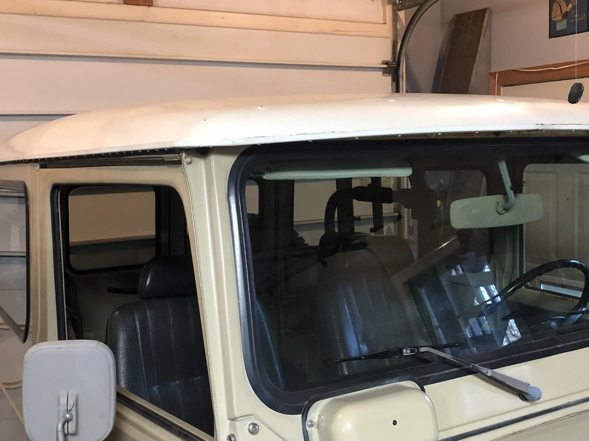

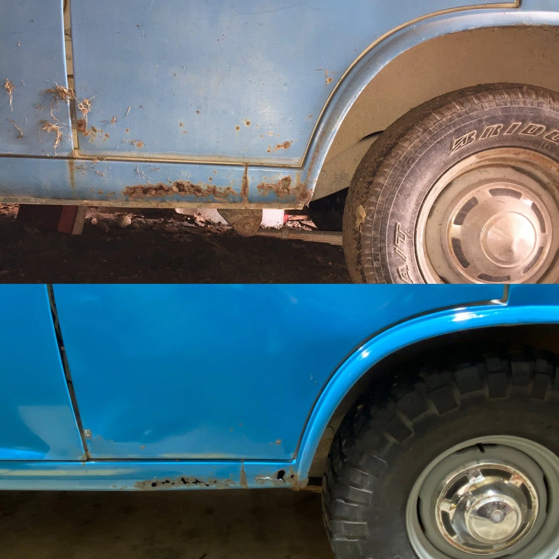

One product that I’ve used on my patina trucks with good results is Whink Rust Stain Remover. It’s like CLR on Steroids. It’s very powerful and a little bit goes a long way. Paired with a Scotch Brite pad, this stuff will absolutely erase rust stains from paint. I work it in small sections and clean it off really well with soapy water when I’m done with a section. Don’t leave it on the paint for too long. It can dull the finish and possibly etch.
Before:
After:
Before:
After:
View attachment 2579086Before:
After:
Before:
After:
Looks like what I need. Thanks for the tip.
