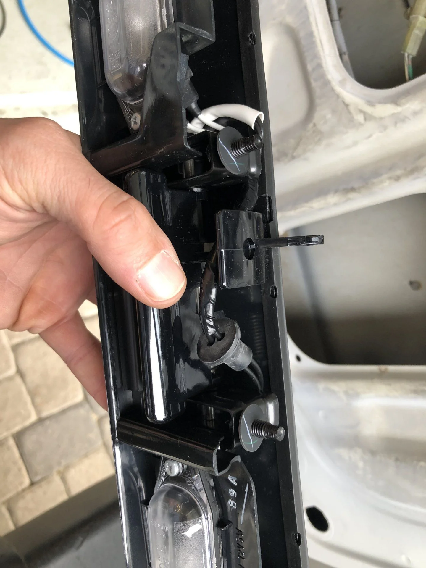

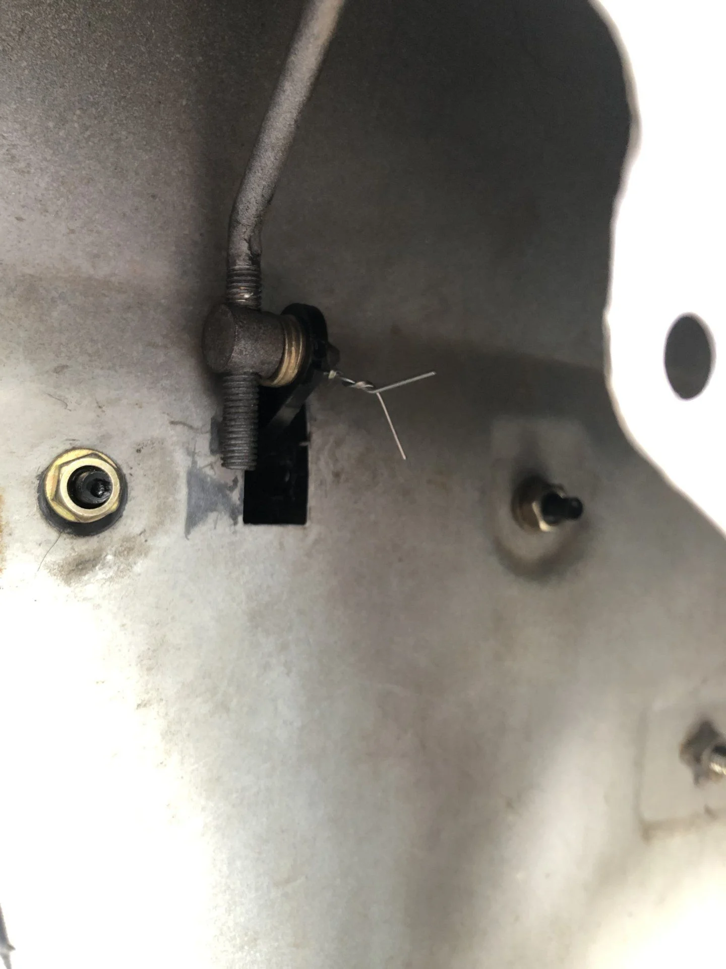

Rear door latch:
I knew from Joe that the rear door latch was not closing well. The entire lamp assembly is available and cost $60- a quarter of what it does for a 60 series. However, I’m missing a little plastic cap over the linkage. I temporarily held it in place with a stack of washers and a piece of wire.

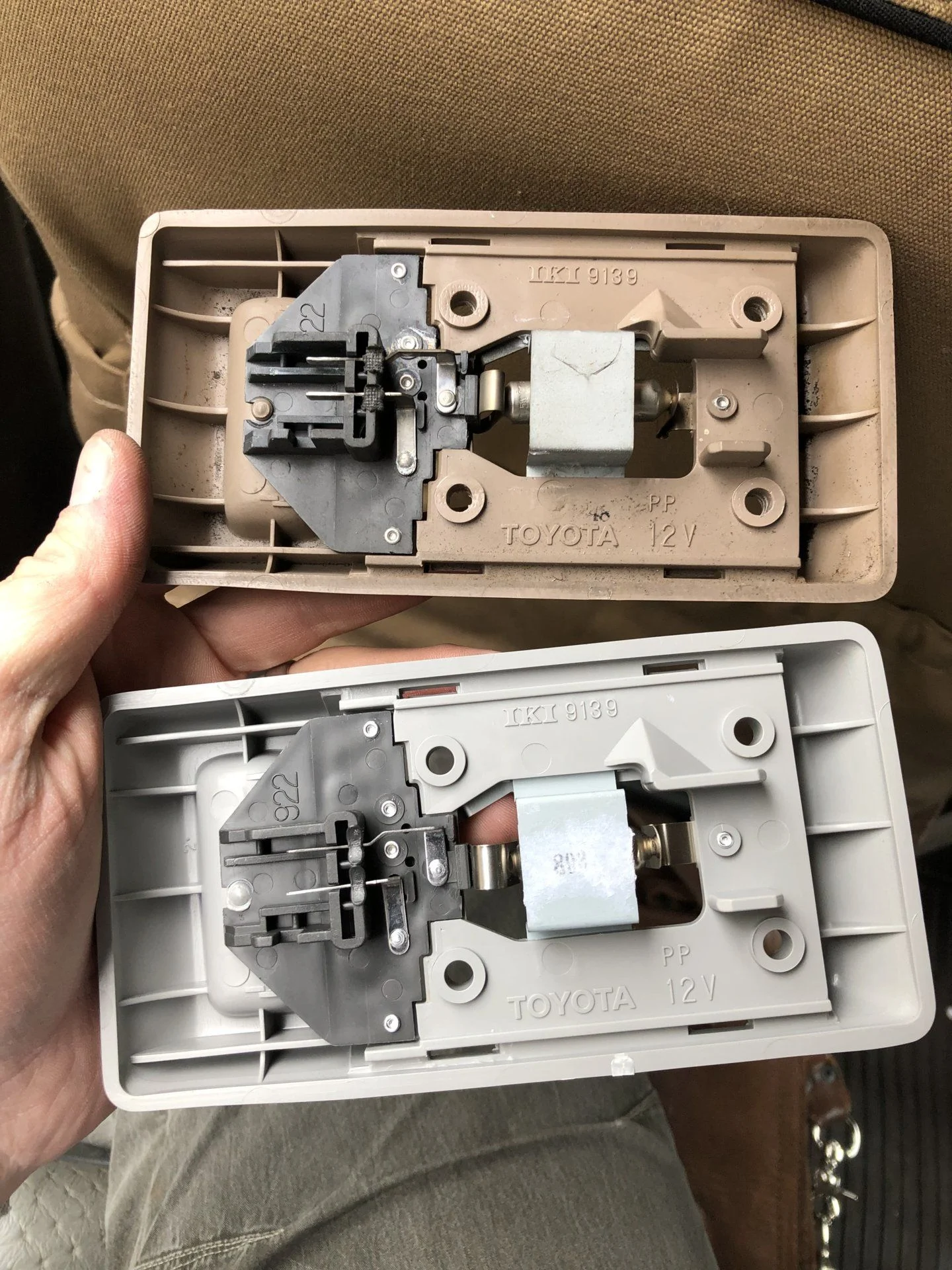

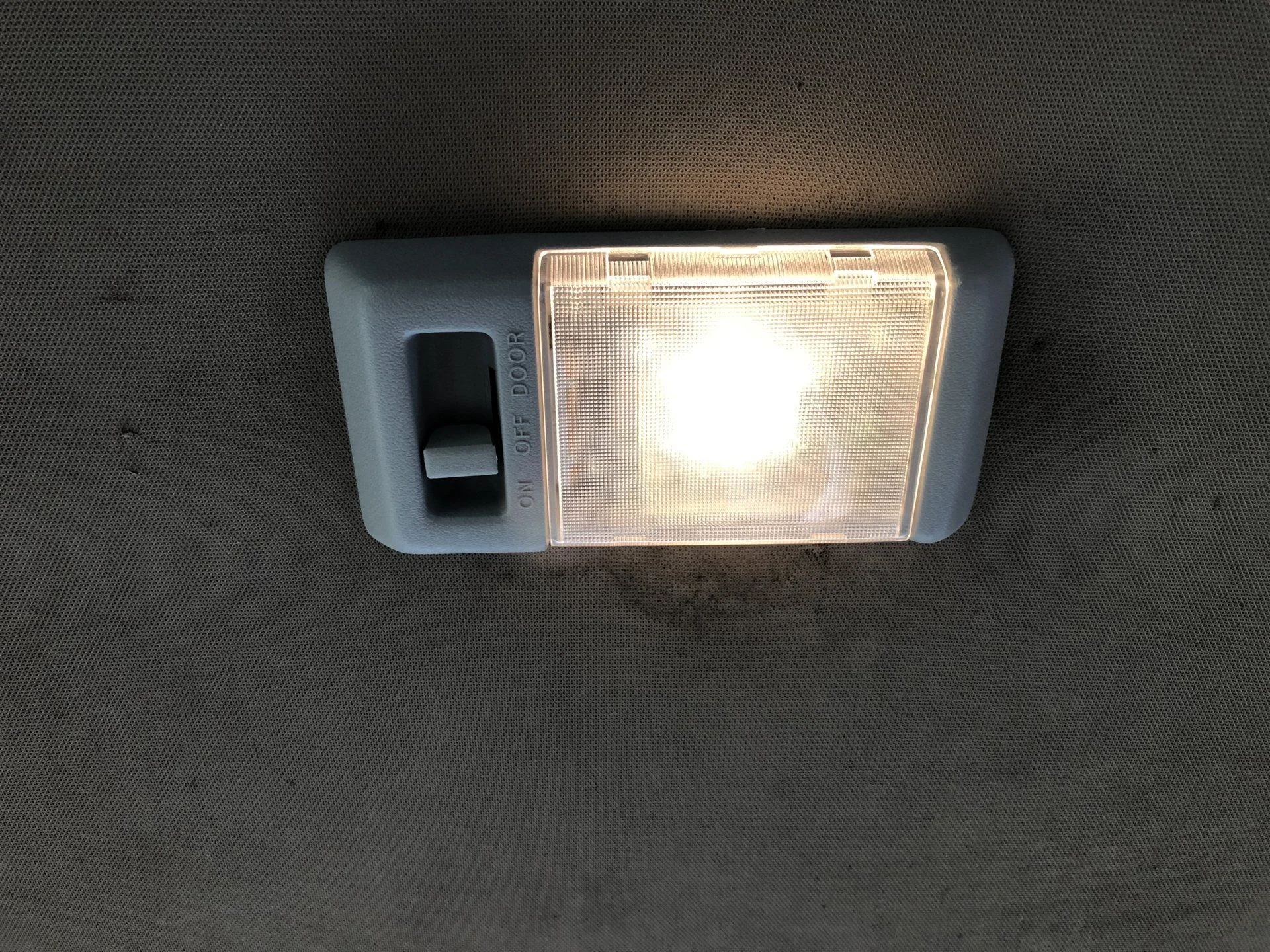

I love lamp:
The switch broke off the third time I used it. I found a new lamp and it really brightens the place up. 27 year old plastic sucks.

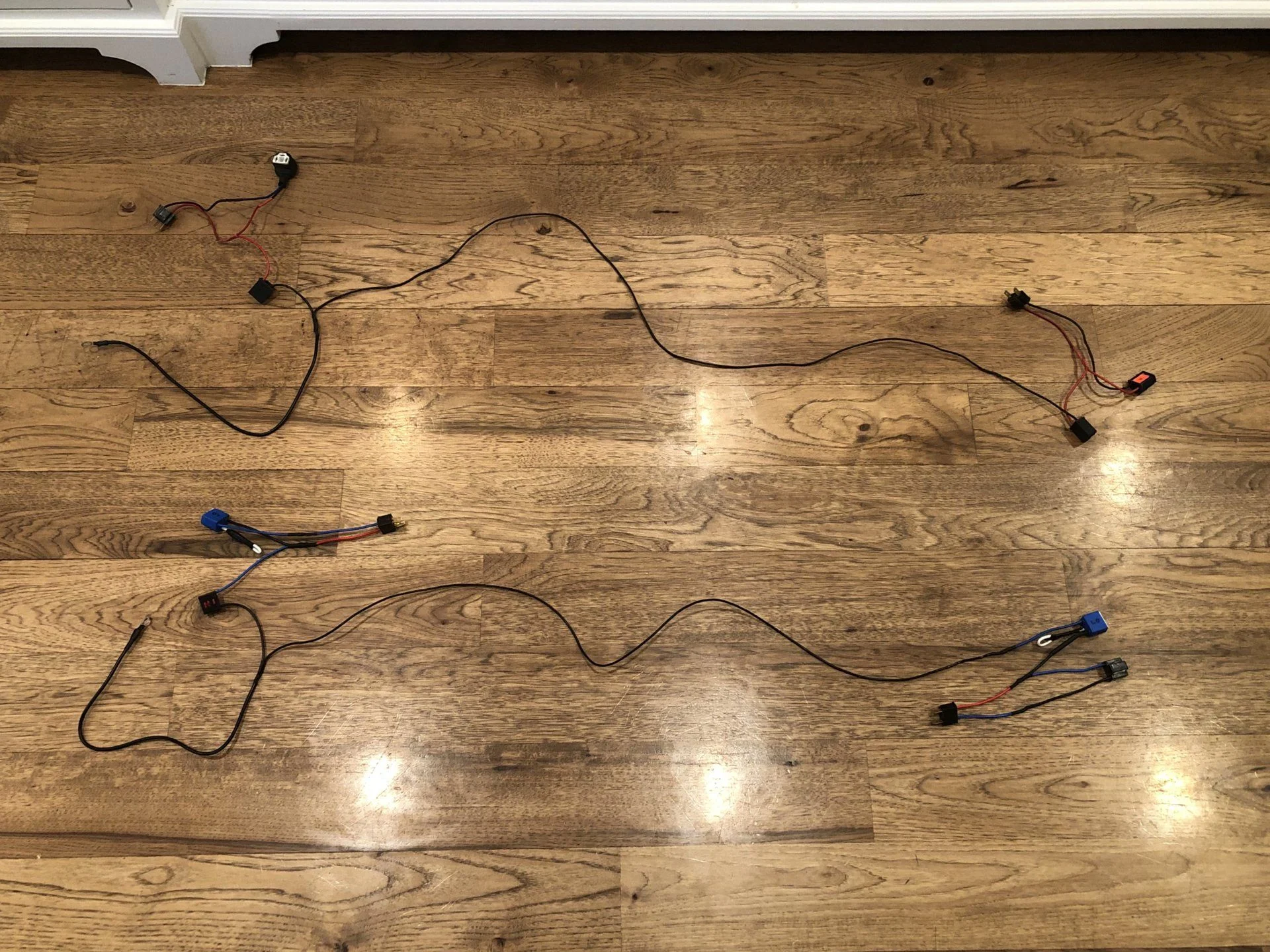

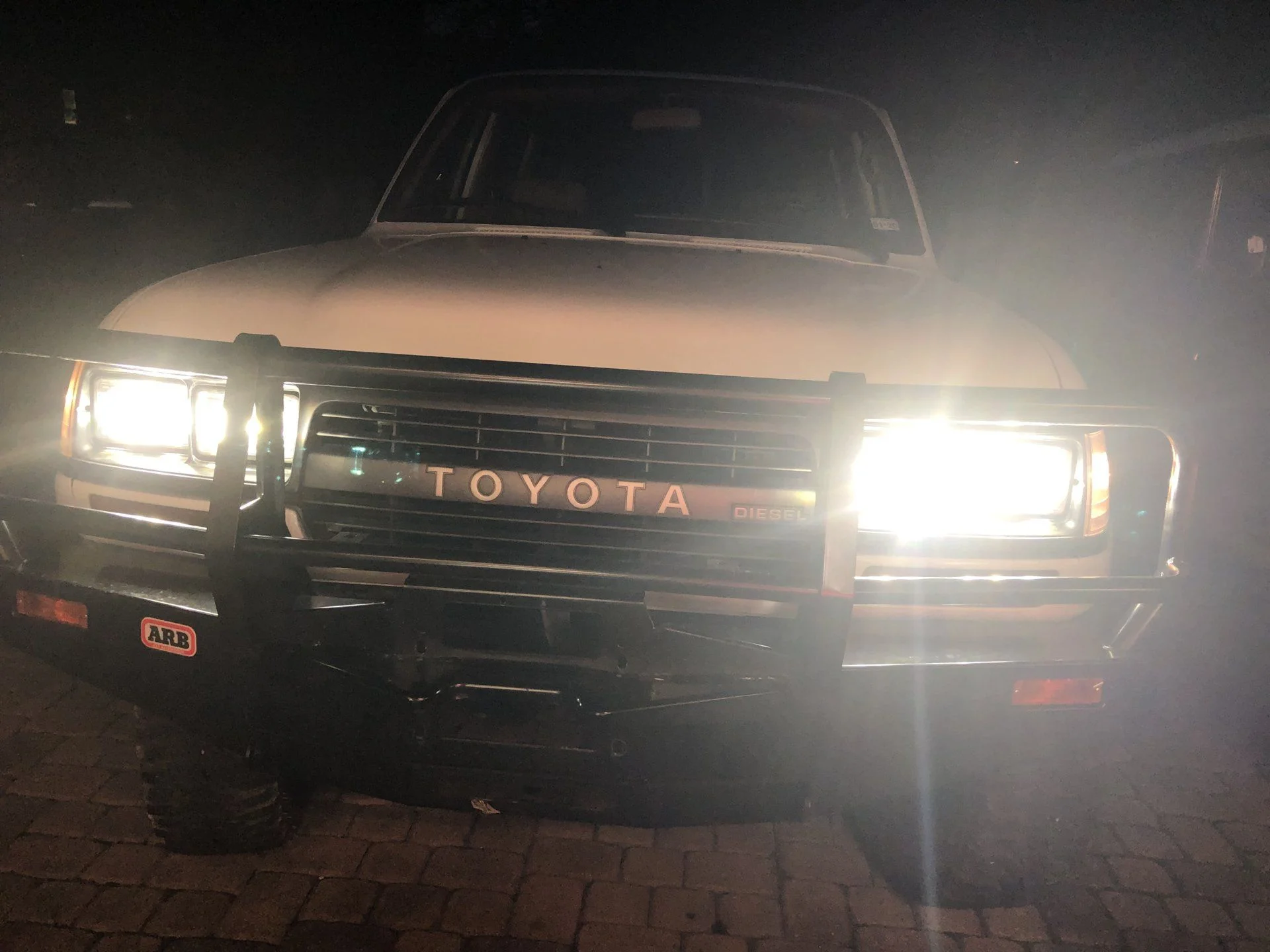

LED headlights in a 4 headlamp 80:
I had previously converted my FJ62 and HJ61 to LED headlights as documented in this thread:

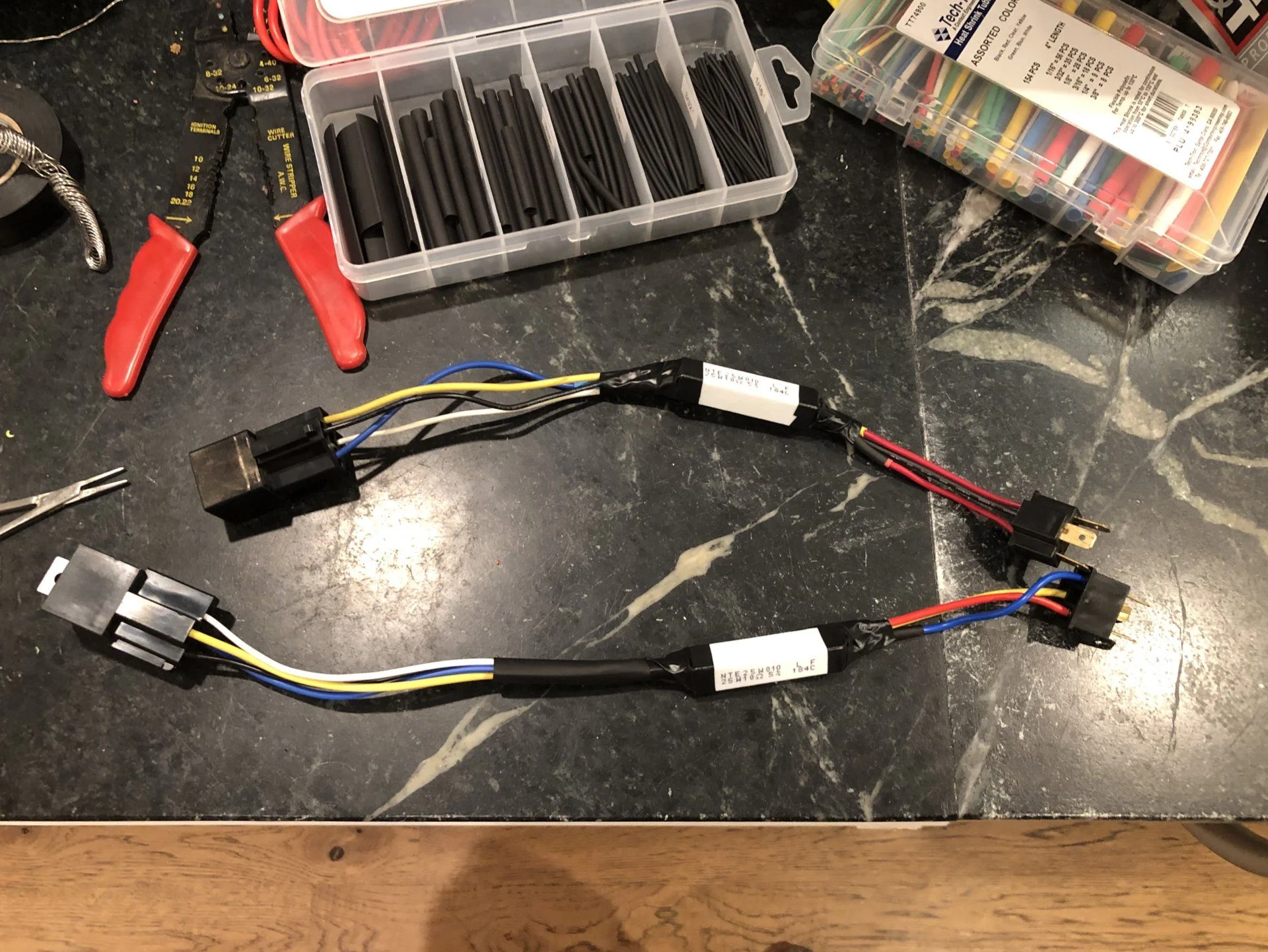

Dollar for dollar, LED headlights have been the greatest safety modification I’ve done to my trucks. The helpful Canadians at highperformancelighting.ca originally documented the wiring harness and high beam relay switch for an 80 series, so I was pretty sure that it would work.
I took the harness off of my 62, and lo and behold it worked correctly. Everything works including low beam, high beam, and high beam flash function.
A quick trip to the local electronics store for a couple of resistors, and I built a new harness. Old harness above, new below; just cloned.
1918995
1918994
Low beam and high beams work as they should. Low only on LO, all 4 lights on HI. Flash function works as well.
Only difference is that I do not have a highbeam indicator light on the dashboard. Did poverty packs have them? Maybe my bulb is just burned out.

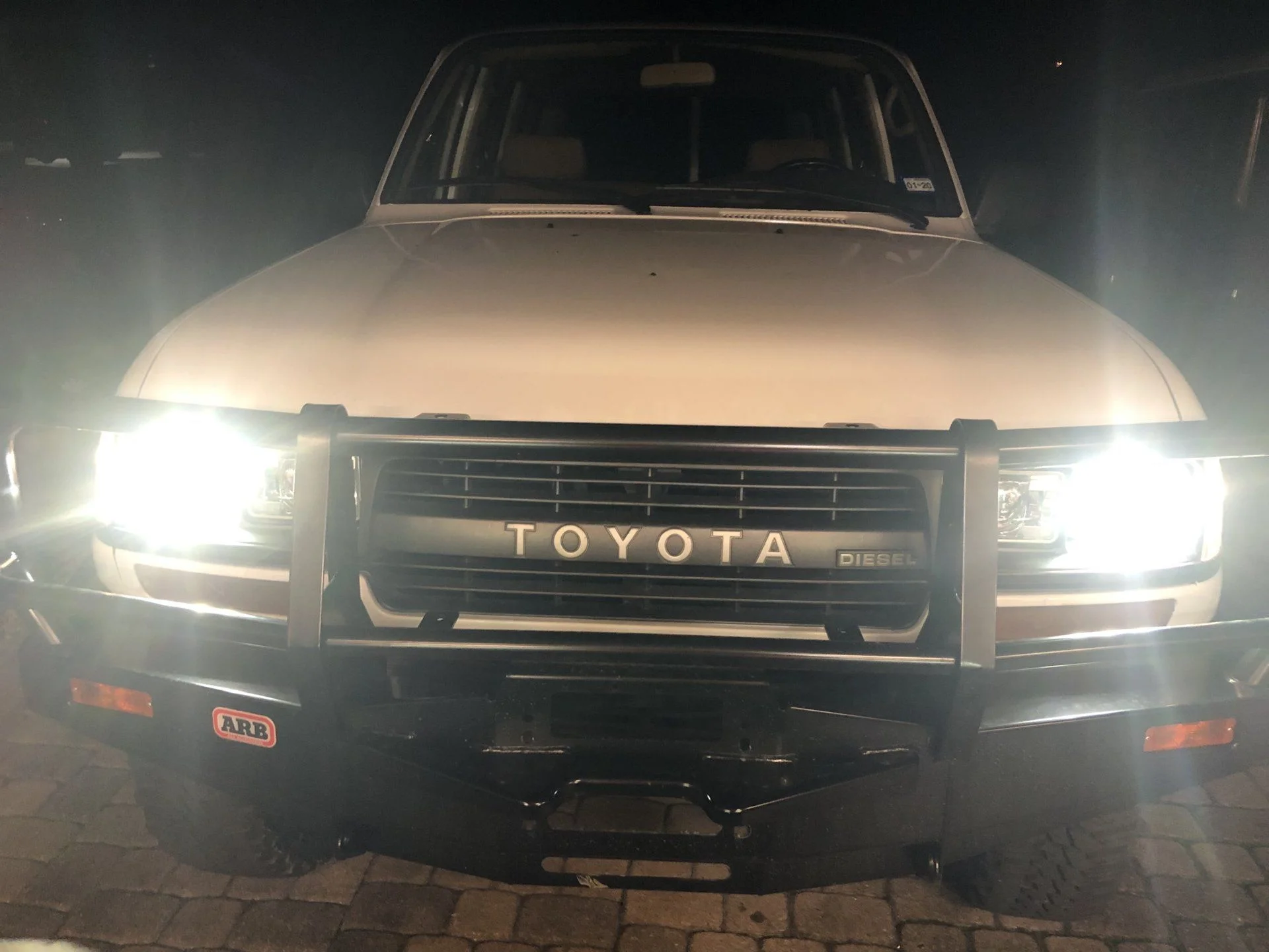

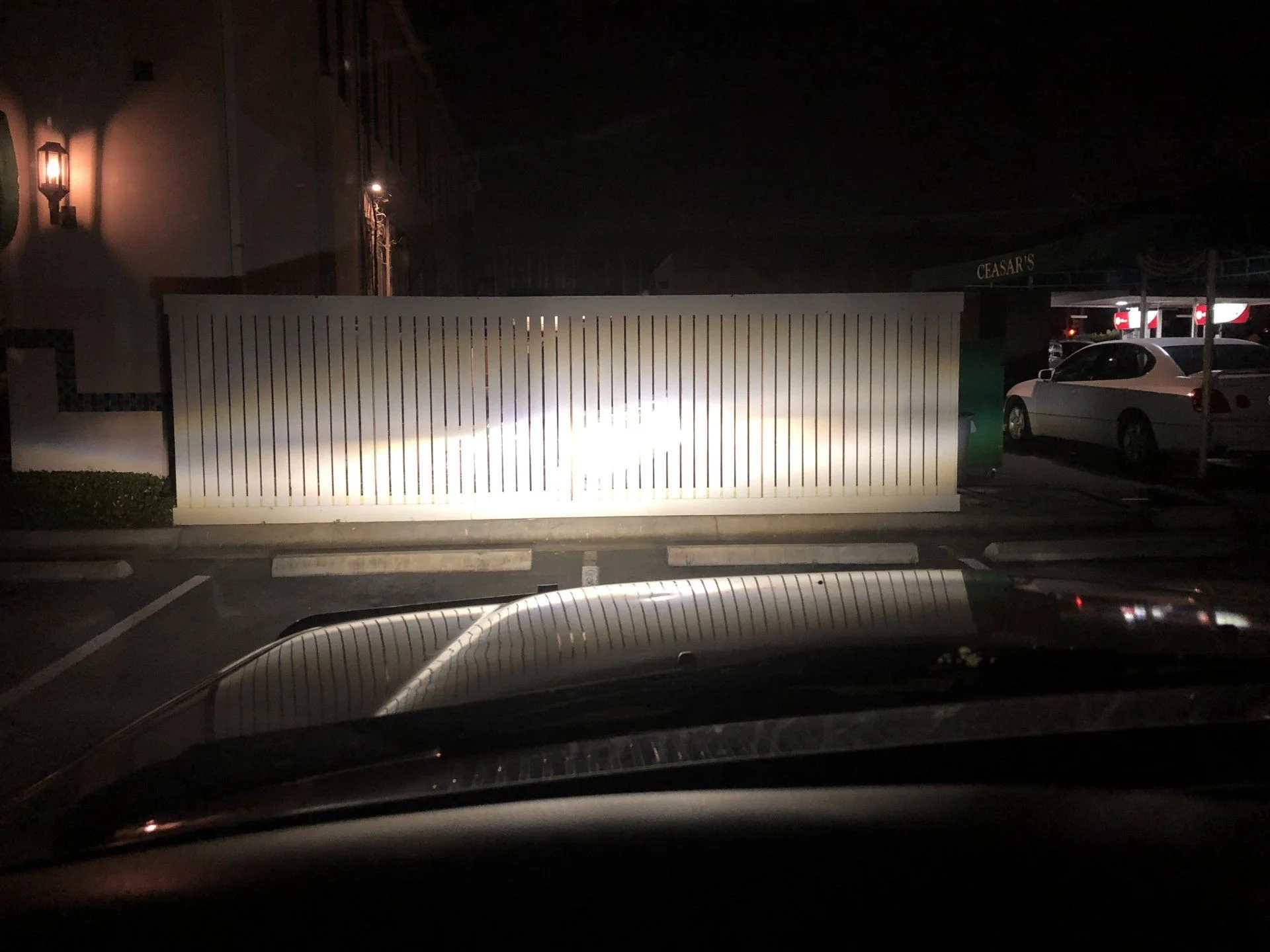

Obligatory low and high beam shots.

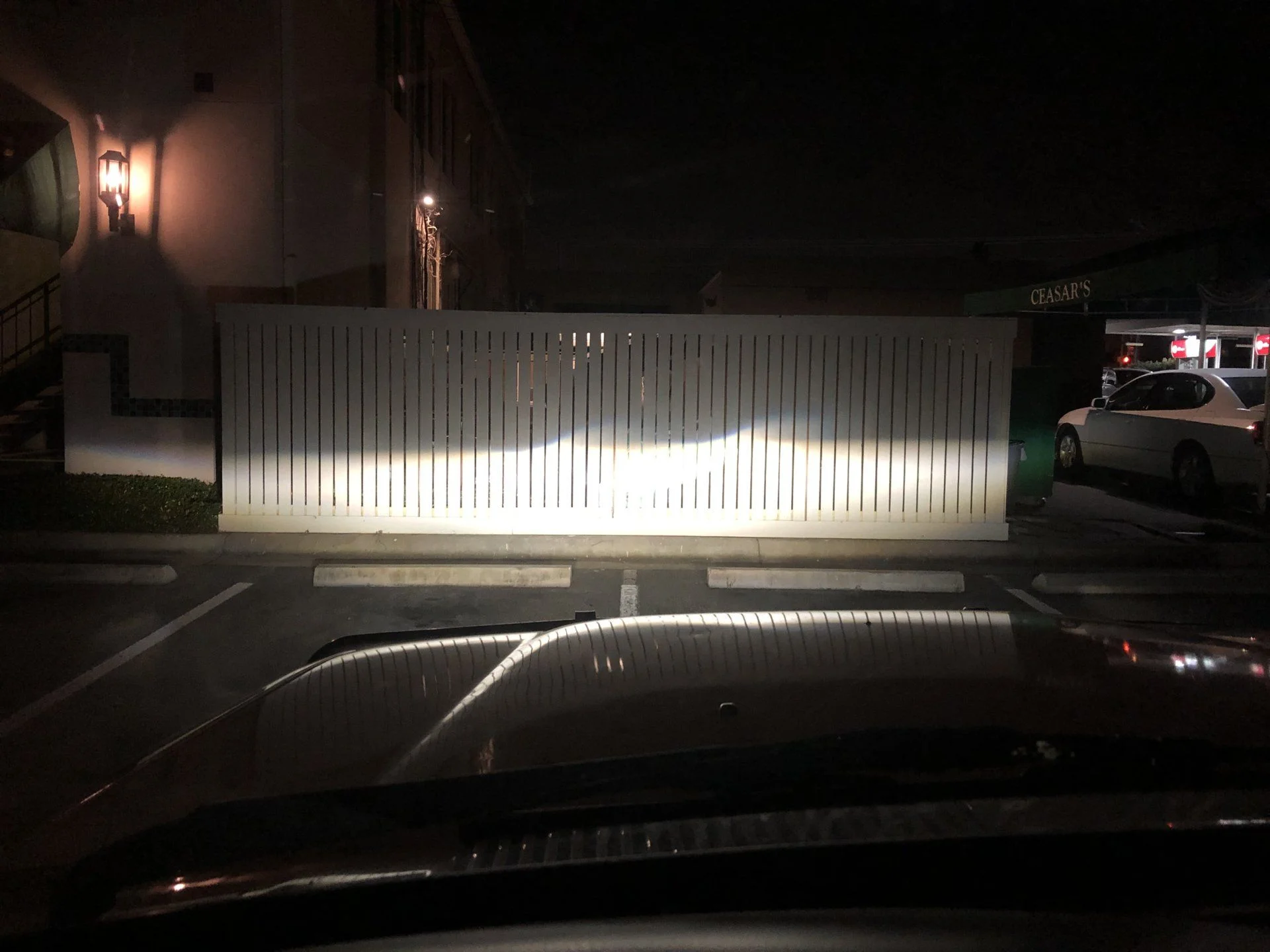

Low:
1918999
High:
1919000
I will say that this nighttime iPhone shot does not do the beam patterns justice. Low beams are clear without weird patterns or cuts. It is just one clean continuous field of view with a strong horizontal cut off.
High beams are really, really extraordinary. Just clean and unobstructed without cutoffs.
These JW Speakers cost a pretty penny, but I really cannot overstate how much they have improved night and inclement weather driving safety for me.

@bottombracket let me preface this by saying I have absolutely no idea about electronics. I do know that when I installed LED’s in my 70 series the high beam indicator ceased working. I’m aware of others having this issue. Not sure of the solution.
@jmlockwood I confess that I don’t know anything about 70 series wiring. The wiring solution which works for the FJ62 and 80 series was specifically designed to keep the high beam indicator working as well as the flash function by using a relay. I didn’t really pay attention to find out if my high beam indicator light on the dash worked before I did the LED swap.
Maybe this week I can pop the lights out and put the old sealed beams back in on one side to see if it makes a difference.
Same in my '90 hdj81 - LEDs in, no more high beam indicator. I have not gotten these yet but have been pointed in this direction for the fix. Once I get them I'll try to remember to report back.

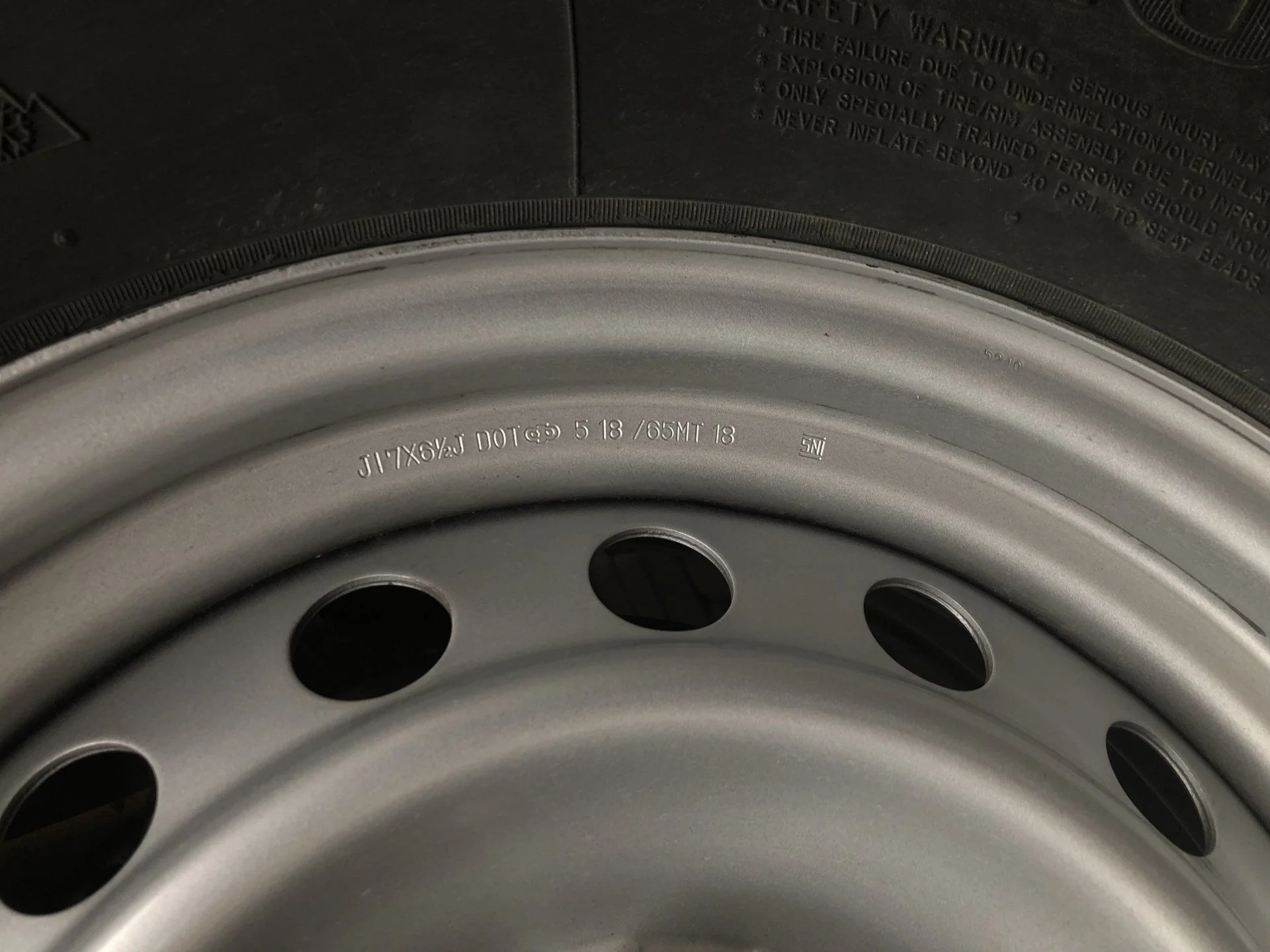

@rghouse the steelies are 6.5x17 Hilux takeoffs. They fit without spacers and do not rub. Joe might have another full set left.

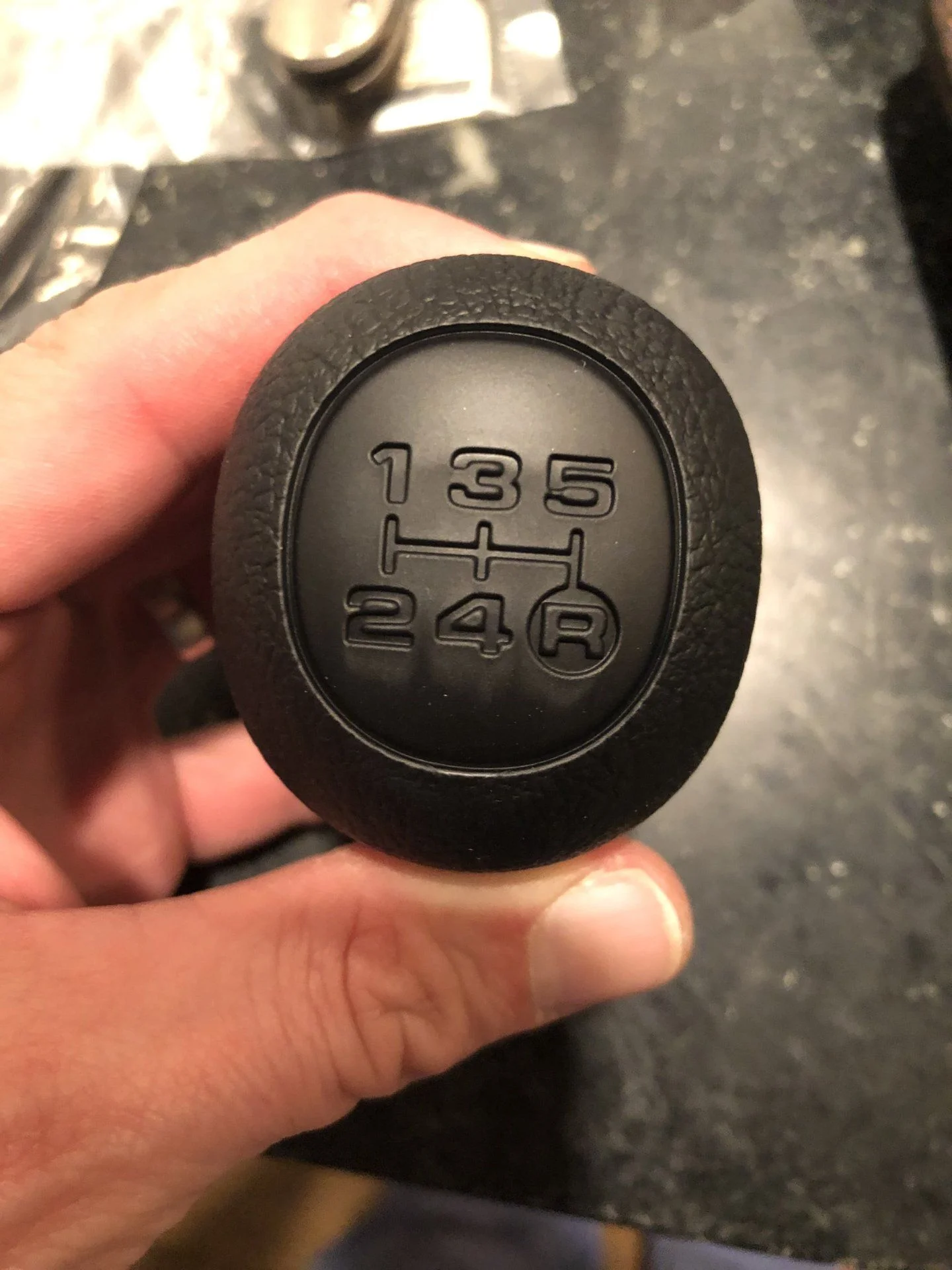

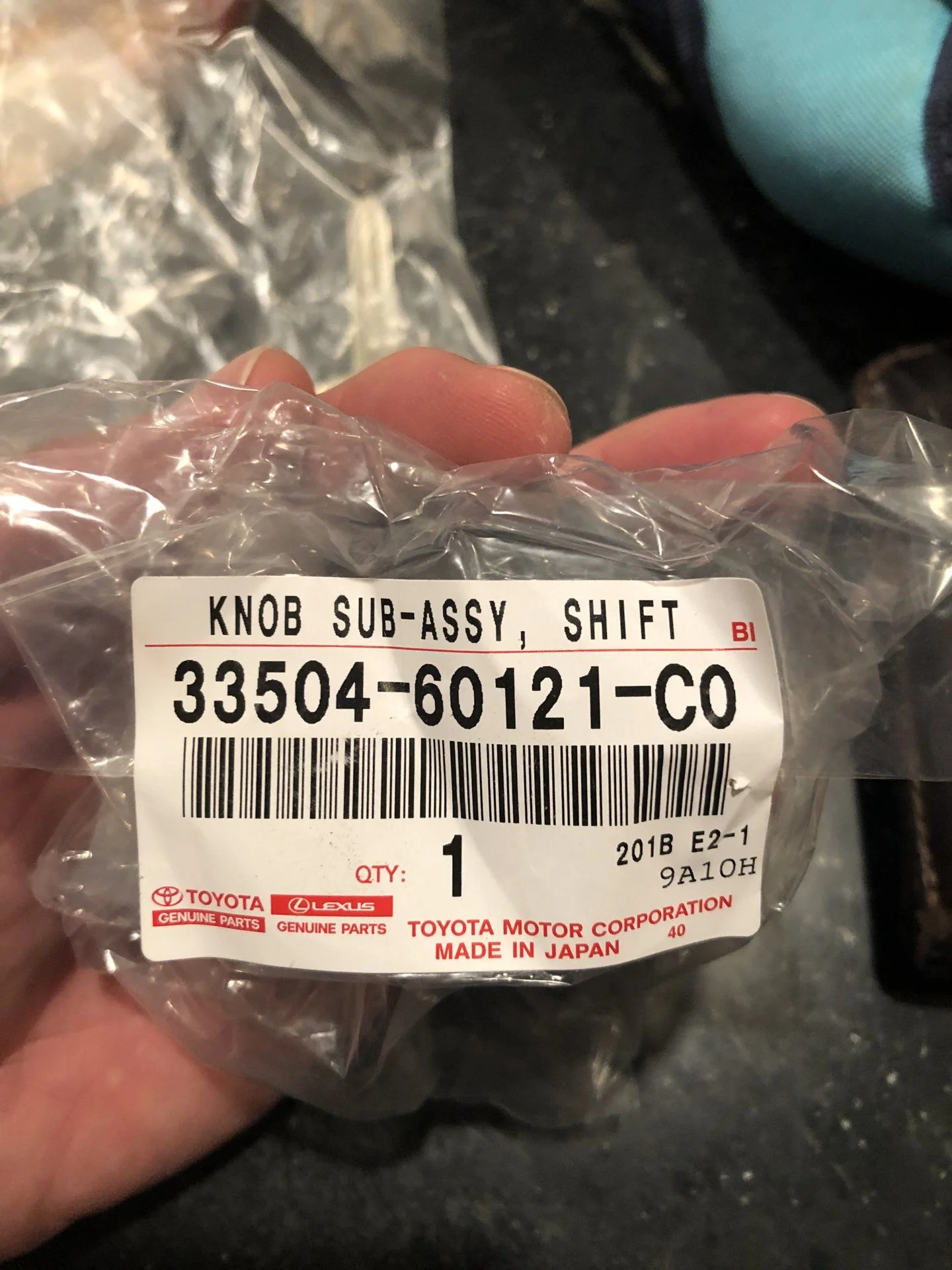

Correct 80 series shift knob. The shape is the same as the early 60/current 70 series knob, but this one weighs a TON. Seriously. Why is it so heavy?

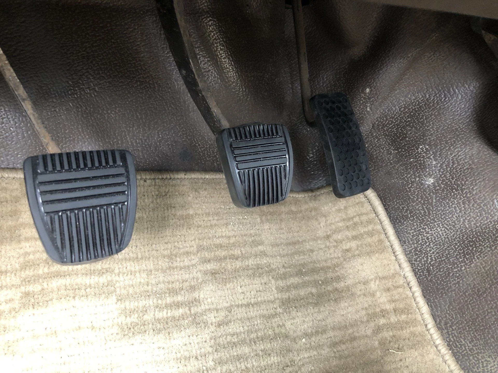

Throttle pedal pad:
