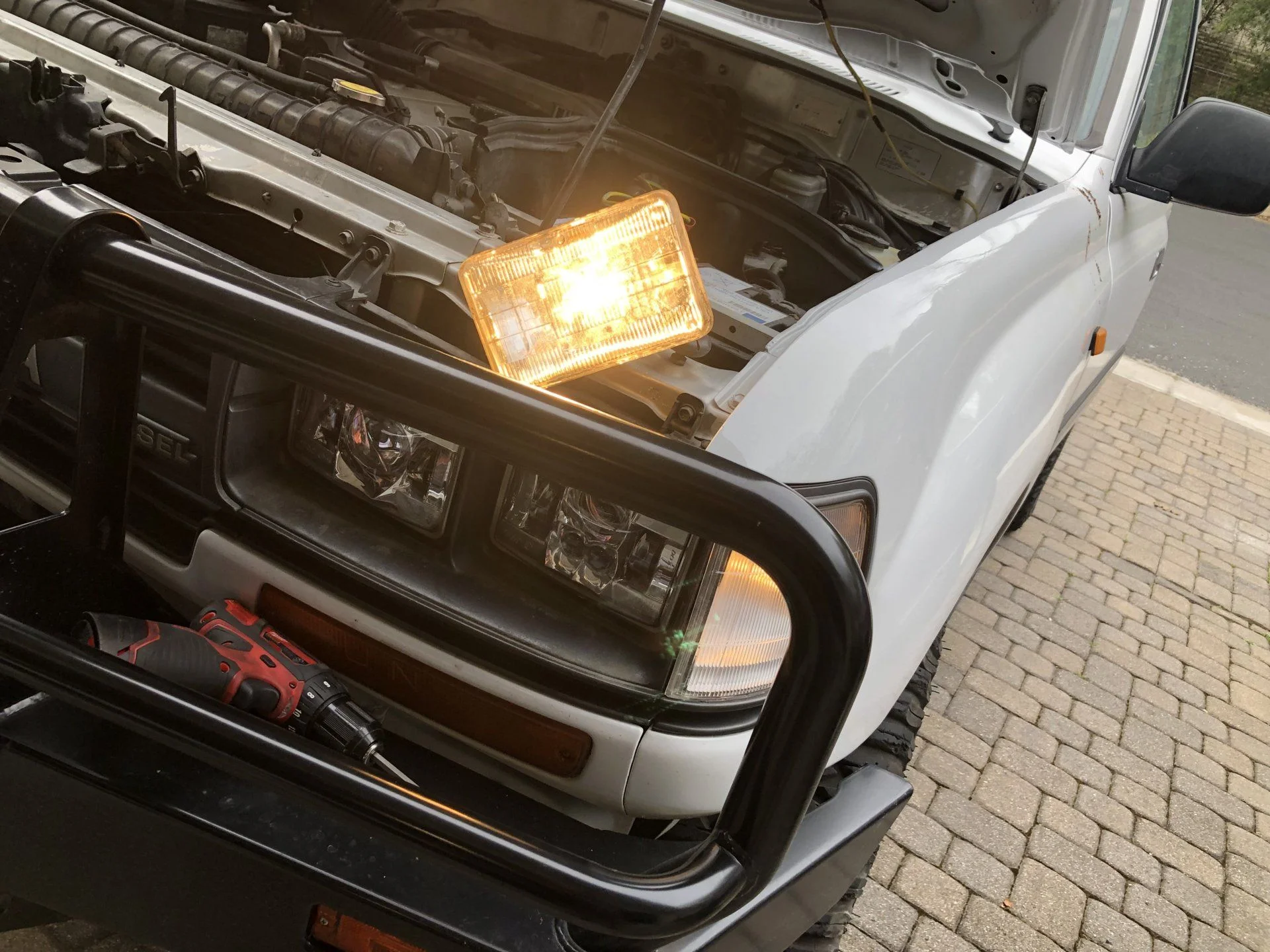

High beam indicator must be dependent on a certain amount of load. Kinda like the blinkers.
If the high beam circuit is the same for the 80 as the 62 series (which it appears to be), load is accommodated for by resistor choice. I used a 10ohm/25W resistor which is a good middle-of-the-road choice by my calculations. My high beam switch works just fine with this exact setup in my 62.
Maybe today I will have enough time to pull the LEDs and plug the original sealed beam headlights back in to see if my highbeam indicator even works to begin with.
High beam indicator: nope
I pulled off the LEDs from the high and low on one side and plugged the sealed high beam back in. Nothing on the dash.
I’m pretty sure my bulb is just burned out.

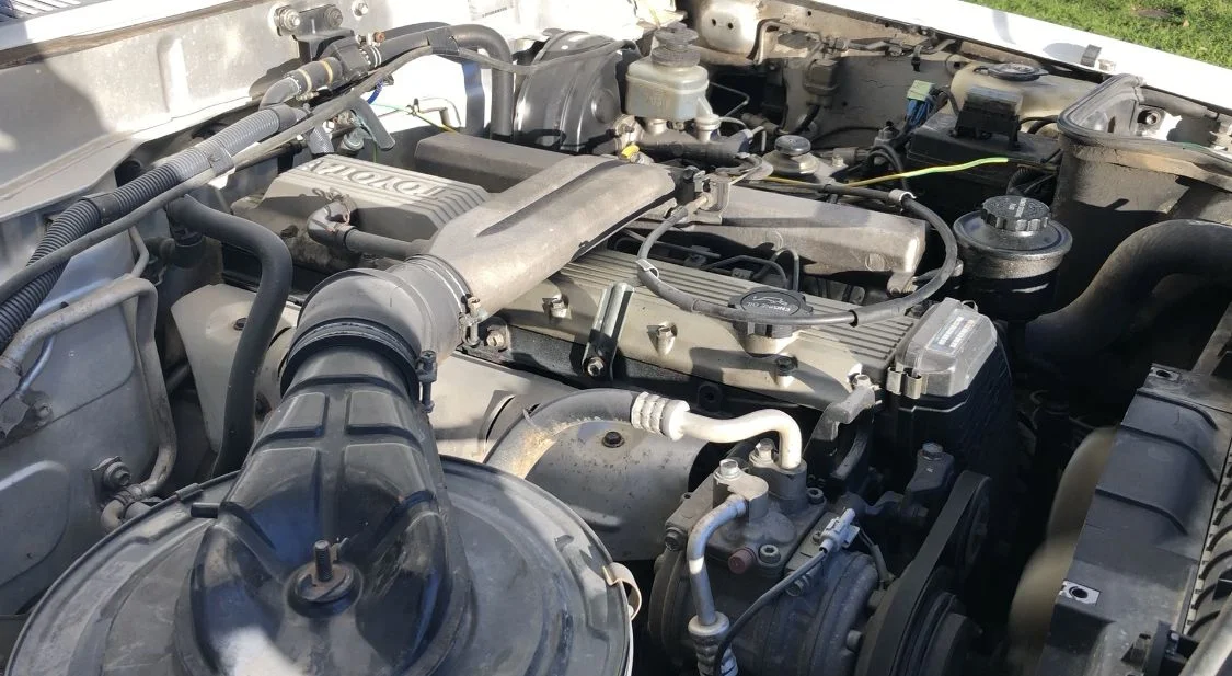

Please post pics of the engine, interior, and back. Thanks!
Engine bay for starters:

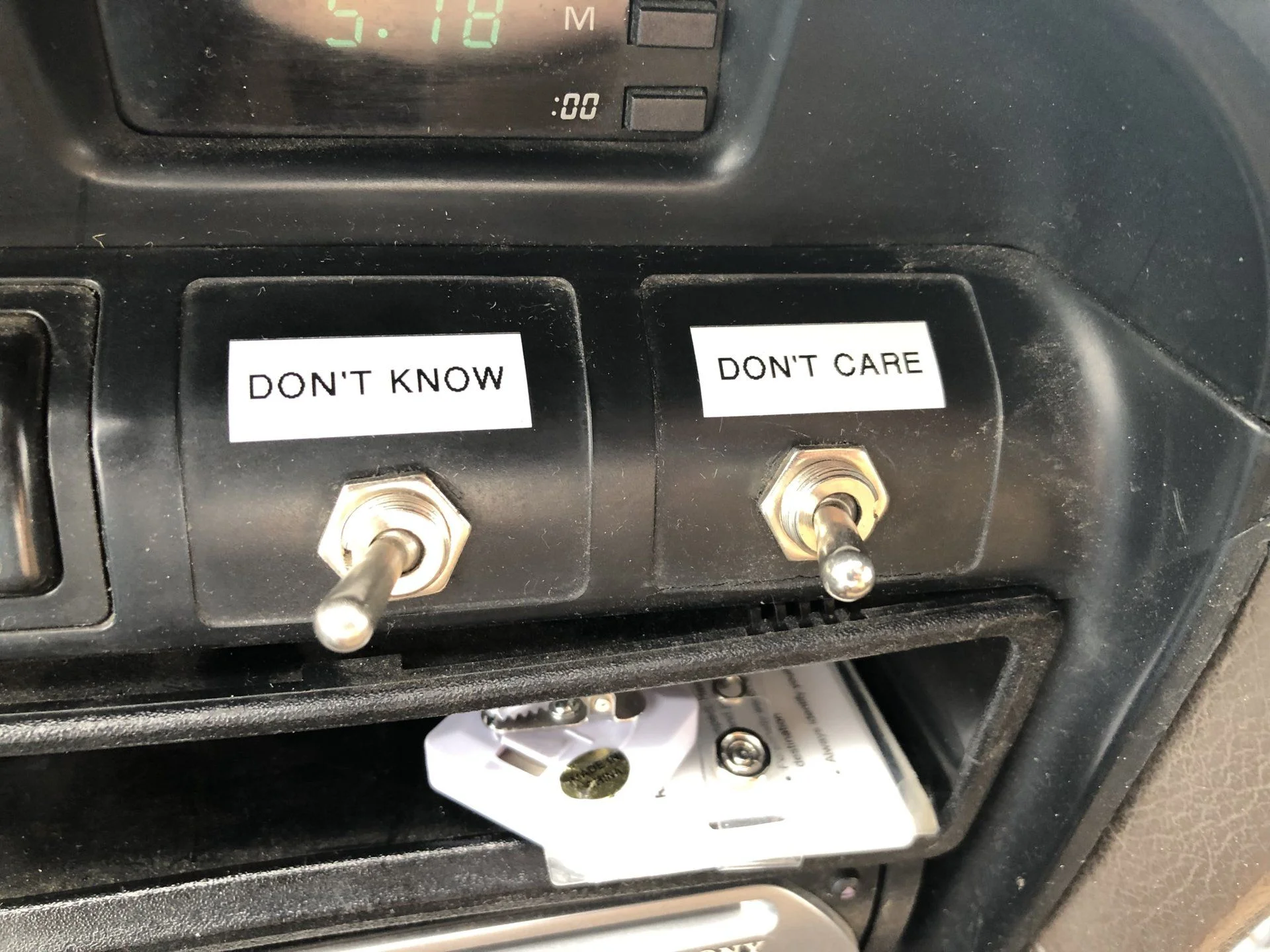

I relabeled some switches today.
Stickers. Which is really important.

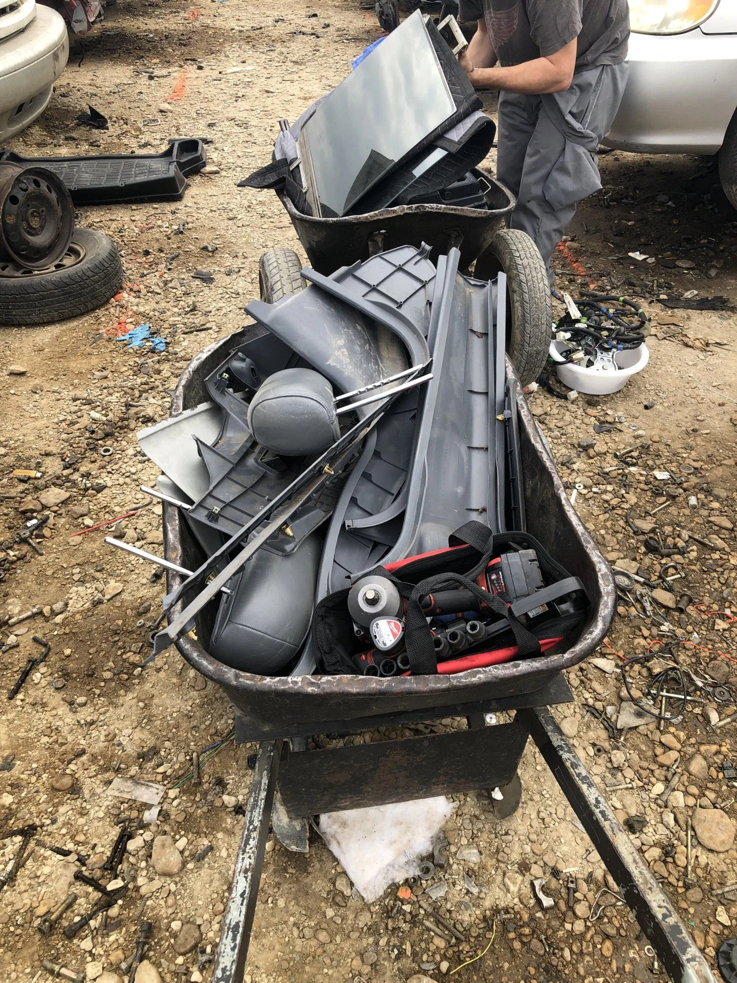

@teleskier found an 80 at the local pick n’ pull. I found quite a bit of gray trim, and have a lead on a gray dash. I think I would only need gray armrests and a few door latches to complete the entire swap.
