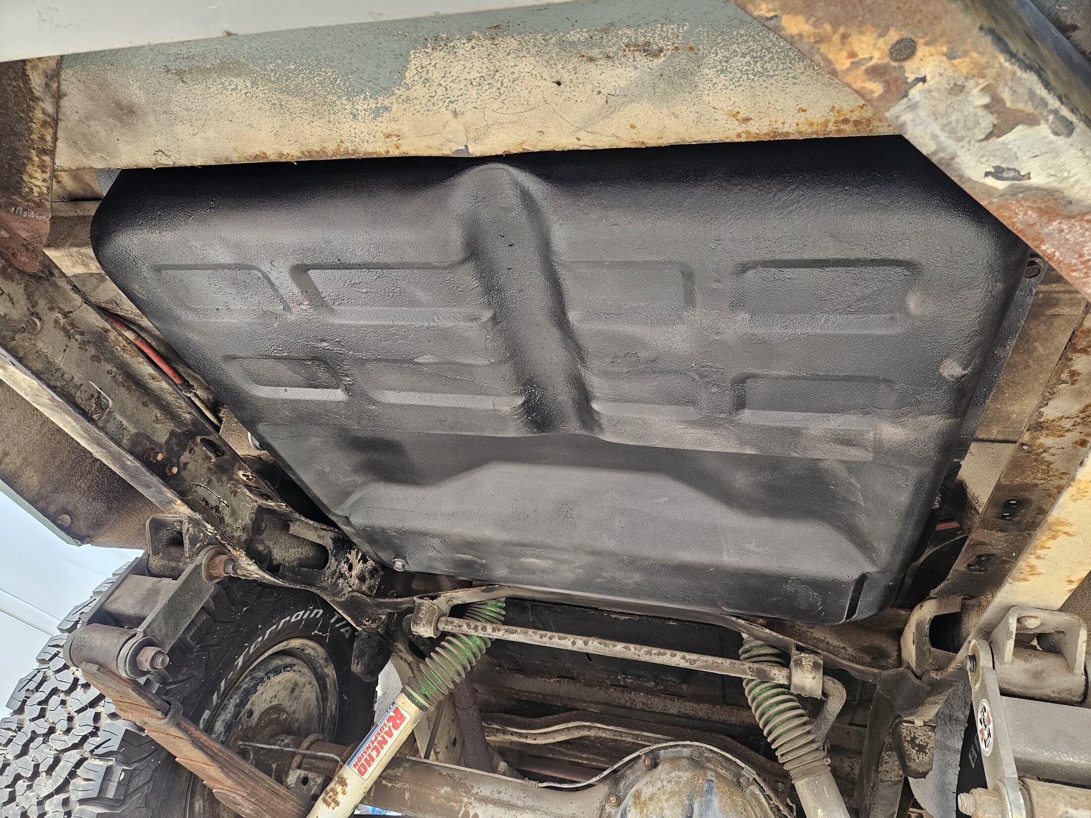

Fueltank is remounted. Fuel hose was too short and that 90 was a little much . Tomorrow is another day. Hope to finish up running the new fuel lines and hopefully have him running again by the end of the day.
Have to start fresh to stay fresh.
I like that!
I painted mine silver. I don't know if it makes a difference with temperatures, but I sure didn't want to make the fuel in the tank any hotter!

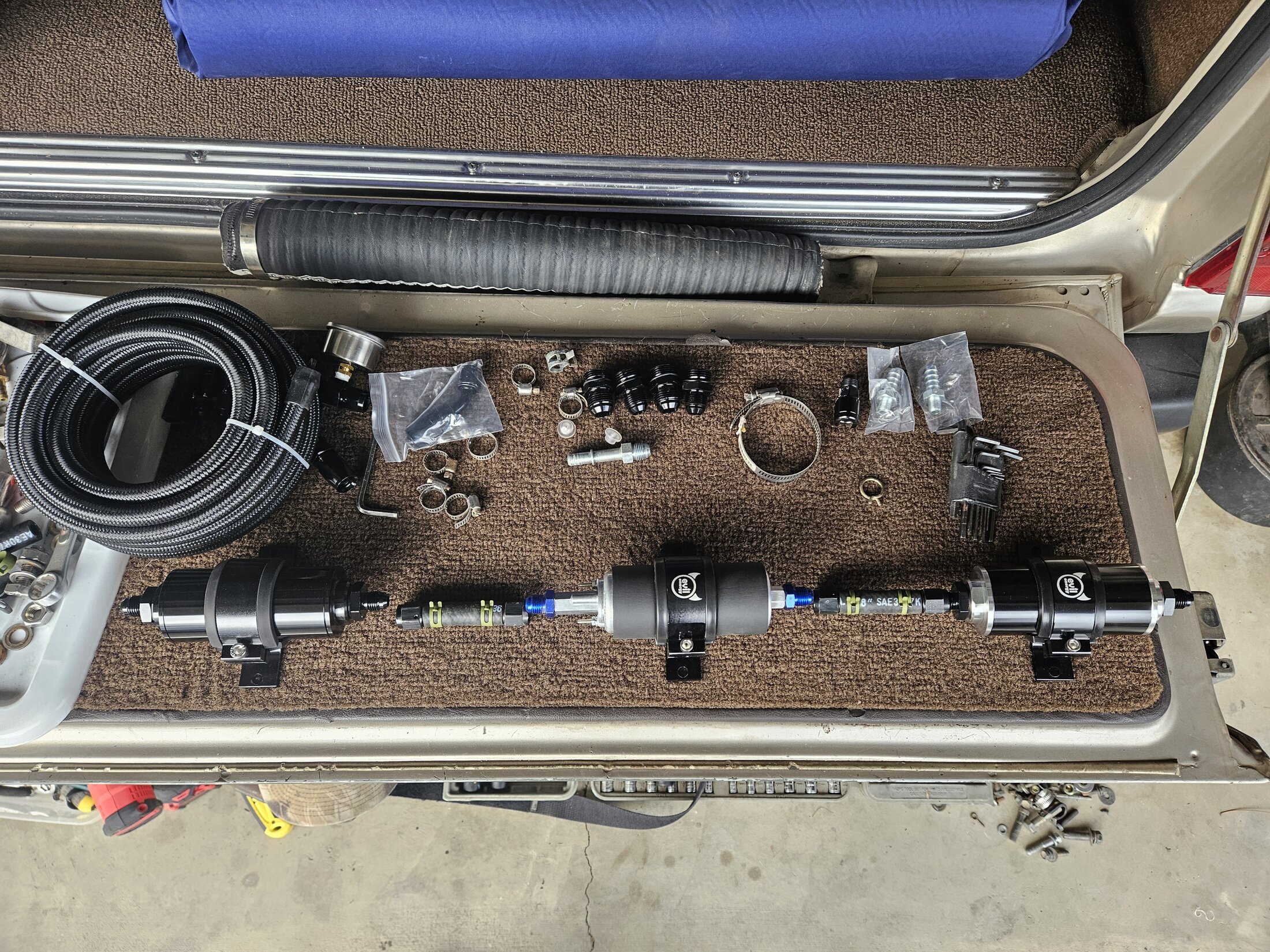

Am I seeing filter > pump > filter?
For a pre-filter (before da pump), I like to use those clear filters so you can see how much debris you are picking up.

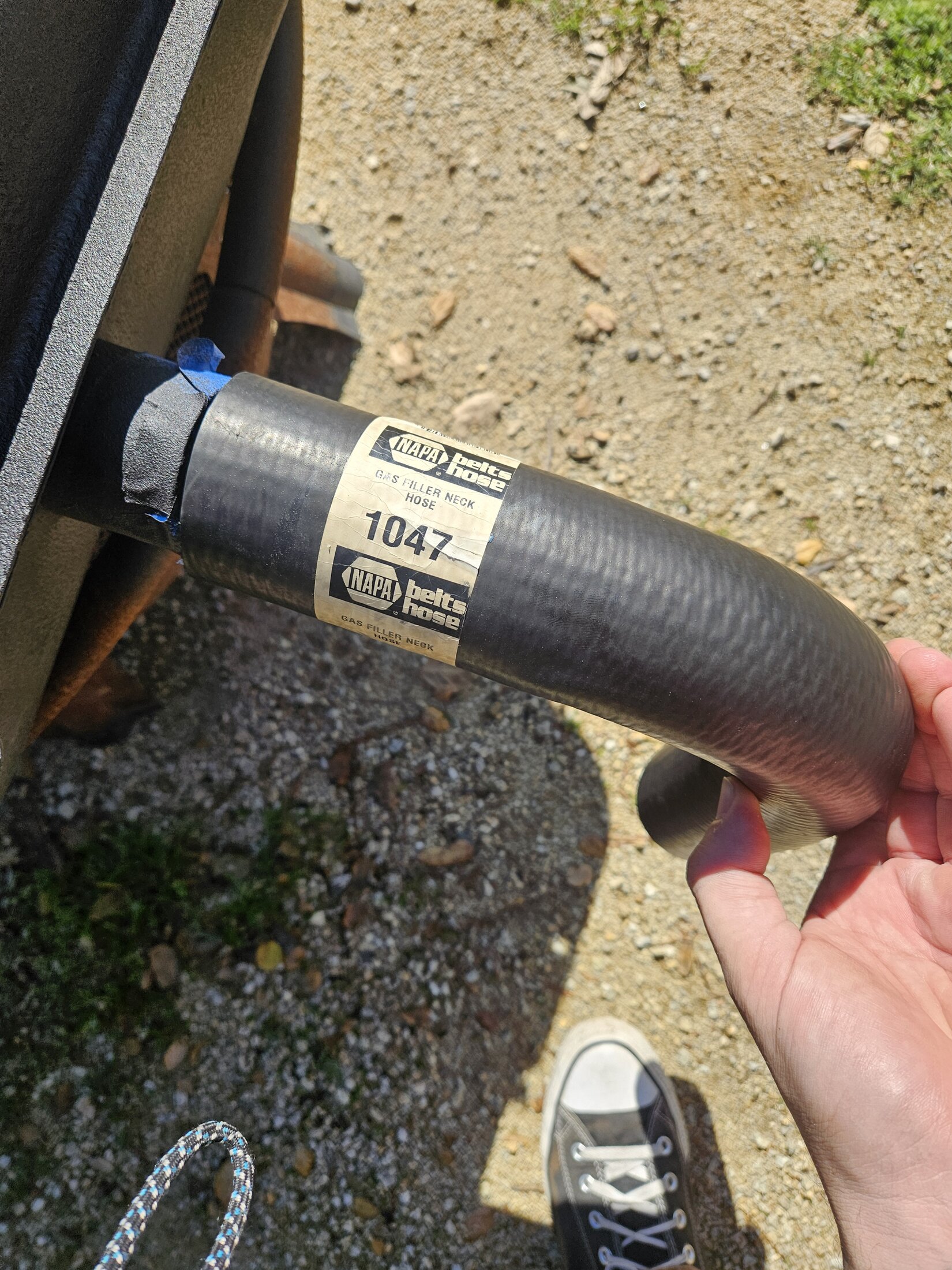

NAPA option ended up being to short and that 90° was too much. Should have got a 45°. I remember seeing your post about the filler neck. It's currently out of stock. I'm gonna look for another source.
Won't make any difference unless it gets direct sunlight.
Filler Neck Supply Co.
2”ID 90° Super Elbow
Well all the lines have been ran. The ignition coil pack took a s***. Picked up a new one and swapped it out. Almost started but the battery was low. Called it a day. So close. 😮‍💨 Pork Chapo will spend some time in the garage while he's being worked on. At least Brutus will get some love now. He's been parked in the garage since Pork Chapo was purchased.
