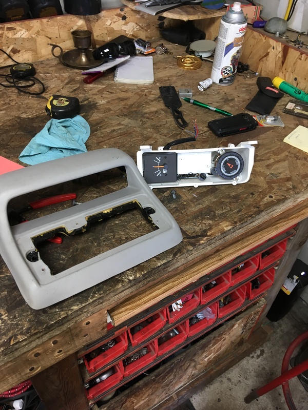

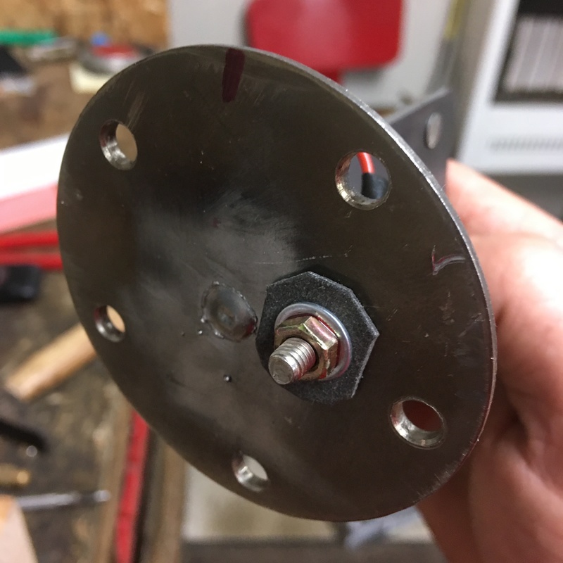

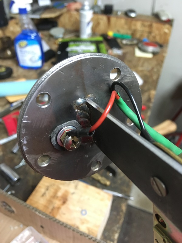

just installed sub tank gauge all is done now working on the float i got some idea how to do that problem is toyota gauge and isuzu sending unit ohms do not match and i can't use potentiometer to calibrate it because ohms rating is opposite of each unit so now i need to figure out how to use toyota sending unit inside isuzu tank
print screen
print screen
print screen
print screen
