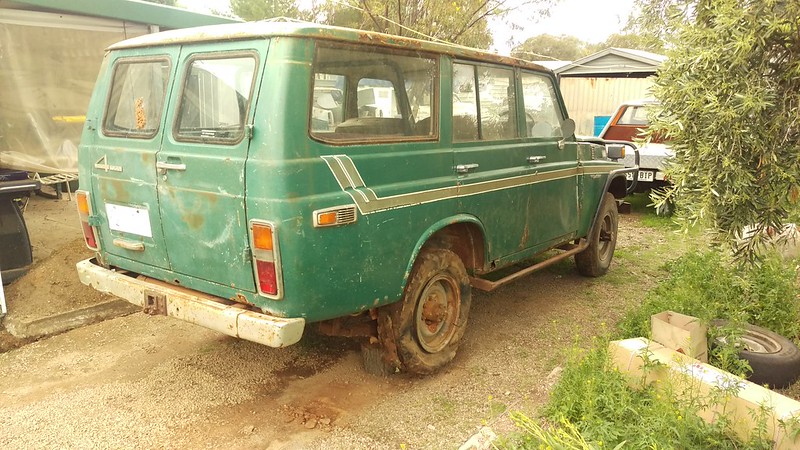

Now everyone that knows 55s knows they were all petrol from the factory, FJ models only. while that is true not every 55 was sold new as a petrol.

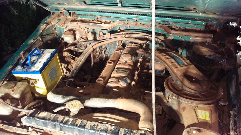

Here in Australia you could ask some dealers nicely and they'd get you a brand spanking new 55 and as soon as it hit the lot rip the F/2F out and slot in a Perkins 247 Deisel engine!
And here one is, a original Perkins powered pig in all its glory!!!

Plans are a resto staring with the rust, if you've seen my 60 thread i'm not scared of a bit haha.
my mate who is the owner (Im just the pig lover/fabricator/mud correspondent for the build) wants a stockish look but with some upgrades, and cool 80s style stuff like one of those exo-cage style roof racks and chunky tyres on the split rims.

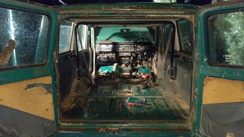

it even has aircon!! too bad it just blows dead rat smell currently

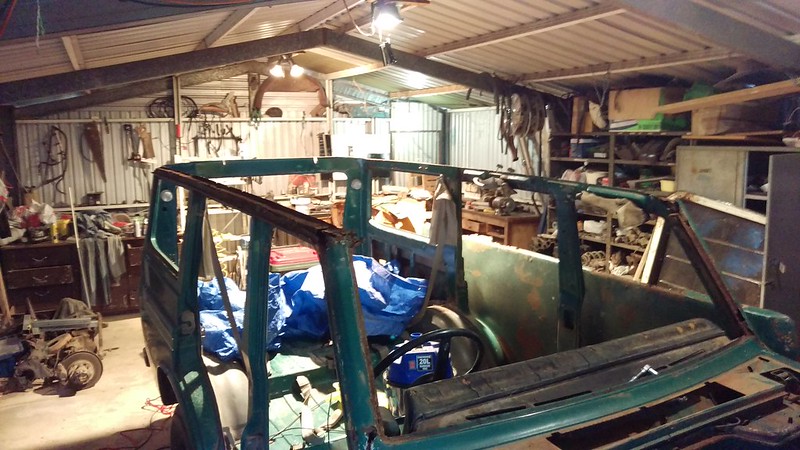

started the rust repairs, the roof skin was only attached by about a foot of sheet in total haha. have to take some measurements off the other pig to get the sides aligned again before i brace it. going to strip it all back, slice it open like the pork it is and get it blasted soon
