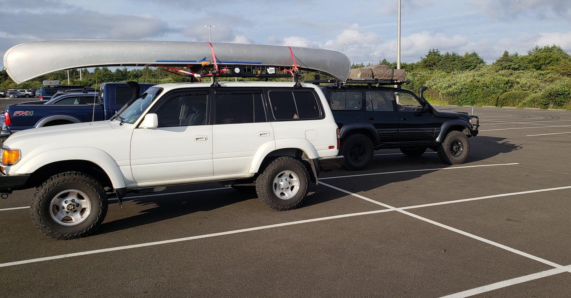

So 2500 miles later I'm getting about 11mpg on the highway up from 9mpg not figuring in oversize tires. Way easier steering and no more front driveline vibrations. I have added the arb deluxe bull bar and 9k winch. Right now I am making the olympic peninsula loop and getting about 9mpg loaded way down. I have wife and kids with all the necessary camping gear and clothes along with canoe on top.
