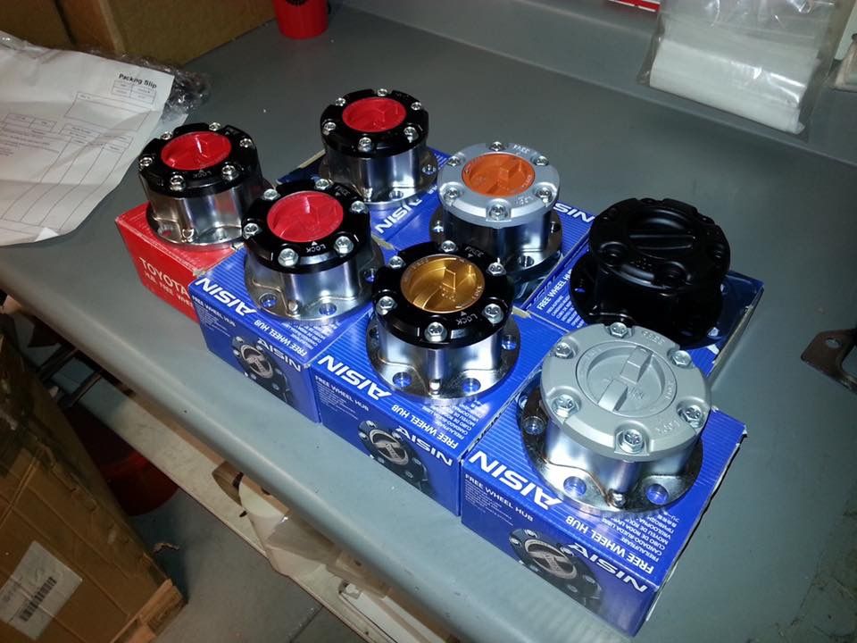

As noted any 79+ hub will fit. With a heavy 80 build I'd seriously consider and recommend a HD hub build, i.e. AISIN with HD internals such as our smooth bodies.
If black isn't your dial preference, we have other colors too!

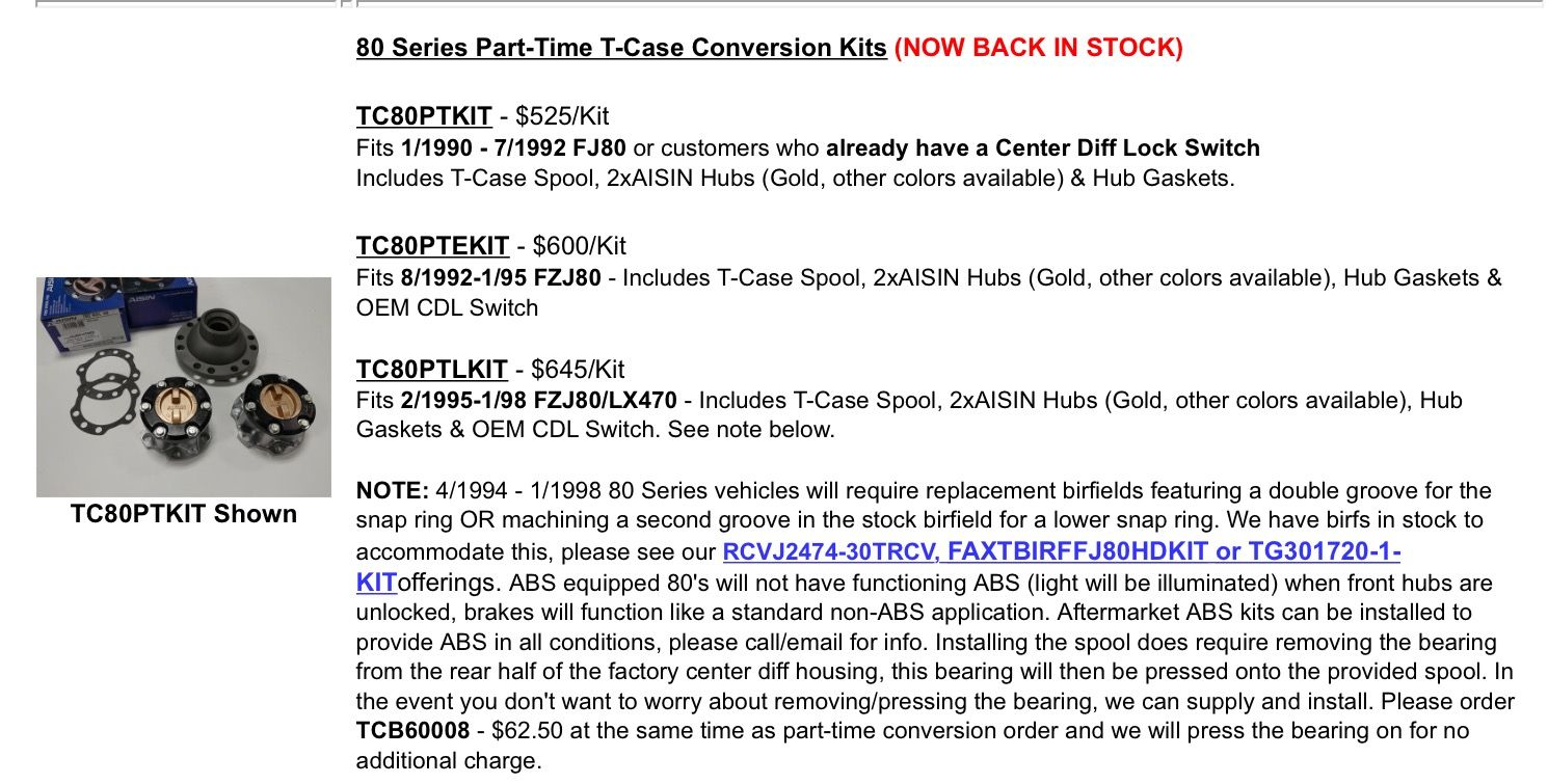

I was under the impression the spool replaced the transfer case diff simply locking it and spinning both drive shafts.
With the spool your front shaft won't be under power (spinning) until you engage the CDL button, it now becomes your 4WD button.

I will be doing this one of these days, but I am not really interested in replacing the front axle's. Do the instructions have the spec to get the second groove machined?
