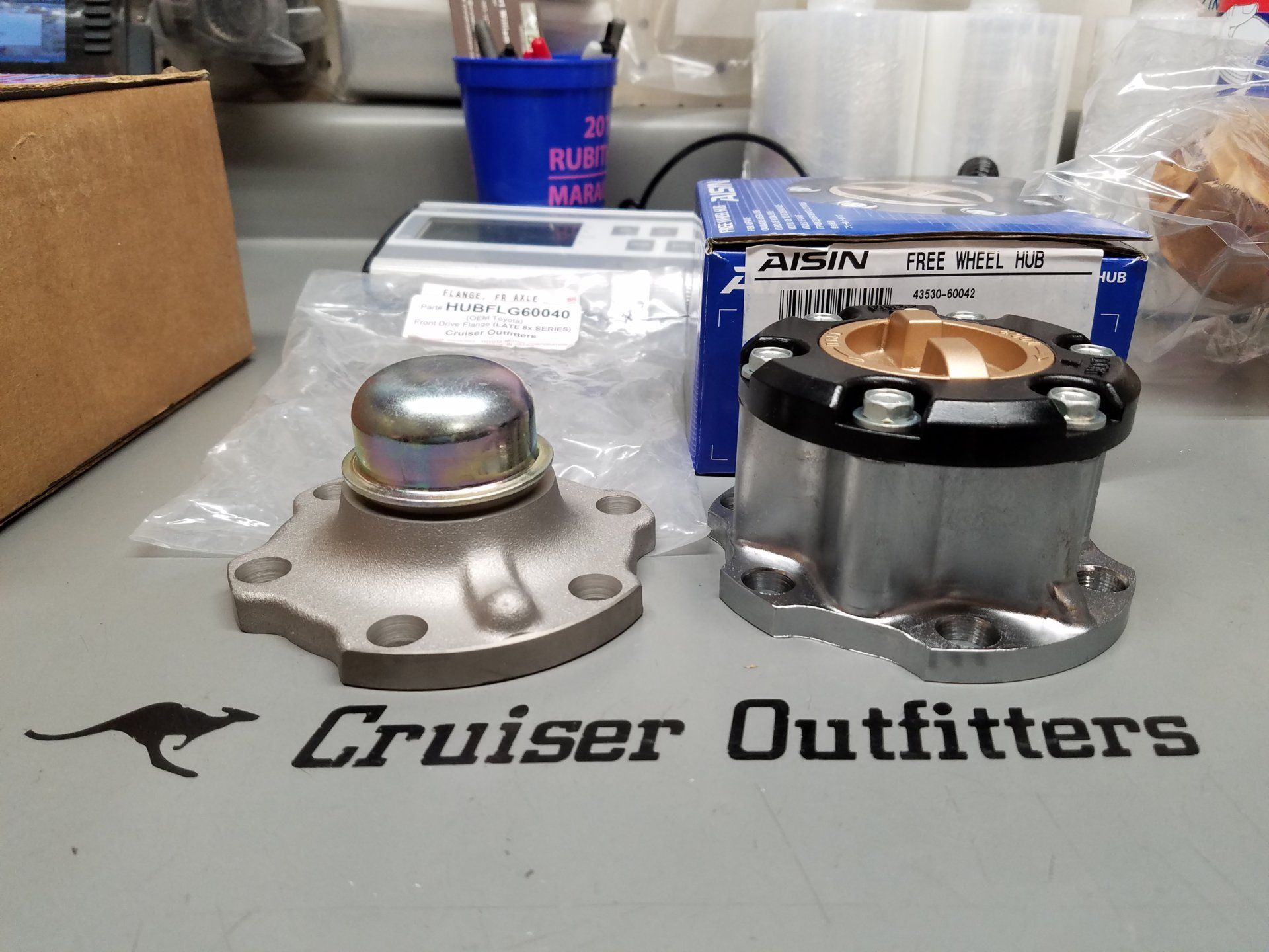

I spoke to Bryce several weeks ago, and I am definitely looking to go this route when I start rebuilding the locked axles I picked up. Out of curiosity, do these hubs stick out any further than the usual '97 hubs or are they virtually the same?

The AISIN hubs are certainly taller than a drive flange. Just for you :D
(I didn't tap that cap all the way down but you can see the hub is taller)
Thanks for getting back so quickly. That's perfect as the center of my wheel is pretty deep and the further out the better.
