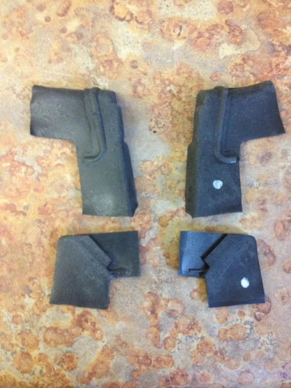

front door corner seals on 1978 hardtop?
65888-90302
65889-90302
65898-90301
65899-90301
Toyota dealer is telling me the 65898-90301 & 65899-90301 are discontinued.
Those are the little weatherstrip pieces in the rear corner of the door opening.
I just ordered the pieces for the frt corners, we'll see if they actually arrive.

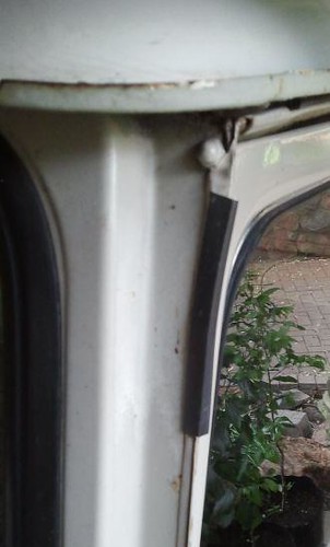

'77 fj40 Australian import: Anyone have these on the upper edge of the windshield frame - I have one either side. Don't seem to be on the parts list anywhere......:hhmm:
Jim, I see absolutely no apparent reason for these....interestingly enough they are the exact same profile of the OEM one on the back tailgate hinge. It's a mystery to me :confused:

Designator (first 5 dgits) ending in even numbers are right side. First five ending in odd is LH.
65888-90302 & 65898‑90301 are for the RH door.
65889‑90302 & 65899‑90301 are for LH side.
