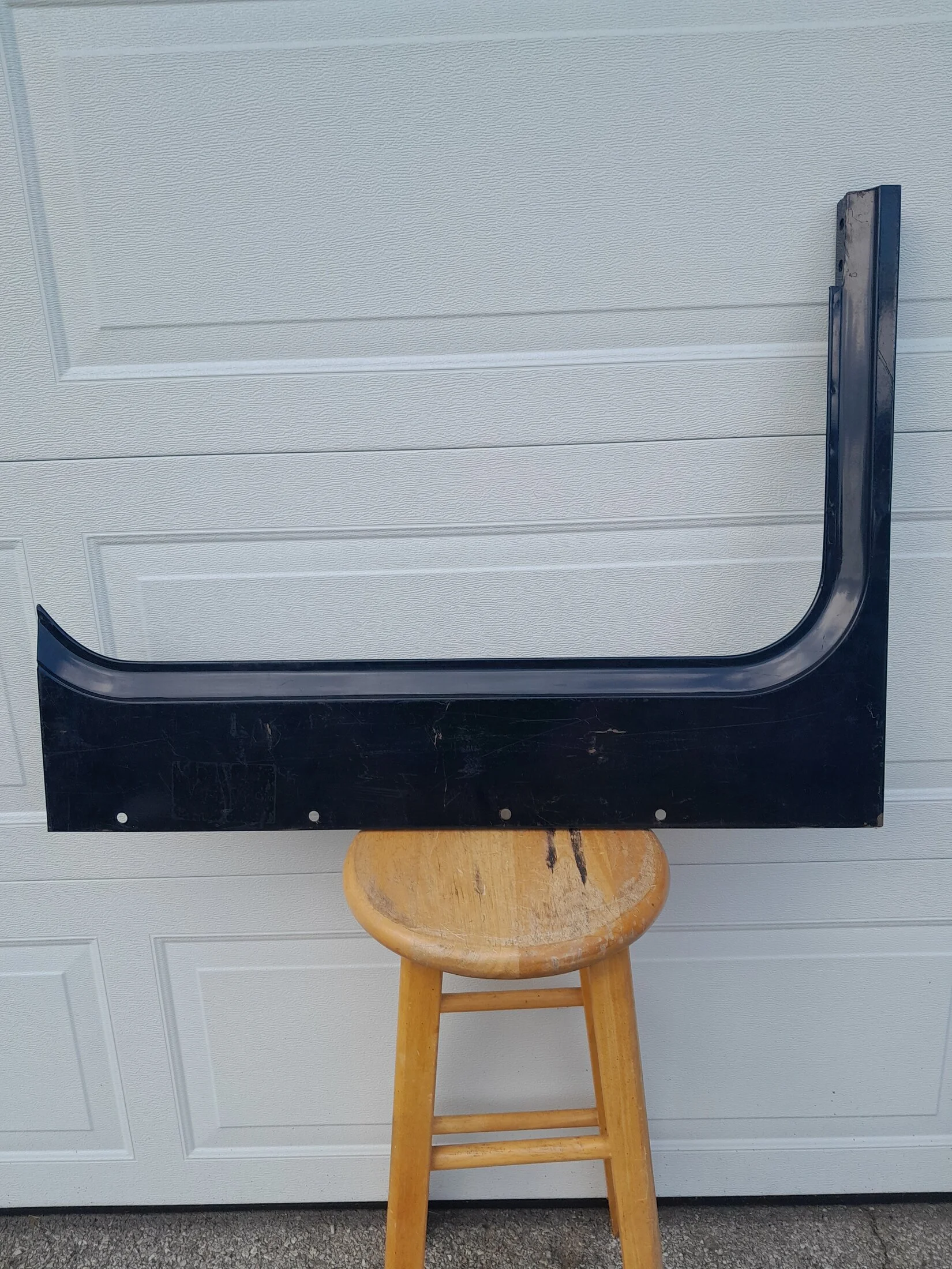

Mark @65swb45. I see a 9/75-6/78 rocker. Then a 6/78-1/79. My 10/75 does not have the three holes. But this 11/78 cowl I have does. So my guess is these started 6/78. Here is the 11/78 cowl.
Going from memory (scary) but believe this is a 11/78. Toyota latest upgrade of diagram only shows a complete part number and three per side. No information on dates they were used. Sure others have better access to parts system. My is assuming the 6/78 change was for the plugs.
