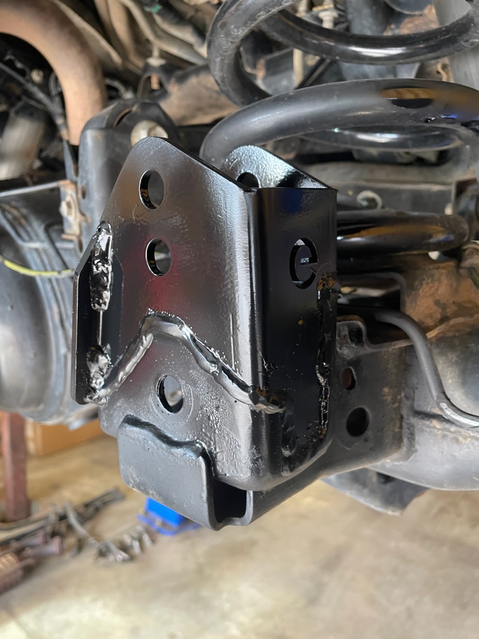

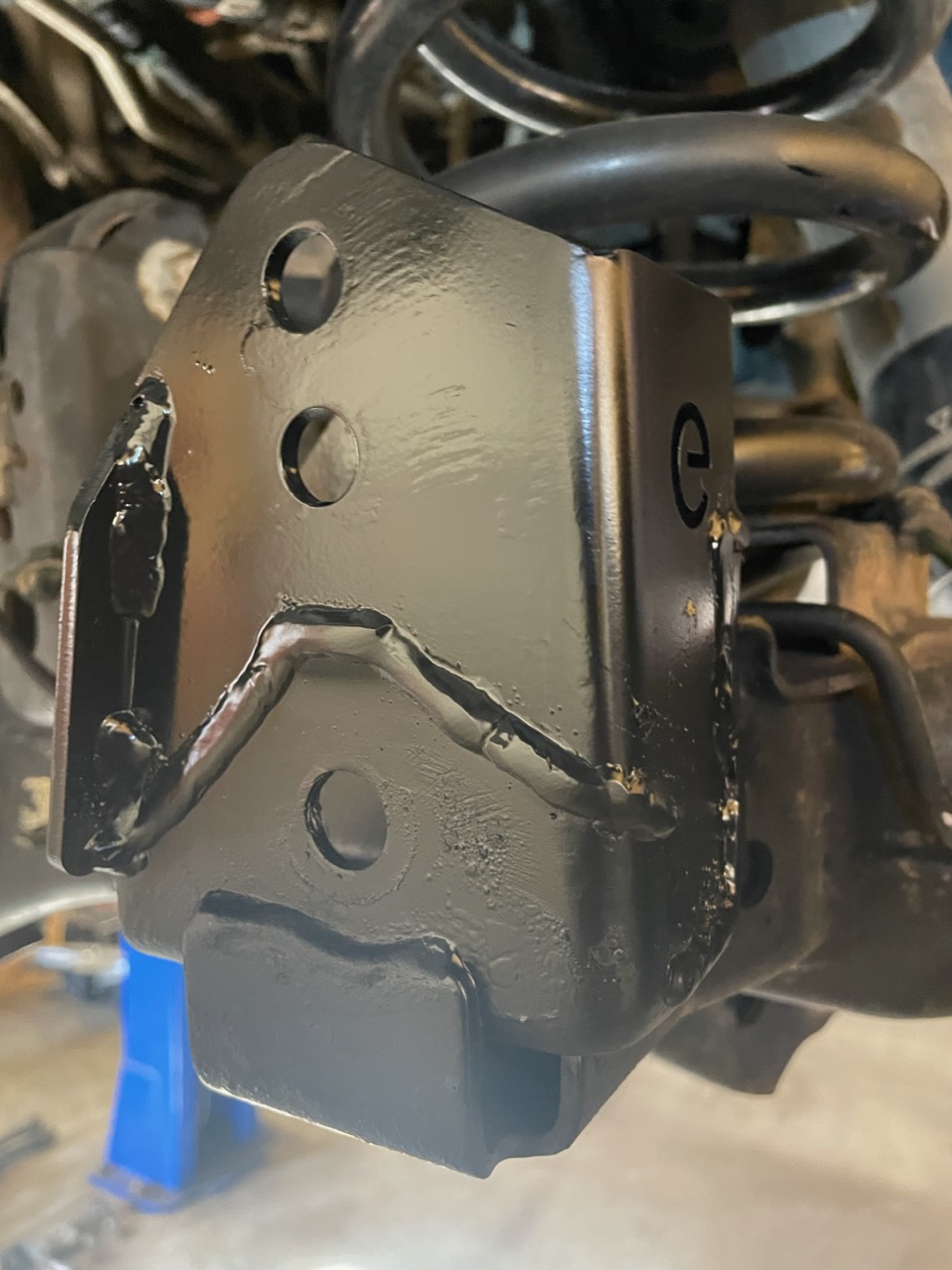

having trouble with multi-quote this morning! - Where are you guys having to grind it? (and what years are your trucks? - might be able to identify the difference between the truck I tested on and tweak it a bit)
Had to knock the little curved point off the driver side vehicle front and quite a bit on the passenger side tab that goes into the OEM bracket “slot”.
Edit: 2013 MY

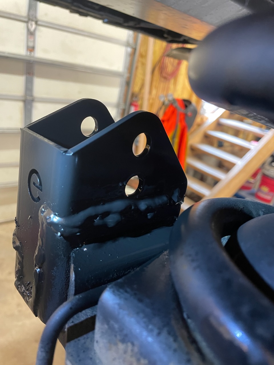

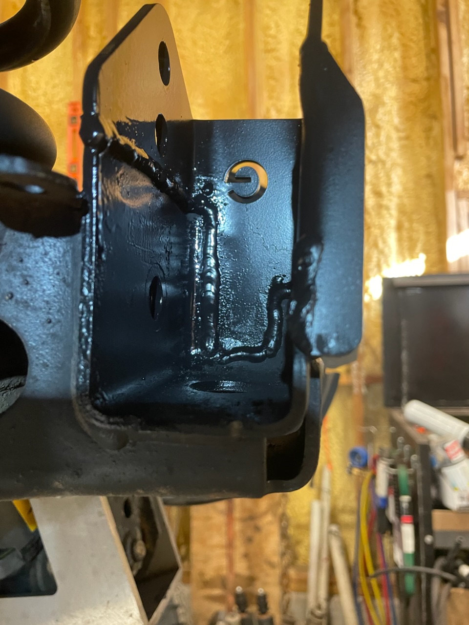

Great pics! I was wondering about the backside access and was thinking spring removal would be the best. Is it possible to weld the inside of the bracket?
You can definitely access most of the inside. I felt I had enough penetration on the outside weld so I didn't weld up the inside. If for some reason you were ever going to use the factory panhard bolt hole, you would probably have to knock the bead down a bit there.
I don't think I would worry about it. If you are welding this on, you likely have an angle grinder already handy. Took all of 3 minutes to get it to drop in. Mine is a 2019.
Same for me

Got the bracket installed today:
Took it for a drive on freeway and it makes a big difference No more butt wiggle on high speed bumps.

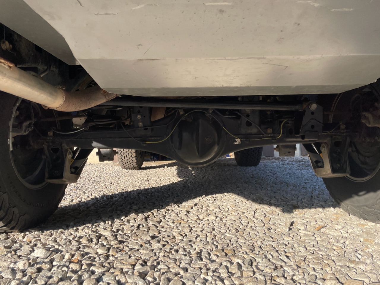

Panhard orientation looks perfect.

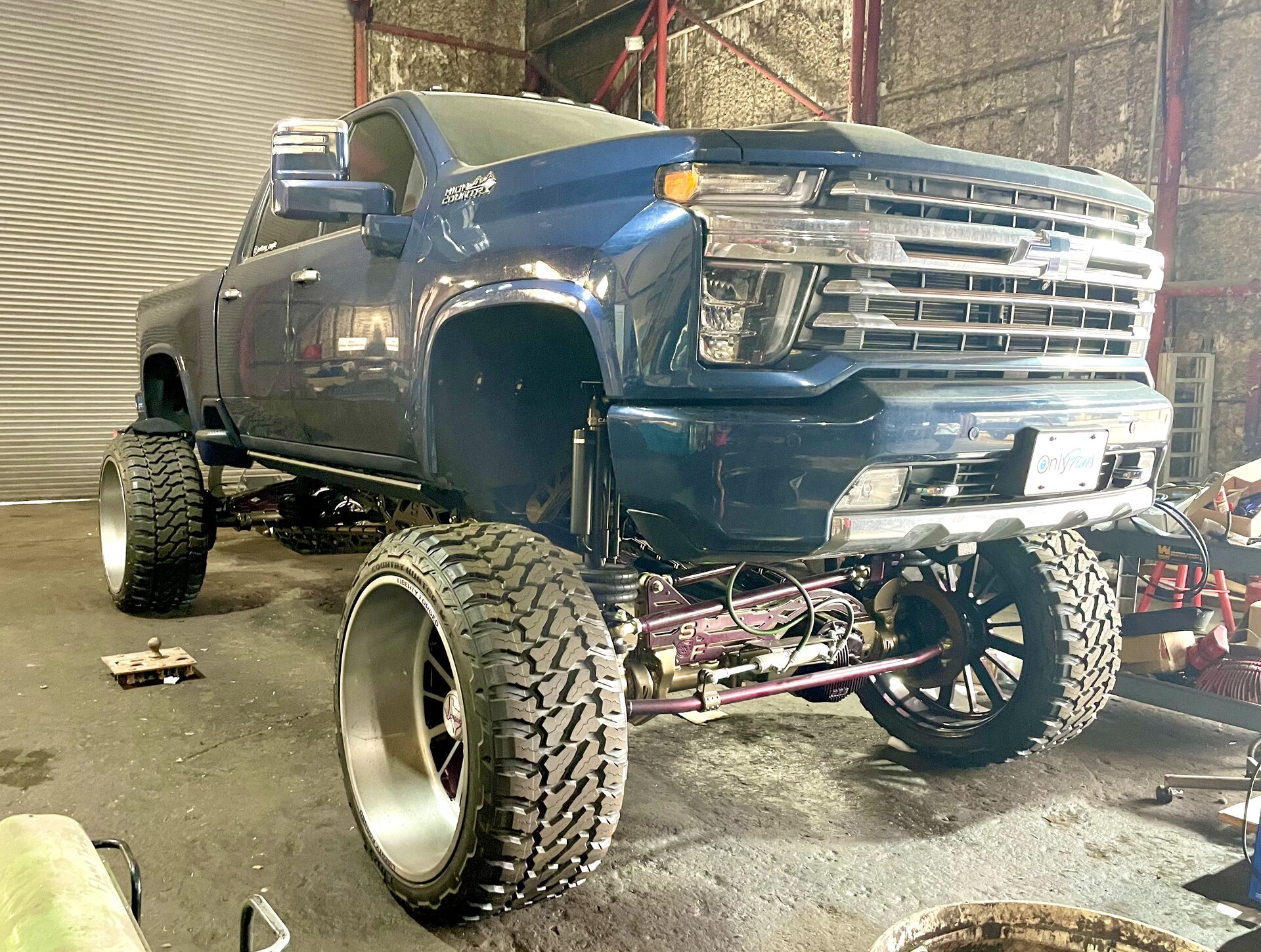

I have a guy, he builds wild stuff, should be able to knock them all out at same time.
This kind of wild stuff. As you’ll notice that was a brand new IFS truck originally lol.
