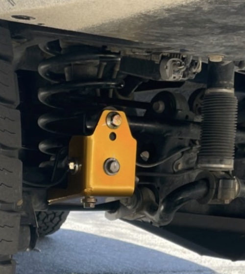

Finally had the chance to put some mileage on the LC200 with this installed, to include freeway driving with some heavy braking. The tail wagging is significantly reduced, back to how I remember it being as stock.
I concur, made a run hauling my 14' cargo trailer with my kids 73 Super Glide, all wiggle is gone. Nice and smoooth. Thanks @eimkeith. Mitch

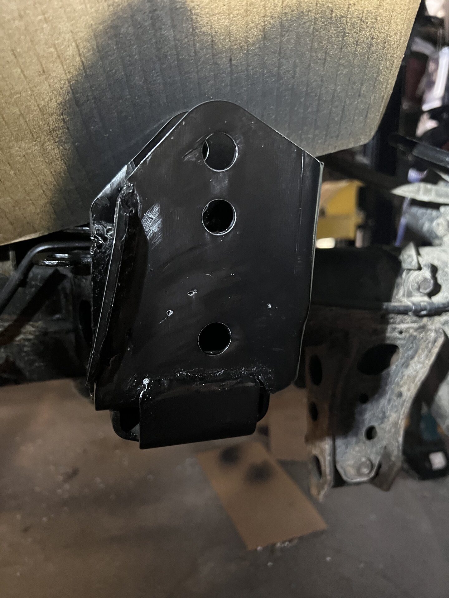

About to start hot metal glue gunning mine on. :) Did you all remove the panhard while you were welding or just push it out of the way? How did you protect the line that runs right behind it (sensor wire?) while you were burning stuff?
I did not remove the panhard. It was not in the way. For the ABS line, I did disconnect it from the sensor on the hub and made sure it was pretty far away from any heat source.

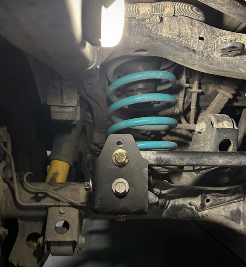

I followed your guidance and did the same. I should have removed the spring, it would have given me better access, but I'm happy with how it turned out. Not nearly as nice welding as yours and others, but grinder, flap disk and rustoleum and nobody's the wiser. :)
That brake line is awfully close and the coating got more than a little warm at one point.
And yes, I know I could have done a better job, but it is what it is. Hopefully it won't rip off. My welding is decades out of top form and doing it at 2AM didn't do me any favors.
Looks good to me! That will hold. Many of the factory Toyota welds are not instagram perfect (which mine are far from too). The photo I posted may have been a bit deceiving, I did have the rear spring removed prior to welding. And yes that hard brake line got a little toasty. I probably boiled some DOT 3 fluid for a few seconds.
