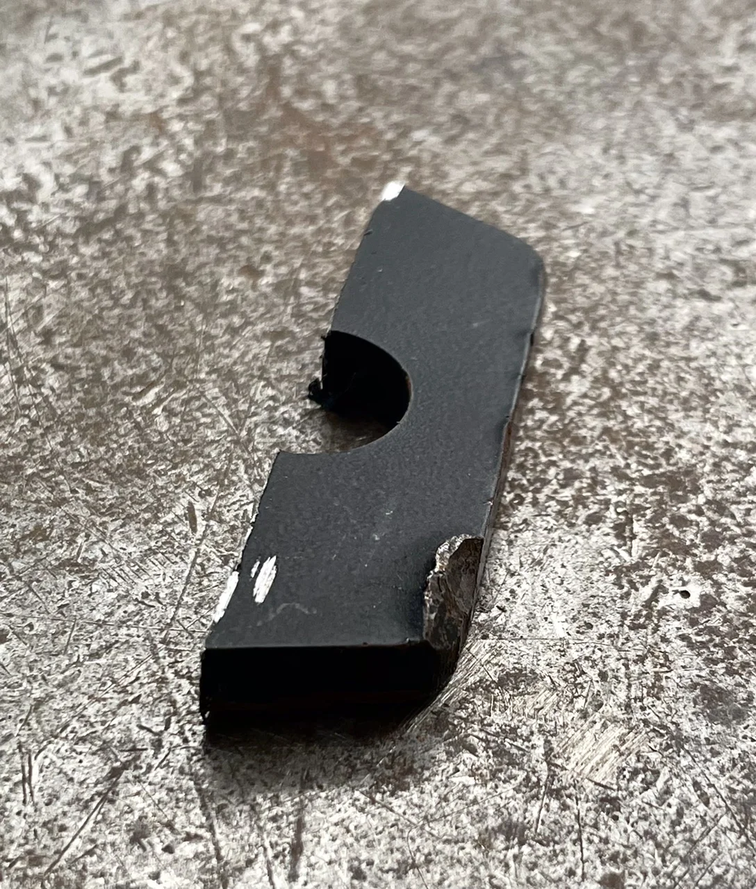

The top of the bracket will contact the frame at full bump stop compression. I had the same issue, even with active bump stops, and more or less did the same thing with an angle grinder. It’s not a lot of contact but any bracket-to-frame contact seriously concerns me, either in damaging the frame or more likely causing damage to the bracket mount which might cause it to loosen over time or possible even shear a mounting bolt

Yeah the short one is probably fine. Even the tall one seems like it only makes a tiny bit of contact, but still any contact seems like the kind of thing that could shear a bolt
Ive had even the shorty bracket contact the frame under full compression with factory rear bump stops.
That’s disappointing to hear, obviously the bracket just doesn’t work with the OE suspension travel and geometry, it simply only corrects the panhard geometry for lift, and the benefits are not really compelling I don’t feel.

Oh yeah, it’s a very solid metallic clunk! With the rear Kaymar, wheel carrier, double jerry holder and 170L (45 gallon) LR tank there’s plenty of momentum to stop, and this bracket smacking the chassis isn’t the place!
Pic below showing the piece I cut off and the point of contact!
Given the point of contact it seems like the bracket design should be changed to notch that corner at least.
